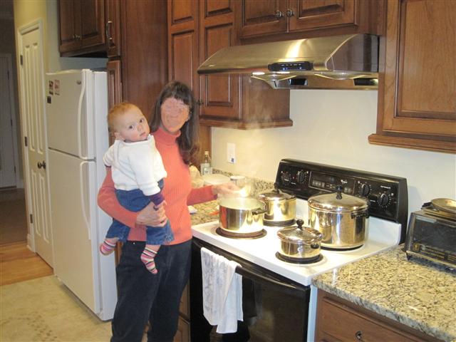

I am attaching a couple of photos of my kitchen. Notice how you don't see the side of the fridge (counter side), and while I didn't shoot the angle very well for this, you can see the filler on the left of the fridge (hope it makes my previous explanation easier to understand). The first has my upper lights off, the second has them on...lower lights on for both shots.
Looks good! I did almost the identical thing in my kitchen when I replaced my old fridge.
