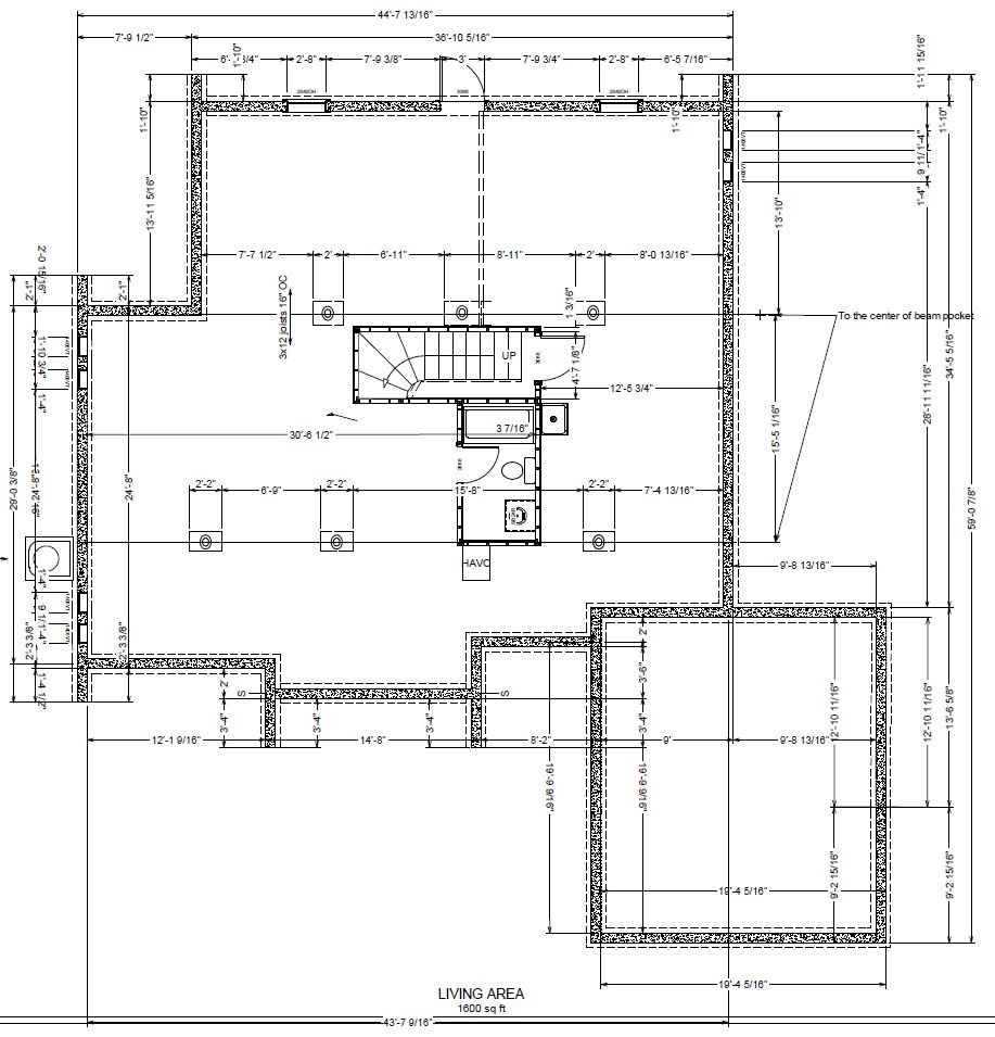

I know this post has been some time ago, but I went back and looked at your walkout floor-plan and noticed you'd eliminated two small vertical narrow windows on one side of the basement and put in a single wider window on the opposite side. Also, what was a terrace in the plans, you are calling a deck. That must mean that the deck will wrap around that wall. If so, you'll have some room below the deck to put in a small retainer wall from the walkout face all the way to the back side of the window if the grade doesn't hold.
Is it my imagination that the SW wall segments in the basement have window frames for the vertical slot windows? It looks like they just left the framing in place and poured the outside wall over the structure for the original windows. Am I seeing things?

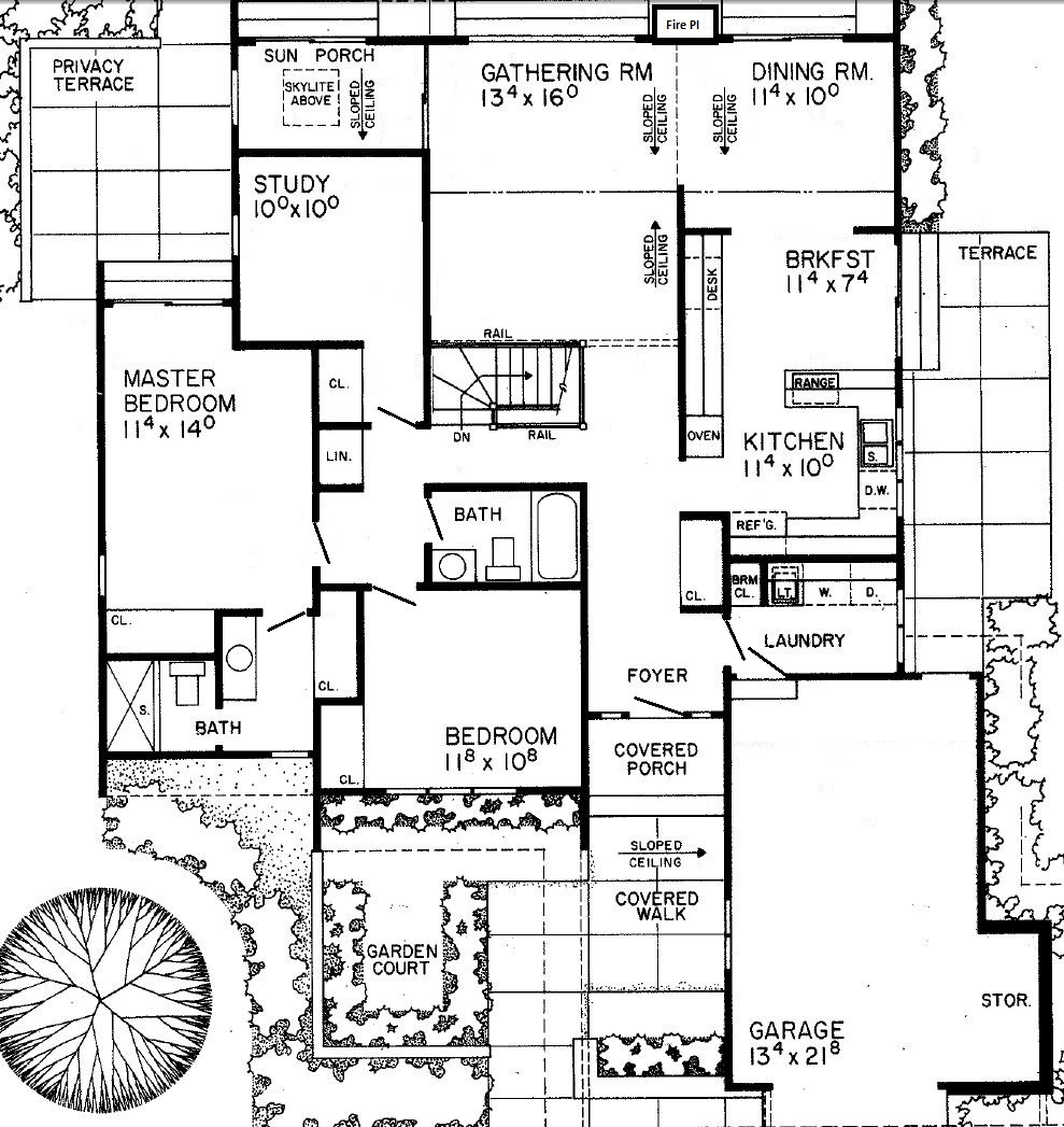

No Ron, you are wrong. ALL the walls are SW walls ((Superior Walls). Gotcha!!!:laughing: Look at the original basement plan to see the narrow windows which have been eliminated and replaced with a larger window on the opposite wall. (see below)
According to this floor plan below, that is supposed to be a privacy terrace off the Master Bedroom and a Study. I was wondering if that terrace has been changed to a deck. A deck would have an open space below, whereas the terrace would require solid fill or a supported foundation. I'm trying to think in 3D and type at the same time, so there might be something I've missed.:confused2:
Jim,
I rather think that Pete was presenting the 2 drawings that you are referring to as Conceptual at the time rather than the
finished layout of the home. You can see by the finished locations of the basement windows and door that the plan was modified
to fit the topography of the building site. Even the floor plan of the main floor (your second drawing) has been modified considerably.
He has used that floor plan for years to illustrate various points, even in his own home, which is not like this floor plan.
In regard to your statement about the wall pours and window templates, it is my understanding from the descriptions given on the net
that the walls are poured with the components in place but laying flat, which makes sense on prefab walls like these. The foam board
is on top of the stud and reinforcing components, any doors, windows, ledges, etc are formed in, and then the 1.5 inch thick concrete is poured on top of the foam. In some cases the foam becomes bowed in a little between the stud columns but that just adds to the 1.5" thickness in that area.
