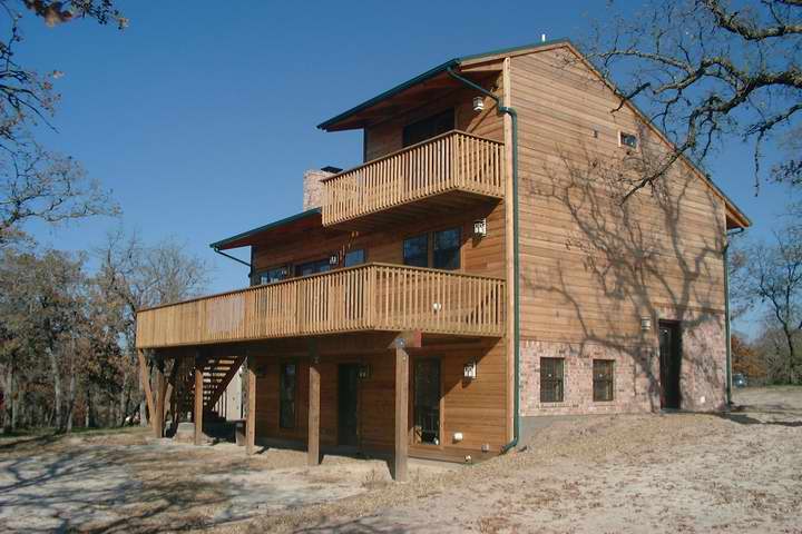

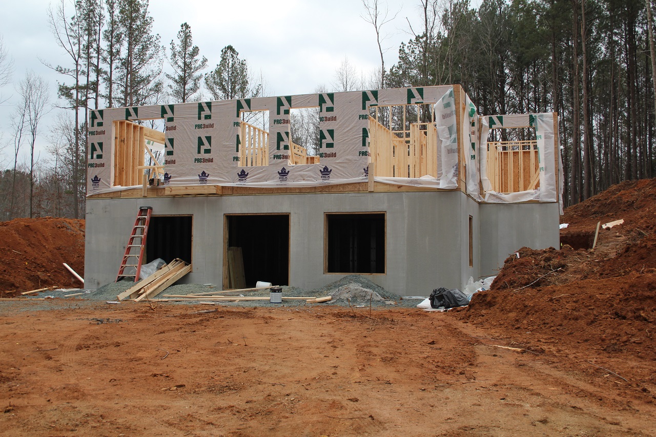

Pete, in your photos of the house, the side window on the walkout basement looks pretty low to the ground. I have two windows on the side of my walkout that go almost down to the backfill. Looking at the surrounding grade, that side window is gonna be in the spatter zone from rain. I'm just surprised to see the sill so low.
Here is a photo of my house when finished in 2002, before I added a deck all the way around the house. You can see that my windows are well above the surrounding grade. Even so, when I filled in and put a flowerbed in front of the windows, I'd get splatter when it rained until the deck above was built.
Jim, there will be a deck over that window, so hopefully rain spatter won't be huge issue. You're right though, that the window sill is very low. Hopefully some of that can be corrected with pulling back a lot of the dirt from that area.
