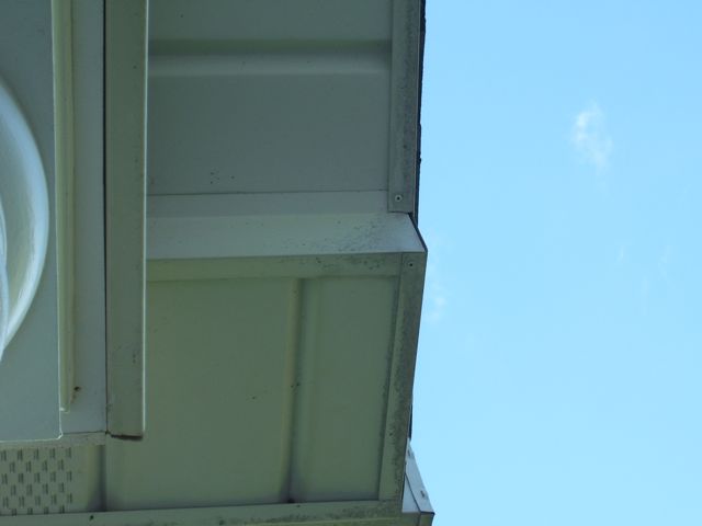

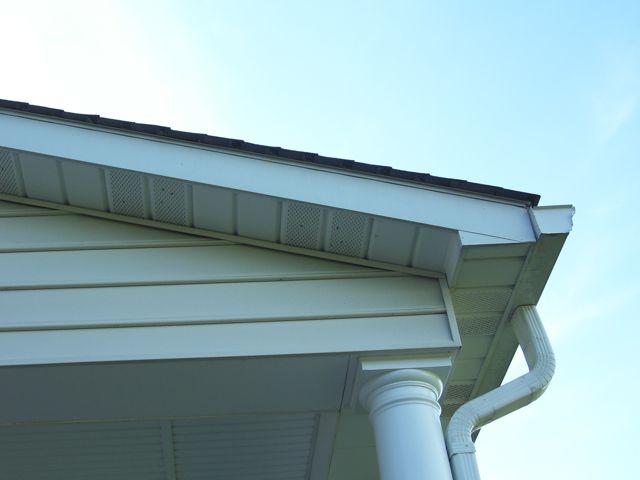

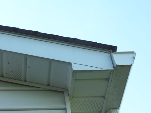

I know I'm late with posting these pictures but did not know if the buckling aluminum fascia was resolved. These pictures are from my 9 year old house so please excuse that they need cleaning. I took the photos from the ground looking up. My installer never face nailed the fascia. He bent the aluminum on a 12' long brake, then slipped the fascia up under a lip near the roof shingles. On the short part of the bend he drilled holes to attach the fascia to the soffit using white aluminum rivets. It made for a very clean install (pardon the pun cause it's dirty now) and I don't have any buckling of any panels. Hopefully the pictures will make it more clear then my explanation. Stanley
