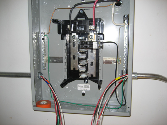

On a good note, it looks like the electrician did a good job of arranging the wires going into the panel. I'd like to see a shot with the front of the panel off now. That's where some are neat and others really get sloppy with either too much or not enough wire going to the breakers. You should also look for a somewhat balanced load on the bars. 110v doesn't matter, but the 220V should be balanced somewhat, even though most things don't run at the same time. In other words all the 220v breakers should not be on one side but they should be near the top.
I agree that a neat panel is the sign of an electrician who is at least trying to do a good job, but are you sure about the whole balancing 220v breakers comment? In the US, 220v by definition pulls off of BOTH bars, not just one, so it is ALWAYS balanced. Its the 110v loads that you have to balance between the two bus bars. The bars alternate, so (assuming that odd numbers are on the left and evens on the right) breakers 1 and 2 are on bar 1, breakers 3 and 4 are on bar 2 and breakers 5 and 6 are on bar 1, etc,etc.
Here is a picture of a small panel showing this:
