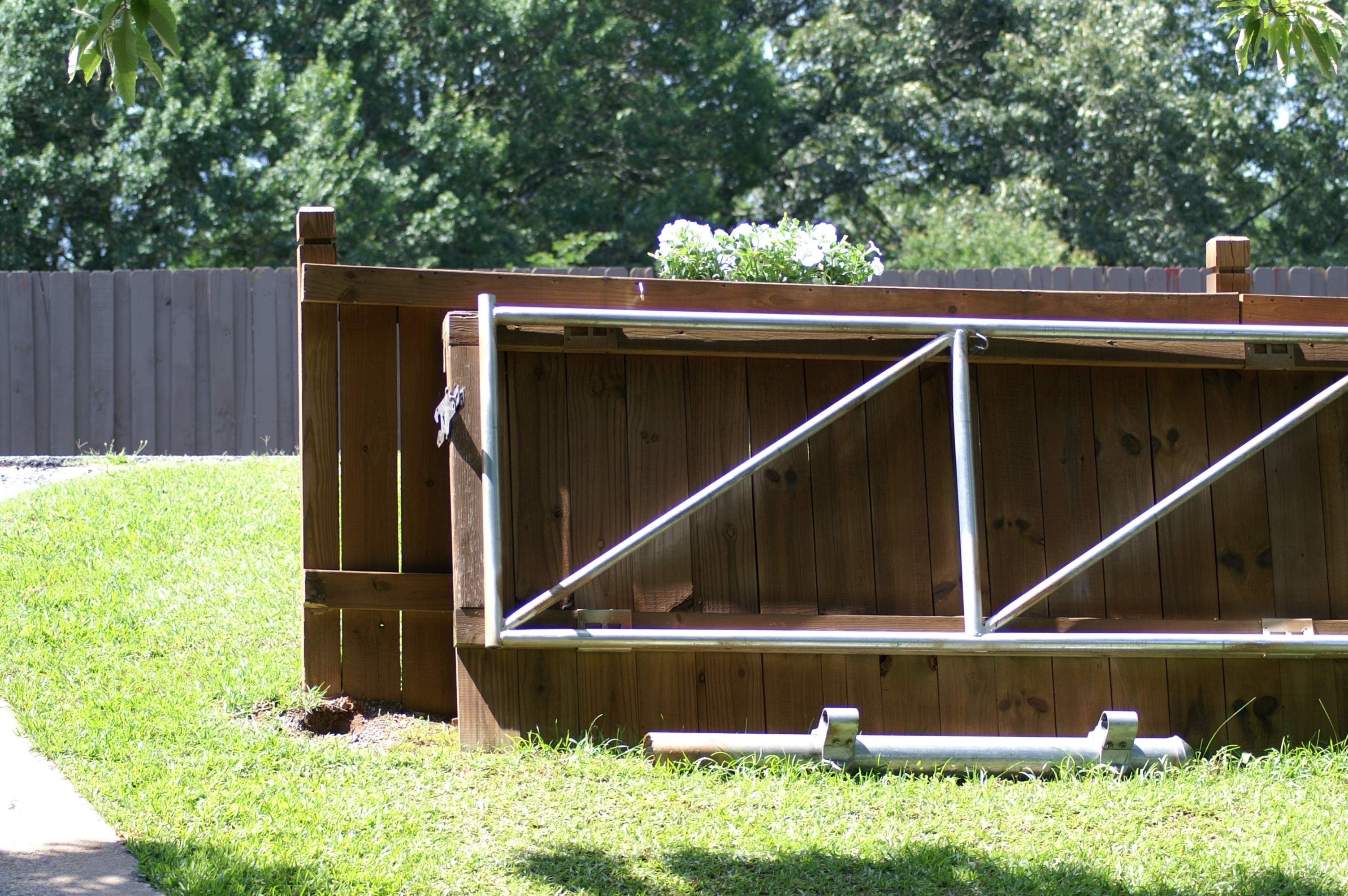

And Stu, yeah there is some "warpage", there is a metal frame on the backside of the gates, but the pressure treated wood has a mind of it's own once in awhile. You should have seen some of the pieces that I replaced a few weeks after the fence went up and it had a chance to totally dry in the sun...they looked like spaghetti. :laughing:
Got a pic of the metal frame you built? I understand that PT warps, bucks and twists all too well, plus it is very heavy. I am thinking that is the reason that a lot of folks opt for gates made out of steel and paint them black for the wrought iron look. I just wonder what it takes to make one that looks like it is wooden, is not heavy as heck, and lasts.

Good god, I didn't build the fence, I had it installed. :laughing: I can't find any pics of the frame on my photobucket, I'll take one tomorrow if I remember.

Stu, here's a shot of the backside of one of the gates. This is from last year when my brother backed into it. :laughing:

I see you are having the same issue with your wooden entry gates as do most people - they warp like crazy over time. Even Peter has this problem at his own property (not the one being discussed here). The only solution I can think of is to have steel or aluminum entry gates on steel posts all wrapped in a wood facade. Does anybody have any better suggestions?
-Stu
My vinyl gates are doing the same thing, and I keep saying I need to build a metal frame for the out of sight backside.
