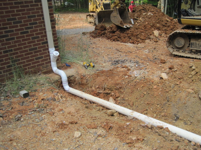

Seems to me that common sense and having a drain pipe in every location where downspouts are would have been a STRONG hint as to the proper thing to do,
-Stu
Unfortunately standard gutters and downspouts don't require overly skilled people to install, which means common sense is a rare commodity, language barriers are common, and meth & beer are no doubt consumed in mass quantities.

My experience is that hanging gutters is a separate trade and what happens to the water once it leaves the downspout is not their concern. Even if there is pipe in place they just terminate with an elbow (which presumably gets thrown away). I suspect that they learn that they don't want anything to do with the underground portion of the job, if there are problems the costs of fixing it are much greater. If they never touch it they can't get blamed for anything.
And the transition part required from downspout to 3" drain is not standard nor do they have it in their truck so they 'did as usual'.
Your drain is good idea but you somehow need a screen there.
Maybe use a 4 to 3 inch reducer to act as a funnel with slight gap between downspout and in ground drain?
I'm not sure I follow you on the screen. There are gutter guards (screens) above the gutters themselves. Are you saying there should be secondary screens at the bottom of the downspouts? I've never seen that.
   / Building a stick frame house in the woods in 90 days #1,299
This is what I recommended to Obed to help clean-out any debris that might get caught in the drains. I would turn the wye to be parallel with the house though.

Ah, that makes sense. I've had to use a snake a couple of times on mine, and I had to start at the exit end. This would probably work a lot better!
