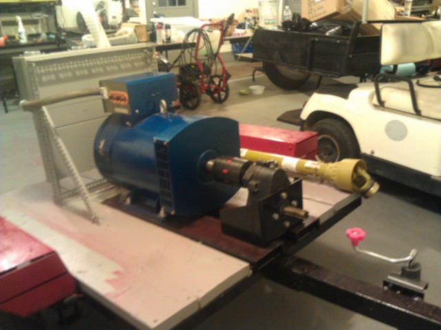

Thanks for the response. I wanted to drive my ST-20 with a belt driven system. I saw someone on here had made a setup like that and I liked the looks of the setup. After checking on prices and still not knowing for sure the HP of the belts capability, I see it will be in my best interest to buy a 'TRACTOR PTO DRIVE GEAR BOX' and 44mmX48mm love joy coupler from a supplier. I checked and the PTO Drive Gear Box is rated to run a generator up to 40 K, so I am comfortable with that. As I progress with the project, I'll post pictures.

if possible I would drive it was a gearbox. a little more expensive, but is HD and would last longer imo.
if it is 3600 rpm gen head with 540pto you would need a 6.66:1 ratio
1800rpm would be 3.33:1 with a 540 pto
If you know you have plenty of power on the tractor you could over drive it some to save fuel, say rounding up the ratio to the nearest whole number. I wouldn't over driver it much tho.

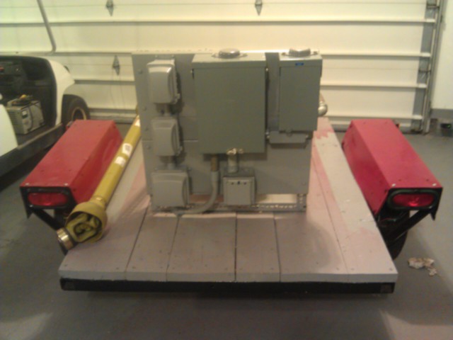

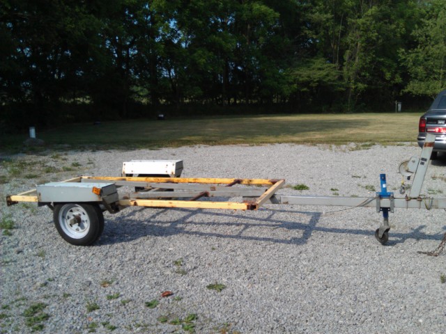

20K portable generator finished and tested. Donor trailer for Generator Project 1.jpgGenerator project (1).jpgGenerator project (2).jpgGenerator project (3).jpgGenerator project (4).jpgGenerator project (5).jpg

I have about $1,800 in it with a heck of a lot of work. Then I installed a new 200 amp electric transfer panel on the outside of the house replacing the standard disconnect which was just over $400. This is a safety that many don't think they need to spend the money on, but could kill a lineman or at the very least blow up the generator. Only takes one mistake.

I only tested it last night, I am thinking I will only be needing about 8000 watts max, so I don't see the heat being a problem. The generator has vents in the front and back. I noticed I got 110 degrees on the gearbox at the top left after only 10 minutes. I know that isn't much and maybe the grease hasn't worked its way there, so I will watch that more than anything else.
Also I made a decision to put it on a trailer to be able to transport it easier since we have so many different electric companies and I live in an ag area. I also wouldn't have had to install the outlets and panel, just use it on my home and screw anyone else that might need it if I am not using it. So the material to install those parts cost me about $200 more.

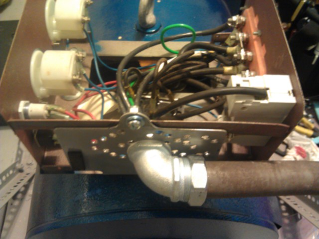

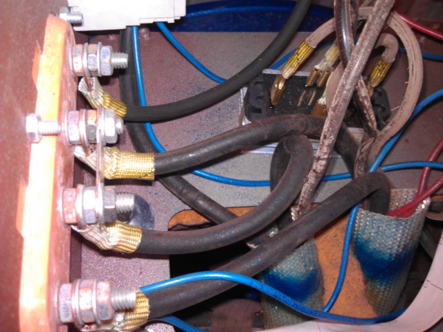

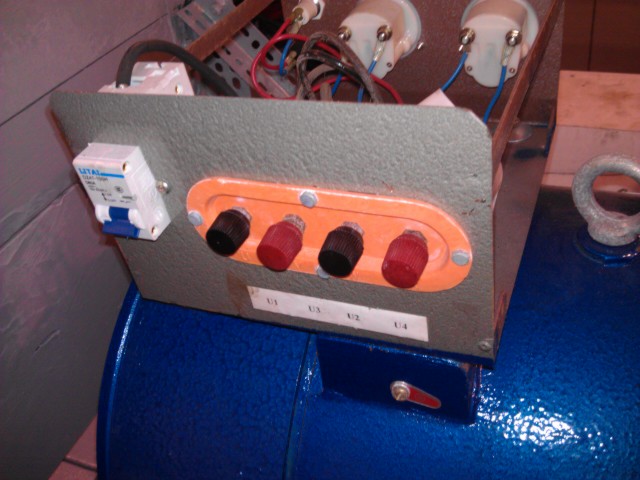

Yes, of course it has a fan, so there should be on issues. I want to say something about the generator. It was made in China, so of course it was shipped over in a container. There was some rust on the connectors where I was suppose to hook my leads to and a few rusted screws holding the fan covers on. Also the cover for the head and the sheet metal for the vents and brush cover were so thin, I wasn't too happy about that, thin as a soup can I’d say. The generator itself seems to be very well made and heavy duty.
Also the unit is designed to hook the leads up on the outside with the black plastic cap screws. If I did that then someone could get shocked by accidently touching the wire connectors, this is why I went inside to connect the leads.
