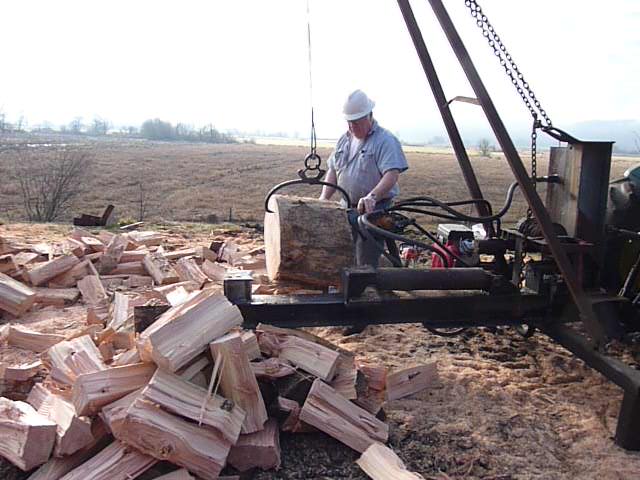

After remodeling mine by putting a honda engine and pump on it to make it self contained it really puts out the wood. Cycle time is around 7 sec, not a 2 stage pump. As I still use the T type knife, as the block stays together for the next push with just two pieces coming off the bottom leaving the main block in one piece. Really cuts down on picking up the other half for resplit.

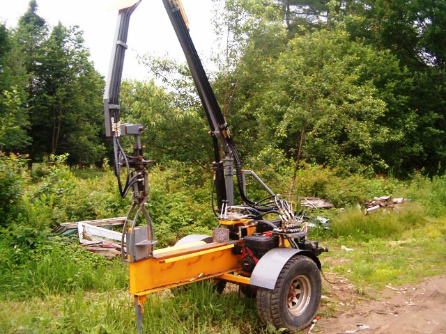

   / Building a hydraulic log lift for splitter #44
Sizzami,
WOW, My lands, what a set up. would it be possible to post more pics from different angles?
I don't see a hitch. how do you stabilize the splitter when lifting?
did you fab the boom set up, or was it an existing set up?
   / Building a hydraulic log lift for splitter #45
I cant seem to find my other pics I will take some more , I built the entire thing from scratch one winter . it has a trailer hitch on it and a manual slide out outrigger on the side away from the loader.

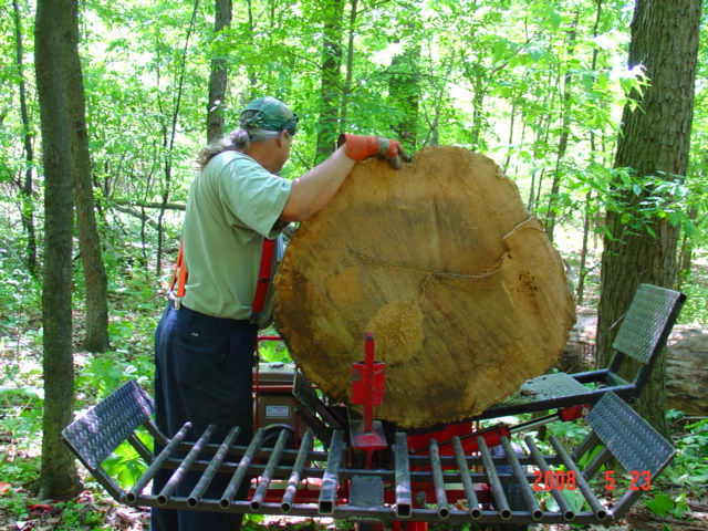

Hi
My splitter - details:-
10 Hp Kohler - 16gpm pump - 5 inch ram
Secondary pump driven off coupling too main pump via belt - Toyota power steering pump which drives --
Hydraulic lifter , conveyor and conveyor swivel.
This started off as a horizontal splitter. then vertical on ground and then to raised vertical - would never go back to any of the former methods. This still remains a work in progress

   / Building a hydraulic log lift for splitter #48
hardest to build easiest on your back.:D
Sizzami! you got a video of that thing working? I like the hydraulic grapple! Why walk over to the log to hook up when you can reach out and touch someone?:laughing:
