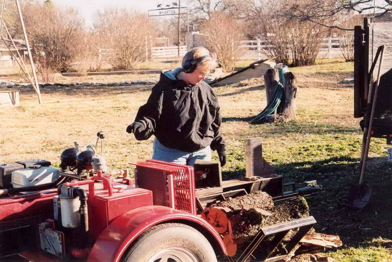

I have a log lift on my log splitter. It looks like I don't have any real good pictures of it, but I guess I could take close ups if anyone is interested.

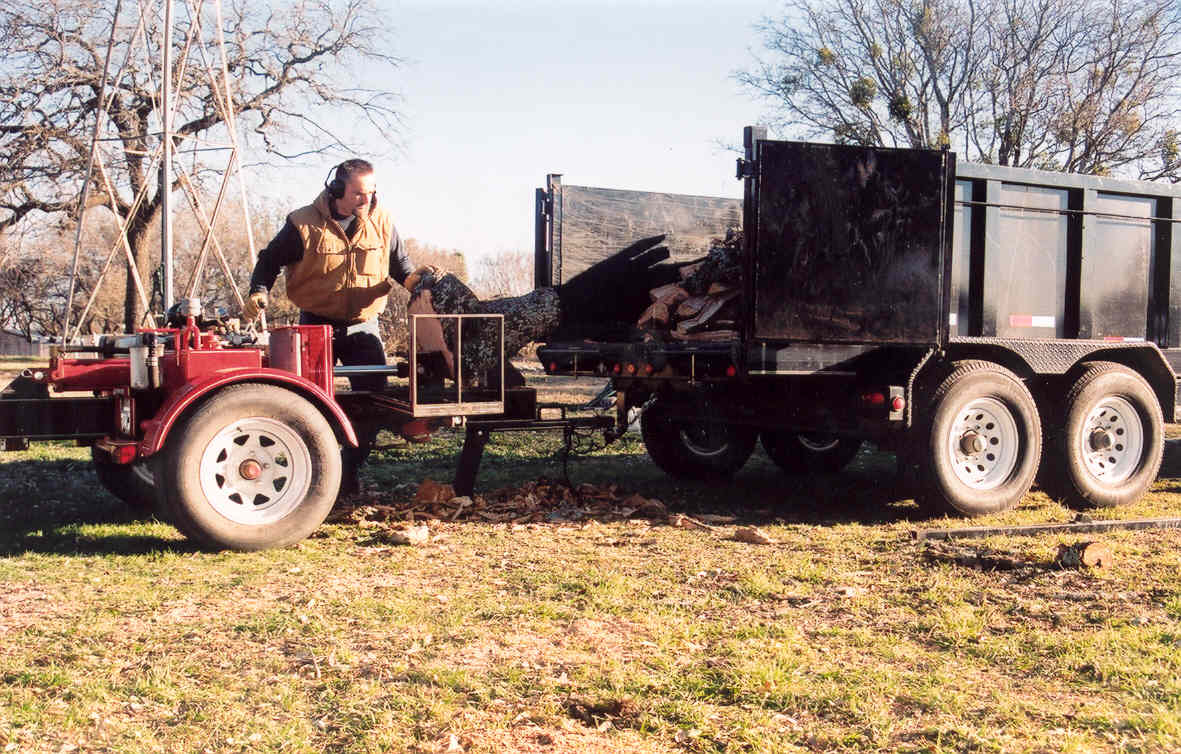

In the two attached pictures, the lift is all the way up in one and partially down in the other. When the lift is all the way down, it sits on the ground like a big "L". You roll the log onto the horizontal section and the hydraulic cylinder swings the lift up.
The lift rotates a full 90 degrees with 8 inches of cylinder stroke. So when the cylinder is all the way out, the lift is in the up position and when the cylinder is all the way in, the lift is in the down position. The trick is to calculate the pivot points so that you have exactly 90 degrees of swing with full cylinder movement (8 inches in my case). That involves some geomety and math, but I like doing that anyway. I'll volunteer to do the math for the pivot points if you want to build one like this.
A lift makes the work so much more efficient. Not only can you use it to save your back, you can work with large pieces that you would otherwise have to pass up or rip with a chain saw. Not only that, but I use it as a holding tray for wood to be split (kind of like the second picuture). I can put the lift in the half way up position and load it with several logs. I can then go about splitting and roll off each log onto the splitting beam. It makes the work easy enough that I can even get my wife to run the splitter on occasion. Hydraulics are just so cool.

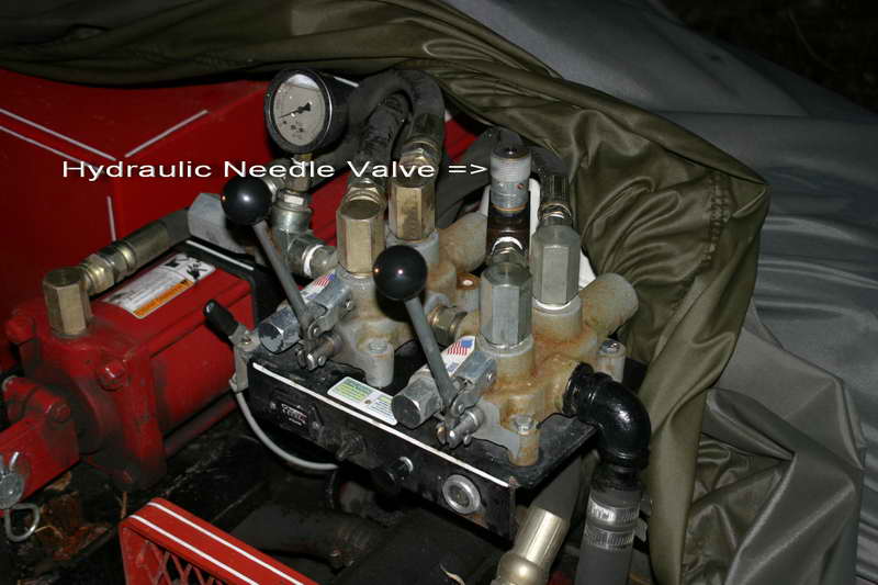

I also included a picture of the needle valve that I use to slow down the hydraulic flow to the lift cylinder. Make sure you use a valve designed for hydraulics. It is simple to use - just turn it counter-clockwise to open the flow and clockwise to limit the flow (slow the lift movement). You can also turn the valve so it is completely closed. This helps lock the lift into the up position which is required during transportation. Otherwise, the hydraulics will slowly bleed down and your lift will end up half way to the ground.

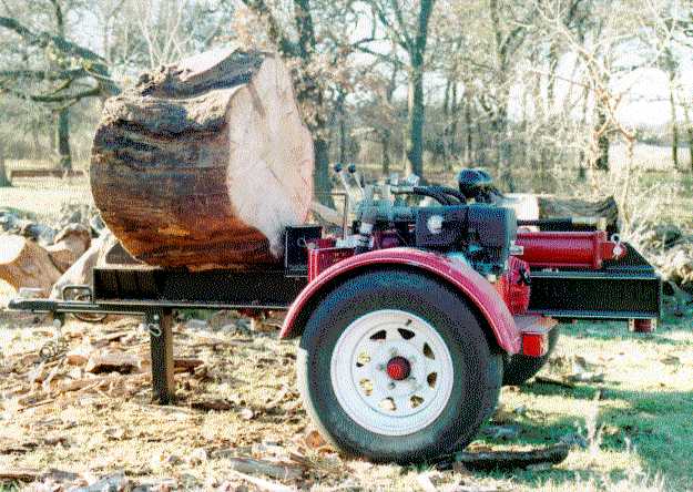

The last picture is of one of the bigger logs I've lifted. It's about 36 inches is diameter. I built this log splitter in 1995 and have about 130 hours on it.
