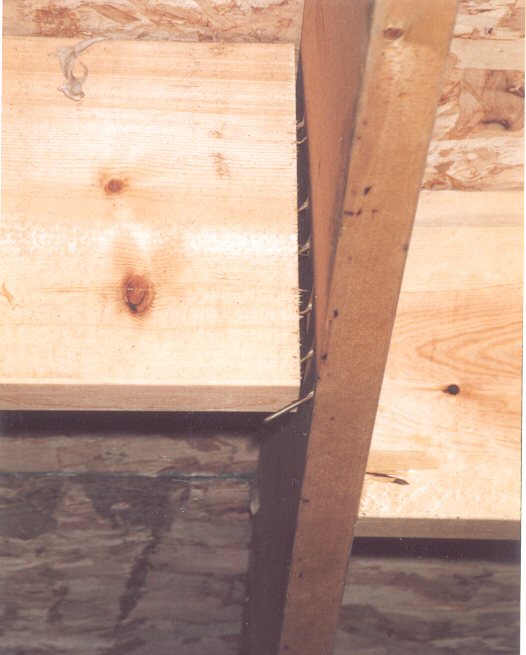

/ Building A House/Doing It Yourself/ICFs #22
Oooh, that picture hurts! That would really upset me and start a battle./w3tcompact/icons/frown.gif
