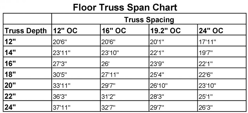

The original idea for that support would be to pour a footer along that wall and run 4" blocks to support the floor trusses. I could go 8" for better support, just wasn't sure if there was a better way of doing this. The 16" OC floor truss was spec'd by the company building the truss. 16" OC can span 20' 6", and nce you add in the 8" block support on each side, I'll be right under a 19' span. Even if I would go 12" OC, there is no advantage according to the spec sheet. I would rather use a truss than an I joist since they are open web and I can run my wire and ductwork. I've done additions like this in the past, I just never used floor trusses before, so they are new to me. Just looking for some input.

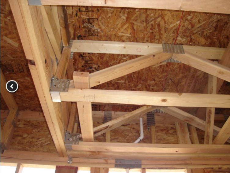

I was doing some research and they do but up floor trusses to other floor trusses with joist hangers without using a ledger. A ledger board would reinforce it more. The floor truss I would butt up to sits on the outside block wall of the existing house.
