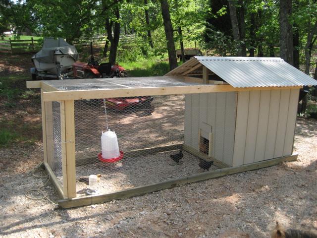

I looked up that Diamatic......earth stuff, as I had never heard of it. Neat stuff, although a bit pricey. The smell was only an issue when the brooder was in the garage. Now that they are out in the tractor it shouldn't be a concern. Yes, I said...."out in the tractor"! We moved them out today! :D I could tell they were really enjoying themselves. Until this evening, they basically cried wanting to come back in the garage and stayed huddled in the corner closest to it. :( I suppose it will take a night or two before the tractor becomes "home". Tonights low is 48, I wonder if I sould be concerned? They are feathered out pretty well.
I was really happy with how the small coop door came out. It slides up and down in a track by pulling a string at the top. Again, craftsmanship is a bit rough, but I think a coat of paint will do wonders.

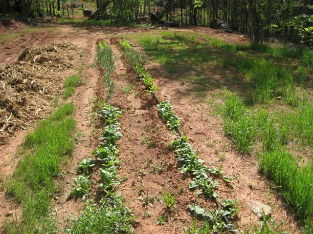

Here's a shot of the cool season crops this evening. We've been eating spinach every night for a week with this much still left. You can see the beets on the right then onions and beyond those are the carrots.
The summer crops are coming up already! Corn, squash, watermelon and cantelope are all an inch or two tall.

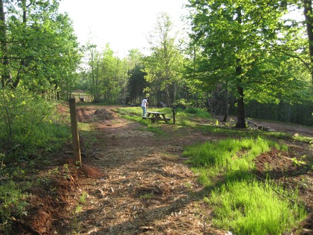

Here's a shot of my wife doing her evening weeding. It's theraputic for her. Gives her a moment away from the chaos that is our house! Everything is so much prettier with all the leaves out! Remember, we haven't been in the house through a summer yet, so this is our first time experiencing spring here.

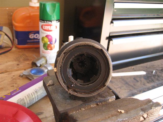

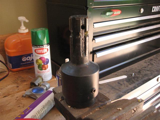

I've discovered why my ORC slipped off the other day....I don't know how it works!
I thought that the two set screws on the sides were meant to hold the ORC on the PTO. Apparantly not. :confused: They have something to do with locking the clutch, but not holding it to the PTO.
So what does hold this on the PTO? :confused:

Tony that looks like an extension for the PTO shaft on the tractor. I would think the set screws would lock into the holes on the shaft. Do you need this extension? if not just connect direct to the shaft on the tractor.
