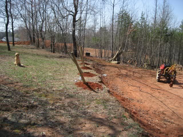

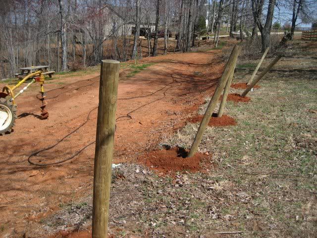

The day was made all the happier with my second attempt with the post hole digger. We got 13 holes done in less than an hour with not a single bead of sweat. :D
After my failure last time, I was very careful to ease it into the ground very slowly and lift at the first sign of roots or rocks. The technique worked great. It even did a few holes that had several carrot sized roots to break through. I found that if you limit the depth and just let the rotation break up everything, that it will go through more than I thought it would.
I had to hand dig the one hole closest to the powerline, and that was enough to illustrate what a back saver the PHD is.
If I had a straight run of posts on flat ground with no roots, I bet I could pop 30 of these in an hour.
Anyway, much better experience this go round. :)

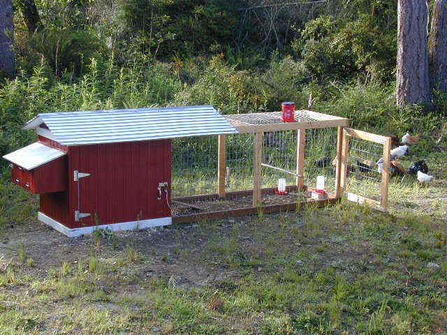

I found this inspiration photo on a chicken forum by another poster. I think its a good starting point for what I have in mind. My girls will free range probably half the time, so I'm hoping that I can get away with this smaller coop.

Nice work on the fence posts, looks like you had one heck of a productive weekend! Is that all the posts you have to do, if not how many more need to be done. Hand digging holes is never any fun. I am still looking for a used phd for our place.

toro, that's about a dozen fence posts done, and I'm estimating about 120 in the farm and another 60 going down the drive (which will be the orchard). I don't think I'm going to go pick up the Buffs. Six will give us more eggs than we eat, and my housing needs will stay pretty simple this way. Once all the fencing is in place and I have time to build a real coop, I'll add more chickens. I think a pair of goats will come next spring.

Set my corner posts with concrete yesterday. I put an 80 pound bag in each hole (36" hole). All the line posts are just tamped in with clay.
