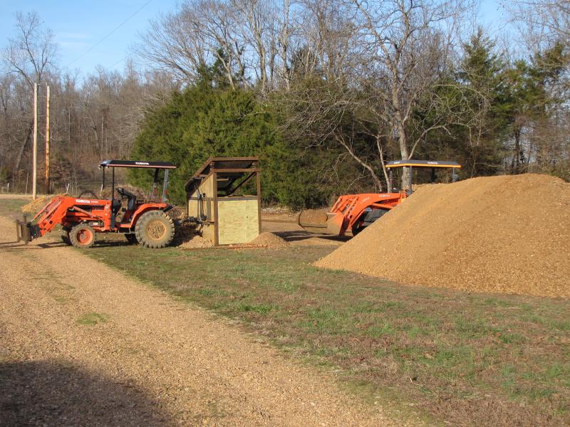

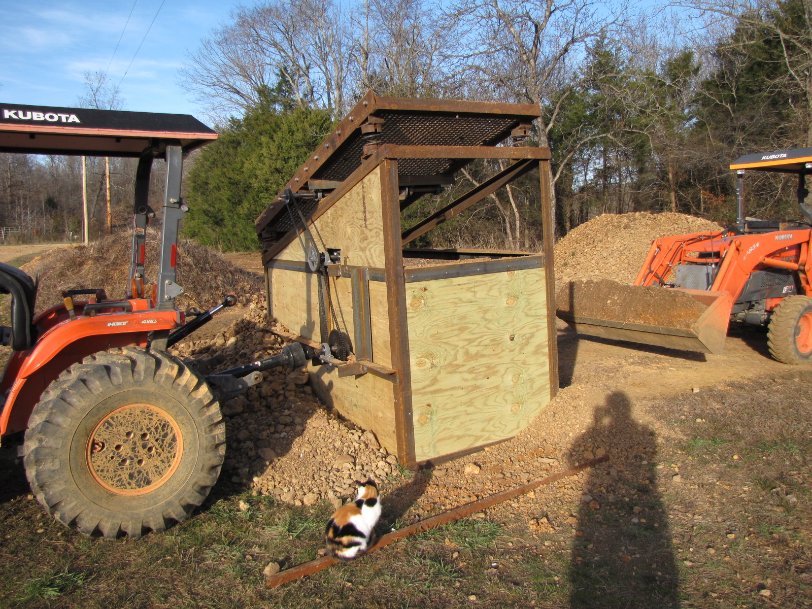

I have tried different screens and the only one that works good is the screens made for shakers. I just got done with a shaker and it sure works great and fast. Here are a few pictures.
You are doing a great job and I'm waiting to see this job to the end keep posting pictures.

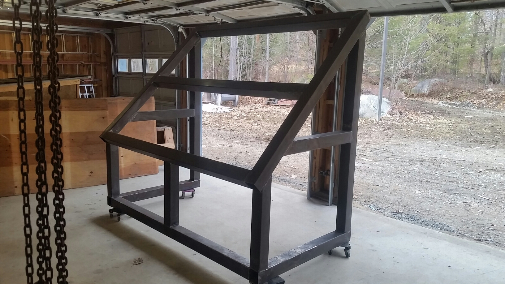

Made some progress this weekend, only have 4 or so bars left to weld on and the 4" screen will be done.
/ Building a Grizzly Screen
#28
Finished welding the 4" screen today. The frame is done, the screen is done, and the plywood sides are cut and drilled. Now I just need some warm weather so I can paint everything! I am going to wait to build the overlay screen untill I have a chance to run some material through incase I decide to make any changes.
If you have a good eye you may spot my mistake, someone needs to learn to mark witch side of the line the bar belongs on :D ! I started putting the bars on in the center because I knew the last space on each side was going to be oversized. It should have been 4" between each bar and about 4.5" between the last bar and the frame. But when I started I put the very first bar on the wrong side of the line, so I ended up with 4.25" on the left and 5" on the right. All the rebar I purchased was 5/8 but I screwed up and shorted myself a stick, so there are a few 1/2 that I had on hand mixed in, that also made the last opening slightly larger.

It sure looks good, but might not look like that long. You did one thing wrong, I made the same mistake on the 1st one I made. You put the wood on the outside and it well get pushed off when cleaning out. You can clean the back side by pushing it to the side then pick it up. I did some shaking today for about a hour and got about 12 yards of clean stuff.
I think I might have to drop my angle down some. I think I'm losing to much smaller rock that's not getting time to go thru the screen. I'm going to try slowing it down 1st, just have to order a new pulley and belt. Right now the tractor's pto is runing as slow as I can get it.
