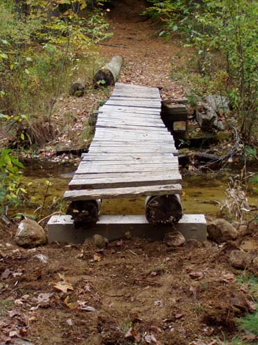

I recently designed & built a new bridge in one of our town's conservation lands. It was a good project that went pretty smoothly. Here's a pic of the old bridge that was replaced.

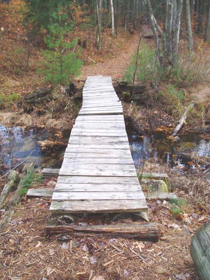

First my son and I started off precasting a couple of concrete abutments in my garage. Something to do on a rainy weekend, anyway. Here's the form with rebar and anchor bolts:

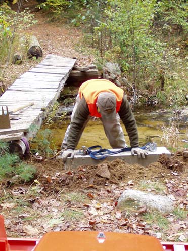

My BX is awesome. We swung the old bridge out of the way and set the abutment....

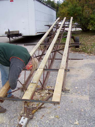

We prefabricated a steel skeleton at Importech, a local imported car repair shop. I used 26' steel bar joists for stringers and welded on horizontal and diagonal bracing. Here's the last piece of wood sill being bolted down:

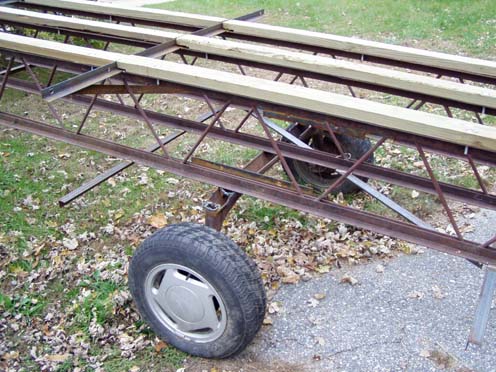

This bridge came complete with a VW axle and radial tires. We were bumming it didn't have some hot alloy wheels.

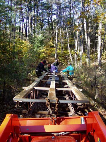

I towed it to the site, then got behind it and wheeled it into place, using the old bridge and pipe rollers for the last bit (after removing the VW axle).

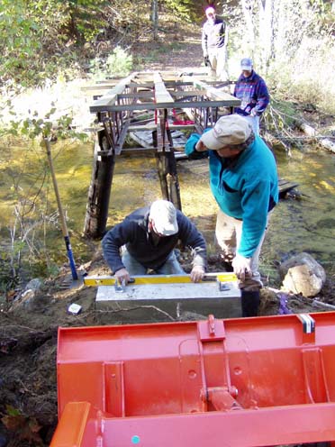

We propped up the new bridge long enough to set the other concrete block:
