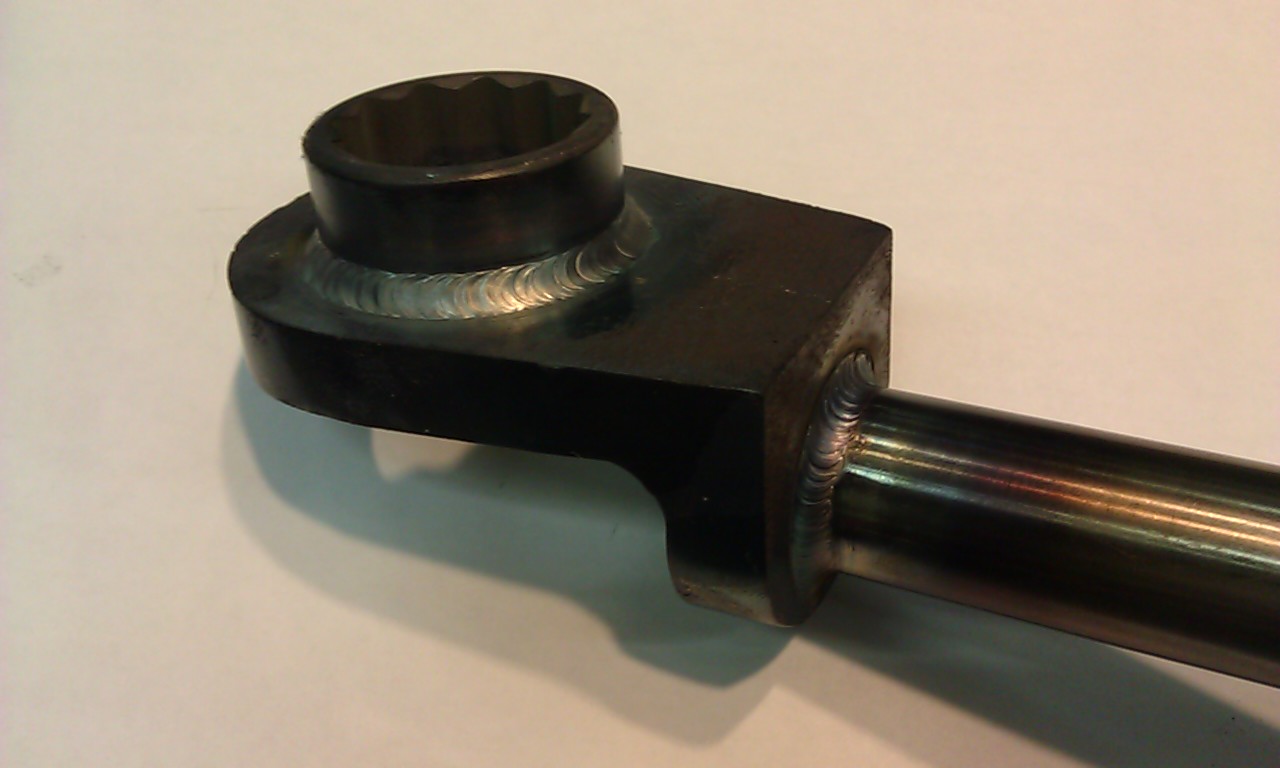

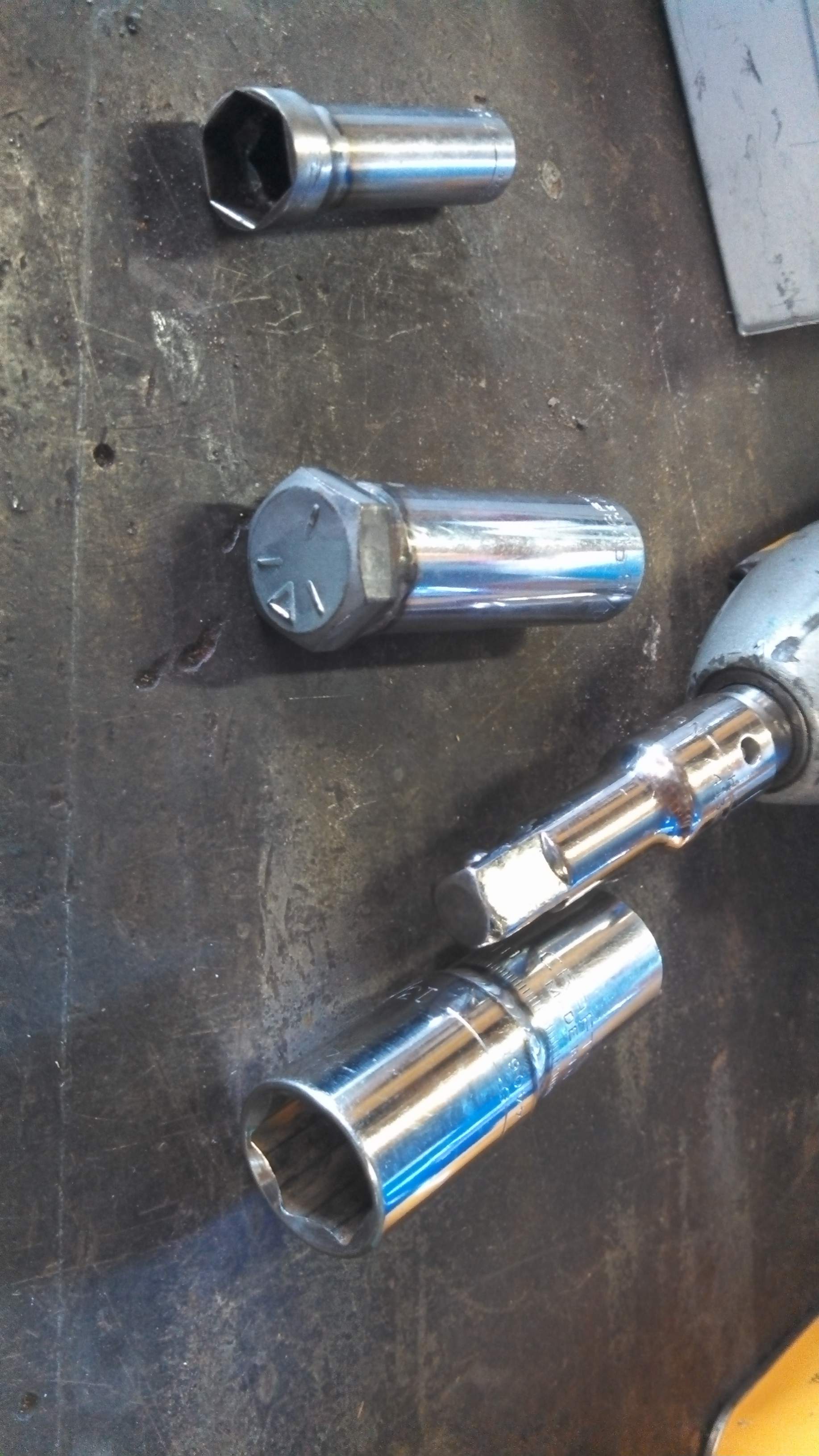

You can weld sockets. From top down in the first photo, a special spark plug socket to maneuver around headers using a 5/8 and 7/16 socket welded together. A really big allen socket welded from a grade 5 bold and a socket. Two sockets welded back to back so you have the right size for most lug nuts without having to go back to the tool box, must use with a short extension.
The second photo is of an impact socket welded to a fixture that allows use in a special torque wrench.

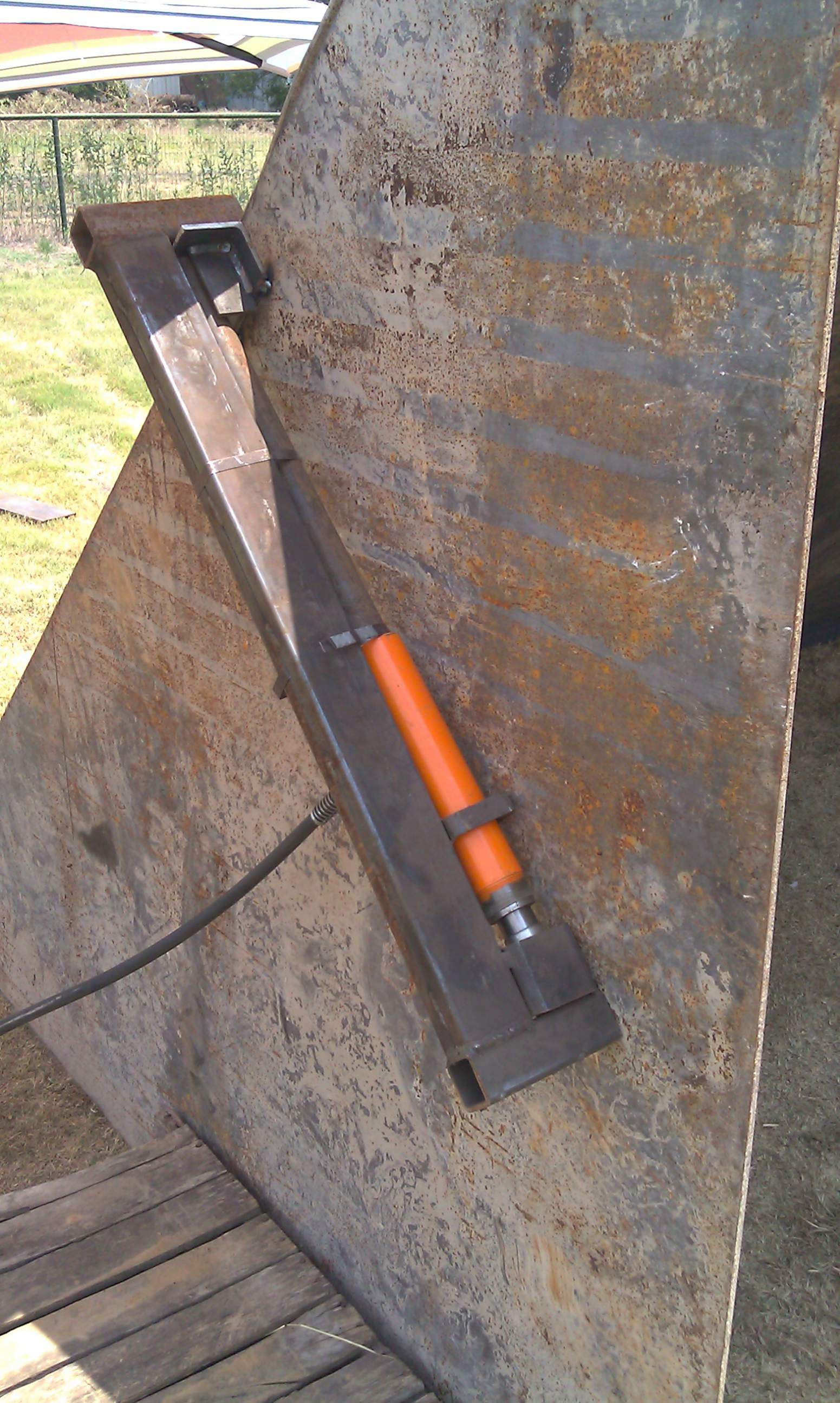

The last photo is something that popped into my mind with the thought of homemade clamping devices. A 10 ton porta power C clamp.
