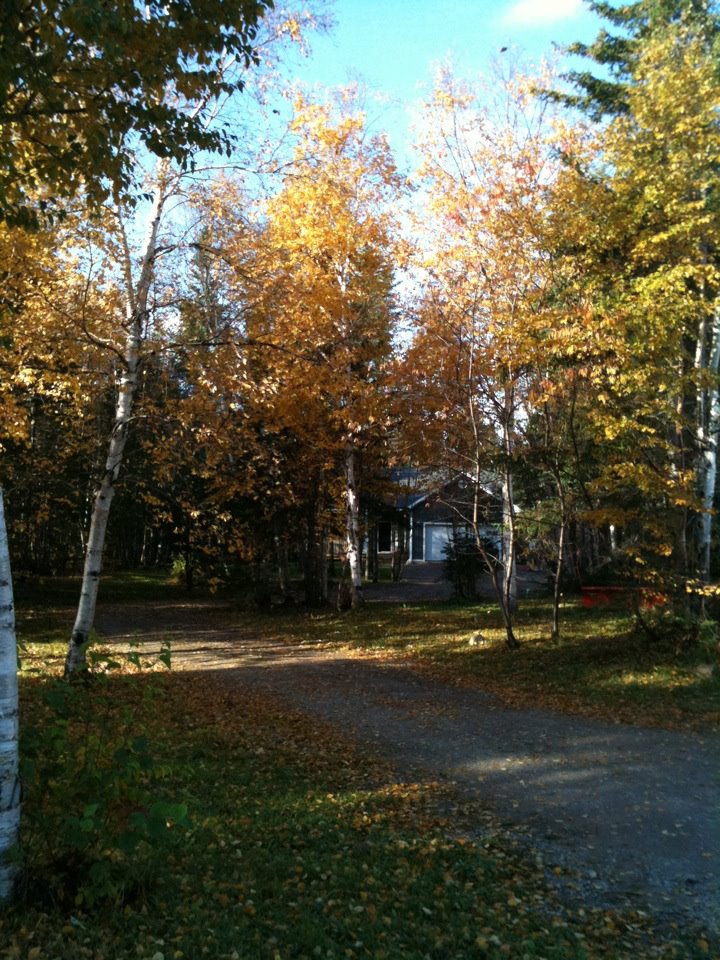

I like the meandering two track idea a lot. As quickly as possible Id like this to look as though it were a woods trail that has existed forever. This is a picture of my house... As you can see we like the woods.. The plan when we built was to make it look as though is belonged on that place like one of the trees so the land dictated where the house would be and how the driveway would route. Thats how we roll :) The house itself is in a nice clearing back there although you cant tell from the snap from the road.

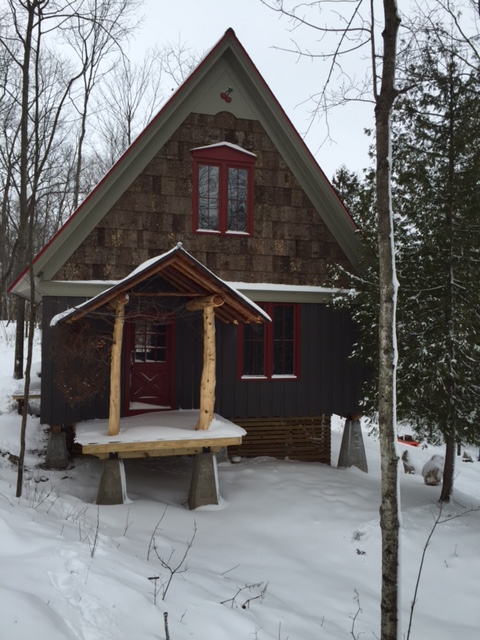

We just finished the exterior of our cabin project. It took us 7 years from buying the property to finishing the siding. Things go slow when it's self-performed. The structure is 800' back from the road and the trail runs up a steep bluff. The bluff portion of the trail took me a year and 100 ton of rock and gravel to build. It's a non-electric site and everything came in on ATV's. Although not as convenient, I actually like having to park by the road and then walk in. Gets you to slow down and enjoy the quiet and beauty. Besides, it justified the purchase of a atv. :)
