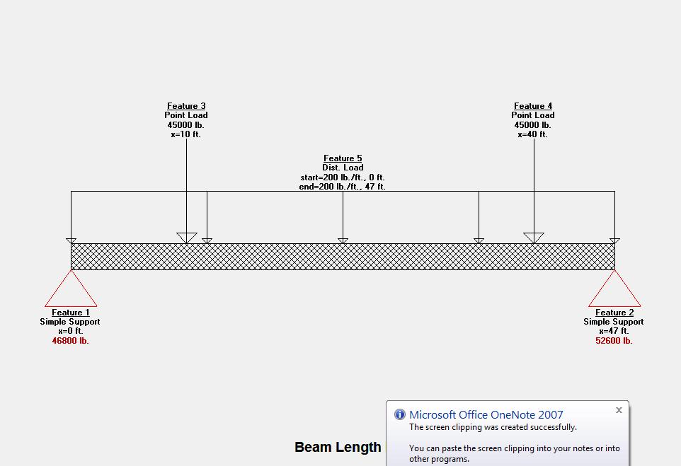

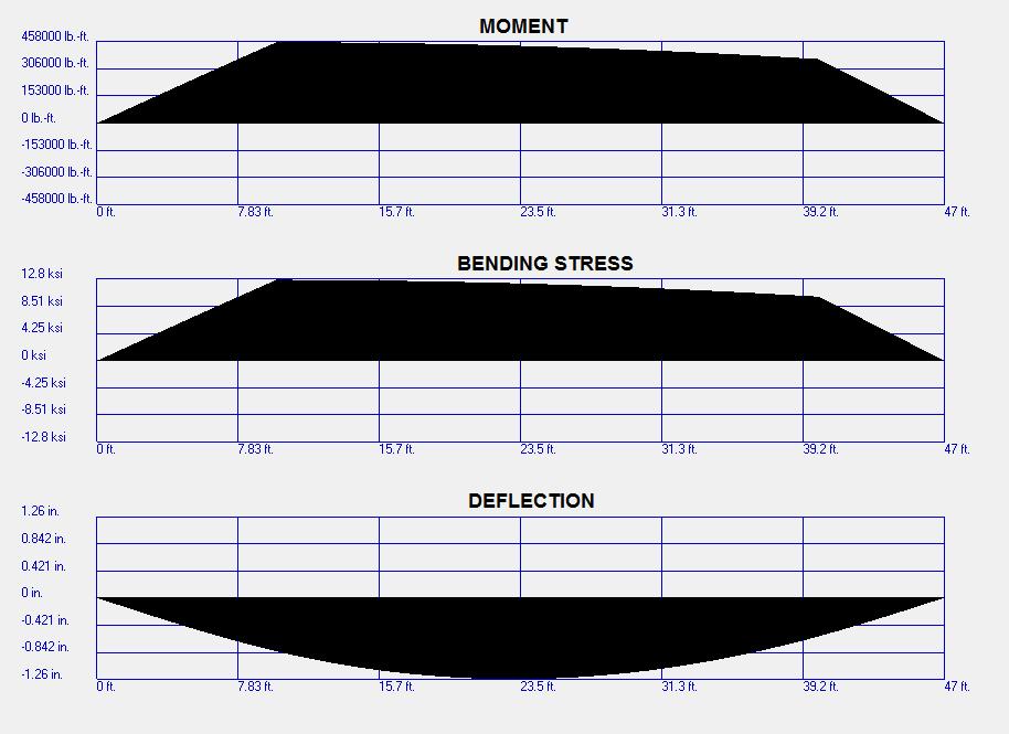

Just for fun I wanted to plug your bridge into beam boy to see the results. But beam boy doesnt list heavier than a w24 x 104 beam. So I had to search online to get the moment of inertia but I still couldn't find a 180# beam. Biggest I could find was a W24 x 164 with a mI of 5170.
Given your span of 47', the max allowable deflection is 1.56". Putting 50,000 lbs smack dab in the middle @ 23.5' only deflects that beam 1.2" with a bending stress of 16.7ksi. Well within the limmitations of the beams (assuming you only have two) even without the deck to make it stronger. And to boot, driving a 50 ton truck over it would never put 50000 lbs in the center of one beam, due to the length of the trucks and multiple axles. I'd say you gould probabally drive a 80 ton dozer over it and not have anything to worry about:)

You sure can. You can do multiple point loads as well as evenly distributed loads. Along the lines of 100lbs per ft all the way across to take into account grating or the road surface
   / Building a bridge to cross stream #27
Here are some pics of a beam. It is a W24 x 164 beam. 47 ft long, 45000lbs @ 10' onto the bridge and 45000lbs @ 40 onto the bridge, with a evenly distrubited load of 200 lbs per ft. (which would total 9400 lbs)
The first screen is where you enter the load and support info and the second is the graph of everything calculated

The bridge I built was done nearly 15 yrs ago, so the exact details of the beams are a little foggy, but the Beam Boy calculations confirm my own observations--there is nothing we plan to put on the bridge that will stress it. Also noteworthy is that the dry-laid stone abuttments that were in place were easily a hundred years old, and had not supported a bridge for many decades. Though subject to flooding at least twice a year, the engineers judged them to be sound and stable, so we just poured a concrete cap on them to support the beams.
