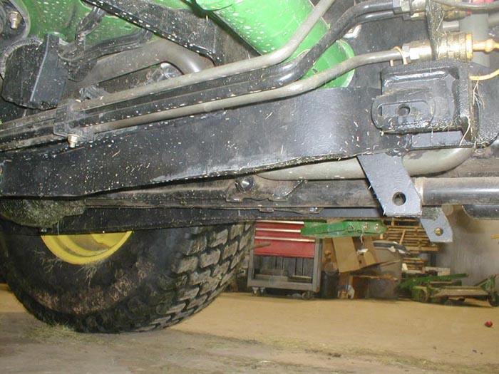

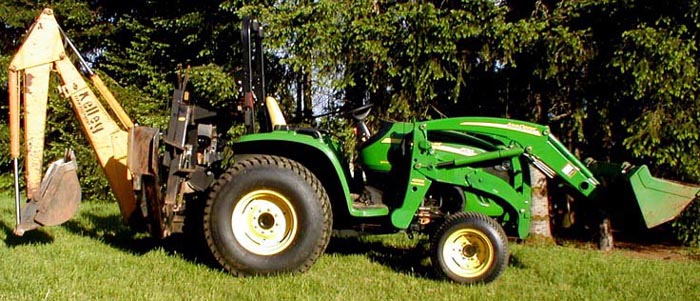

You really inspired me. Took me a couple of months but I finally got mine together. I worked it out so that the subframe works around the MMM and acts as the mechanism to raise and lower it. I have about 5 hours of backhoe work in and it seems to be holding up on my 4120. I will post several photos in the next posts. Thanks again.
Scott

Leftside

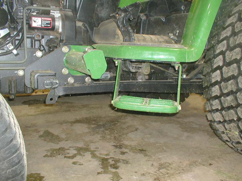

/ Building a 3point backhoe subframe #18
Rightside

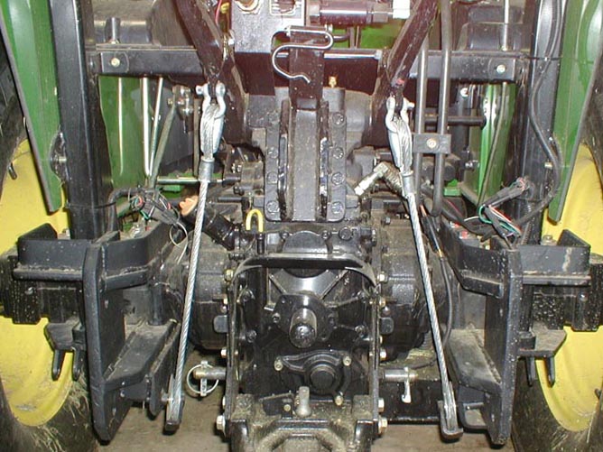

/ Building a 3point backhoe subframe #20
Rear. I was able to design it so that the 3 pt arms still work (work better than they did with the Deere MMM lifting mechanism). I have to take the 3pt back off when mounting the hoe.
