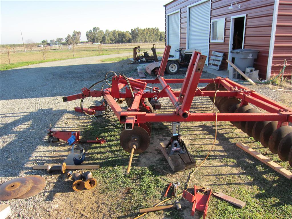

Did a little horsetrading for a family owned 485 IH disc. I want a 6 or 7 foot disc to pull behind my 55 hp Branson. Repaired a tractor and gave $400 for the old disc.
   / Building 6-7 foot disc from large disc.
#2

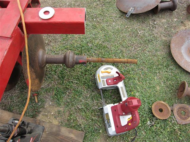

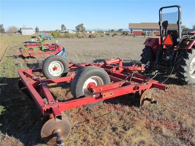

After some quick measurements, I broke it down, most of the work was just unbolting pieces. Did a few trial runs with 2 of the gangs bolted under the center and it worked great! Biggest challenge was moving the wheels inboard a good bit. She's a heavy disc for the size! Ended up with a 7 foot cut with the offset.
As a bonus I still have 2 more gangs to build a heavy offset 3 point disc with.

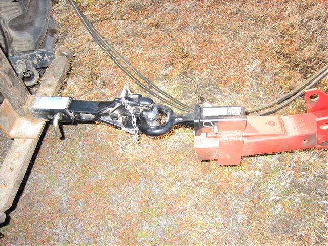

Couple more pics.

About 6 years ago I bought a 14 ft tandem axle wheel disc from my tractor dealer ($600 delivered).
Cut it down to 8 ft. Nice 4 day project.
Wheel disc delivery-2.JPGWheel disc mod-1 (2).JPGWheel disc modify-2.JPGWheel disc modify-3.JPGWheel disc on 5525.JPGWheel disc pintle hitch.JPG

No underlying problem. I already have a 14 foot disc and 125 hp tractor to pull it with. I needed a good 7 foot disc for smaller plots, a new one like I want is very expensive! Built on for 1/7 the cost of a new one!
