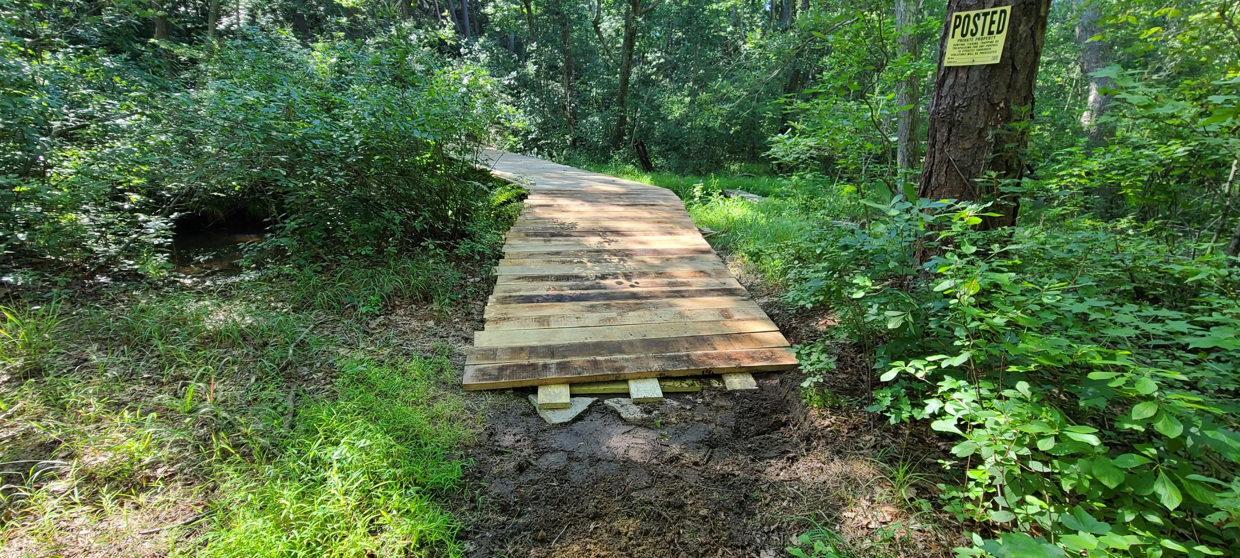

Yes, that's one of our coyotes. We have at least one pair living on the property. Also yes, the tree at the far end prevented me from running the ramp straight down. Pitching the ramp to follow the path allowed me to lengthen it, giving it a more shallow pitch like I wanted as well.

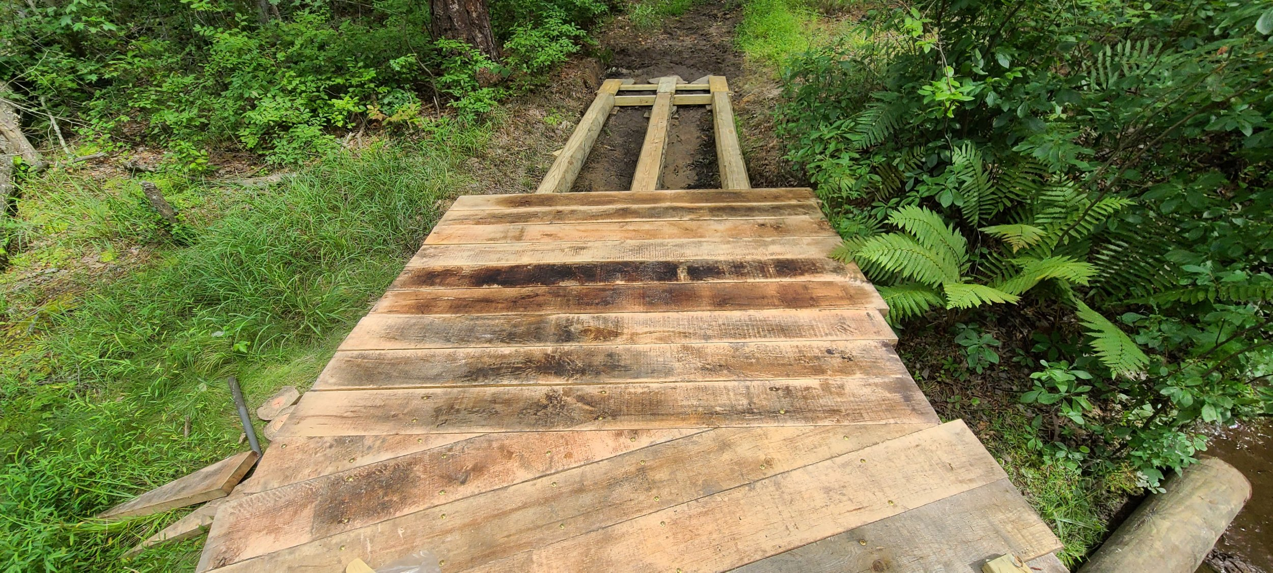

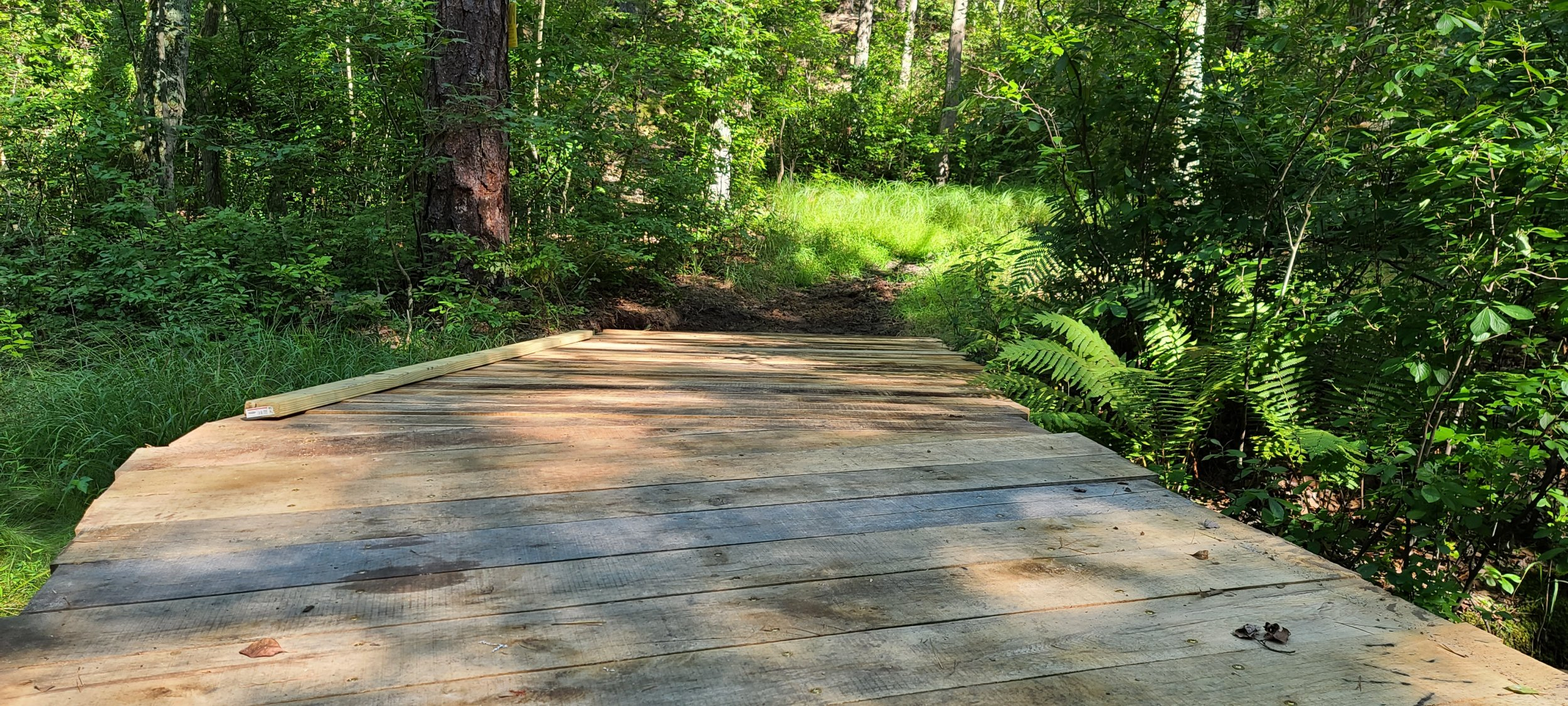

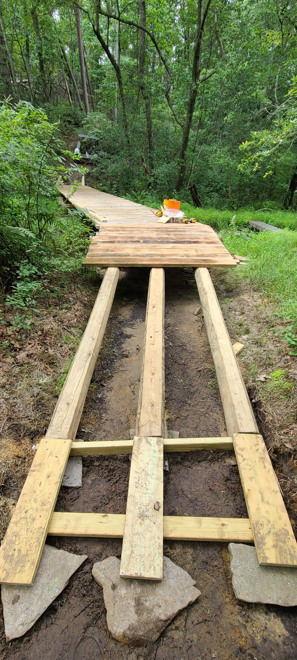

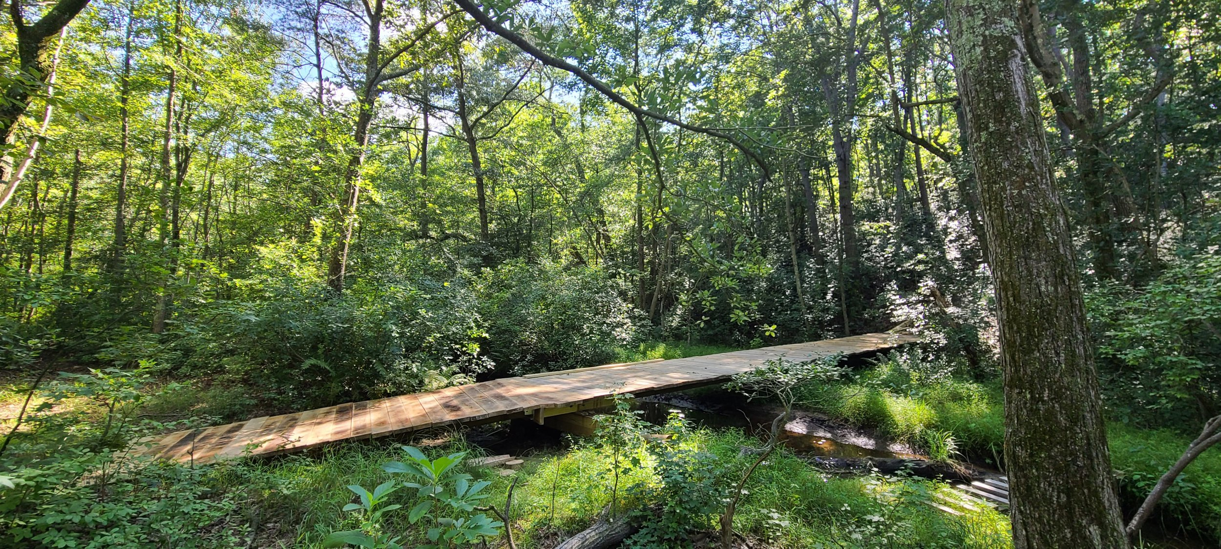

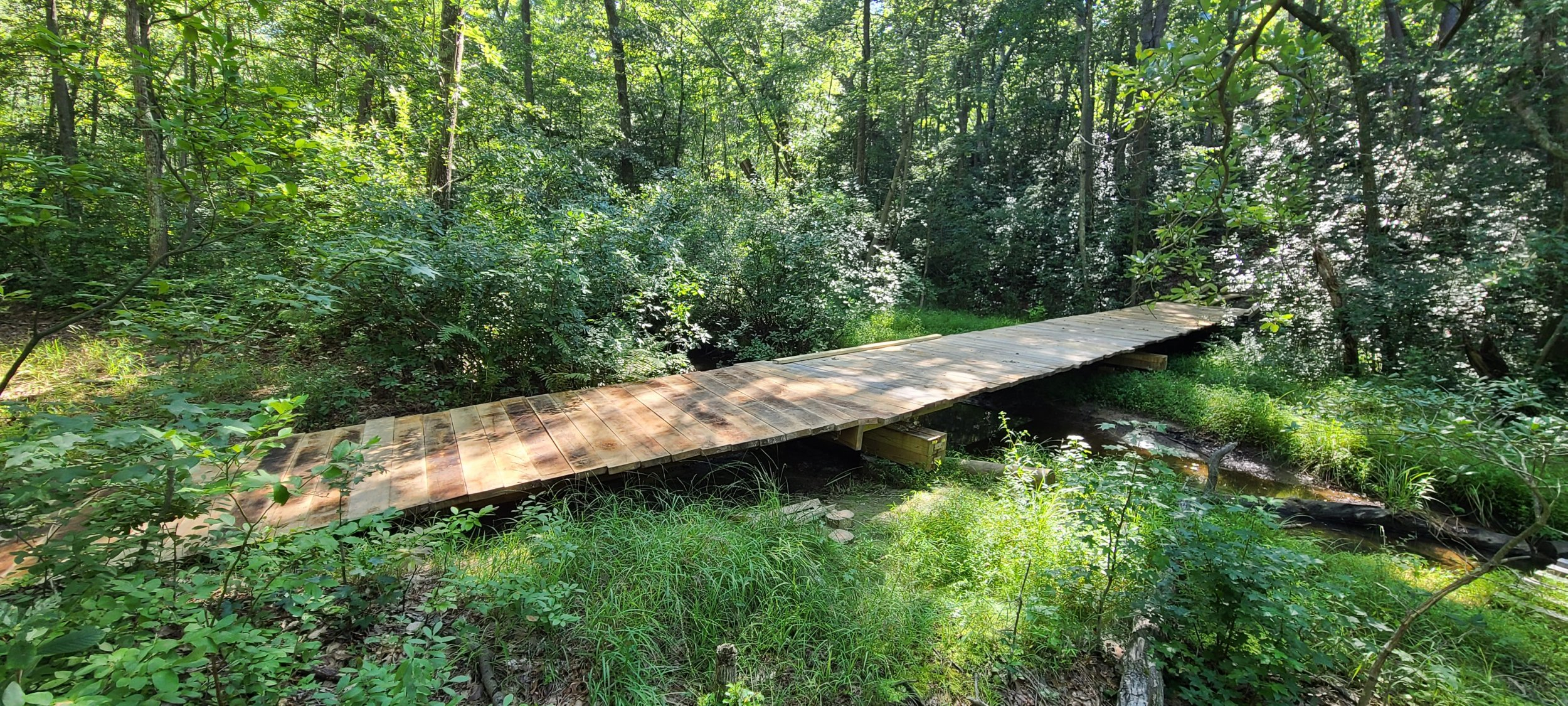

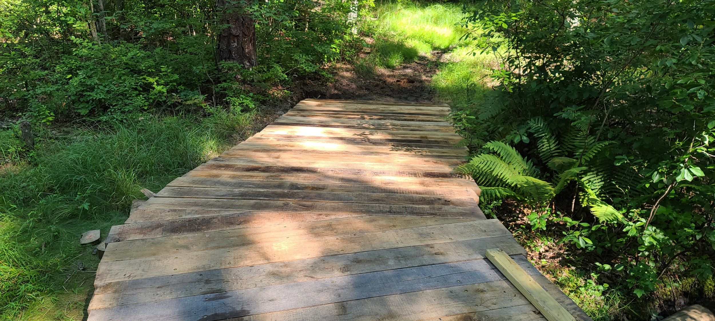

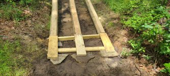

Man, it was so humid today. It's days like today when you realize you're not 25 years old anymore...lol. I wanted to get more done but the heat just zapped me. I was able to level out the ramp and added a small extension at the bottom where it's likely to have some ground contact. That way if it gets rotted over time, it will be easy to replace. The top few pieces of deck that I had to bevel and mitre before the ramp worked out great. I have to get the sides of the deck and ramp ripped down straight and add the bumper rails when mill gets that lumber completed. Some of the decking was still pretty wet from being stacked up for a few weeks, which is why it looks a little dark. It will dry out over the next day or two.

Looks like a flawless transition from ramp to bridge. Are you going to put some gravel down before the ramp?
