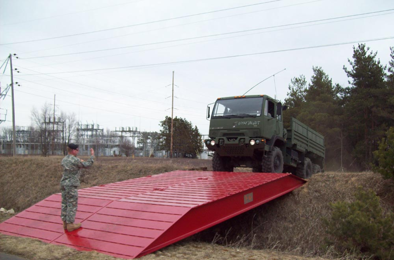

You might consider military surplus. The specs on these are available, which should lower your engineering costs for the supports.
Not sure where you can locate them, but I have known a few who have purchased them for similar situations.
