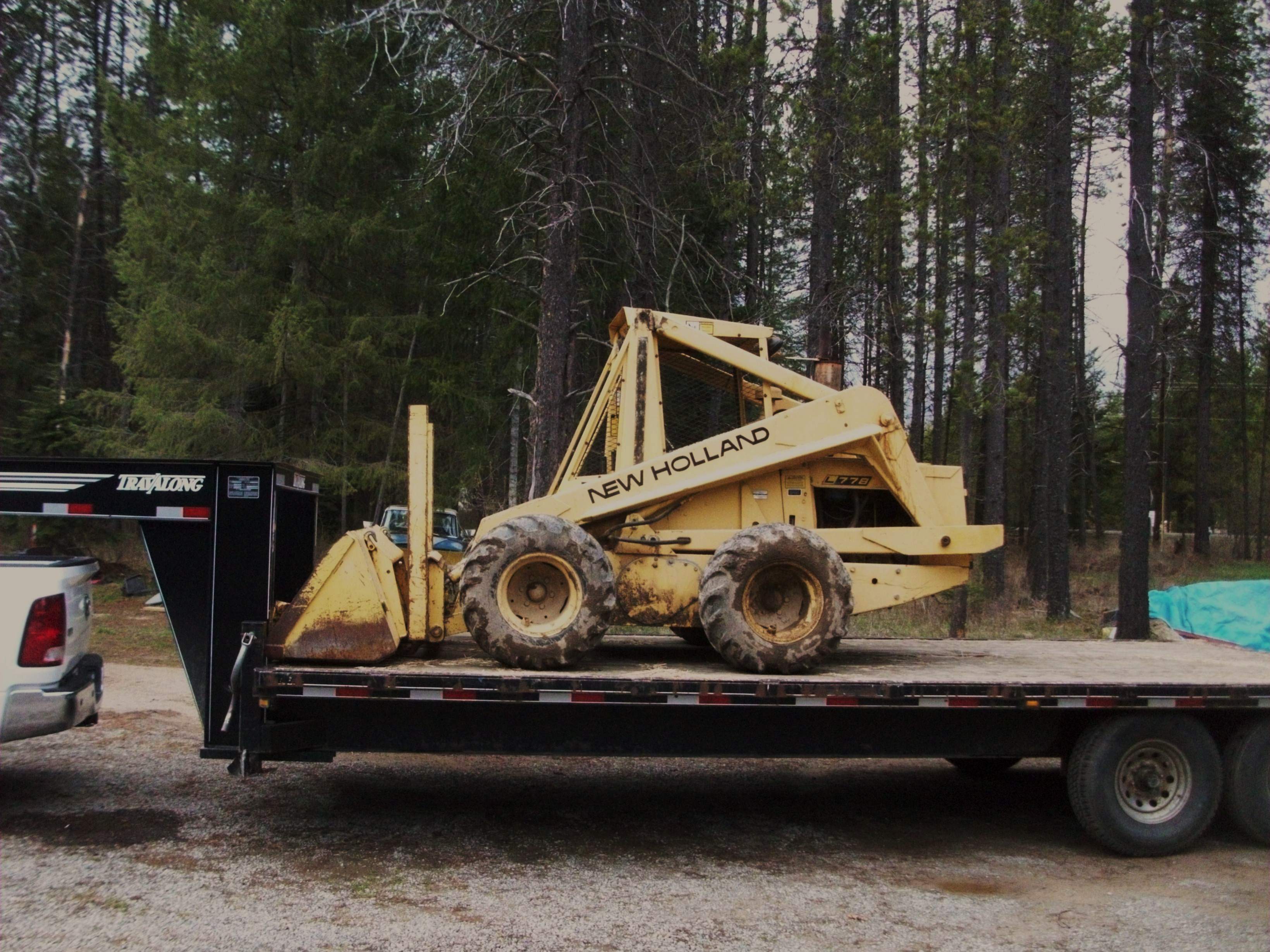

Good Luck!! You can buy a really good skid steer for $15K, but building your own might be fun.
Yep or just find a good usable one for a lot less.
sold my New Holland L 778 skid steer that was fully functional for $5500, had lots of use and I did keep the pallet forks. The right lift arm had been broken many years ago but the re- weld has held fine.
Not crazy about skid steers and being as old as it was i figured that was a fair price for both of us- especially since the buyer already had a twin except his was powered bu a Wisconsin engine instead of the ford gas 4 cylinder in the 1 I had.
OP keep an eye on craigslist- deals do come up from time to time
