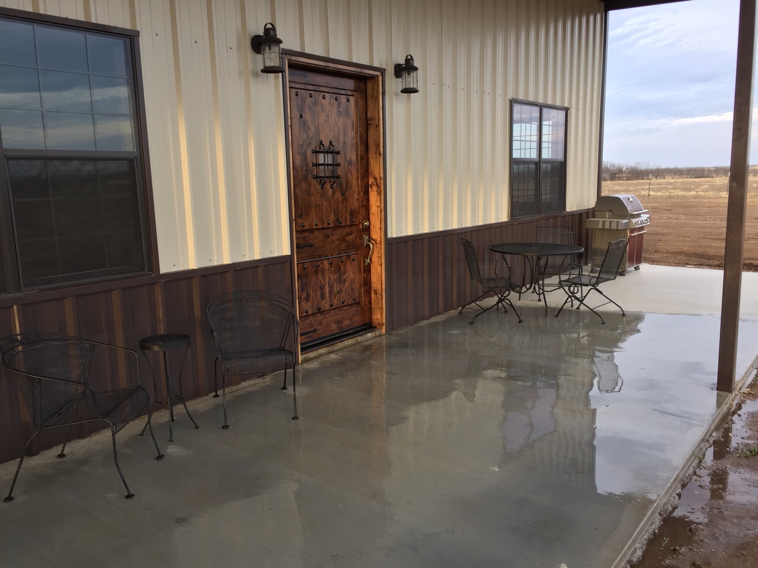

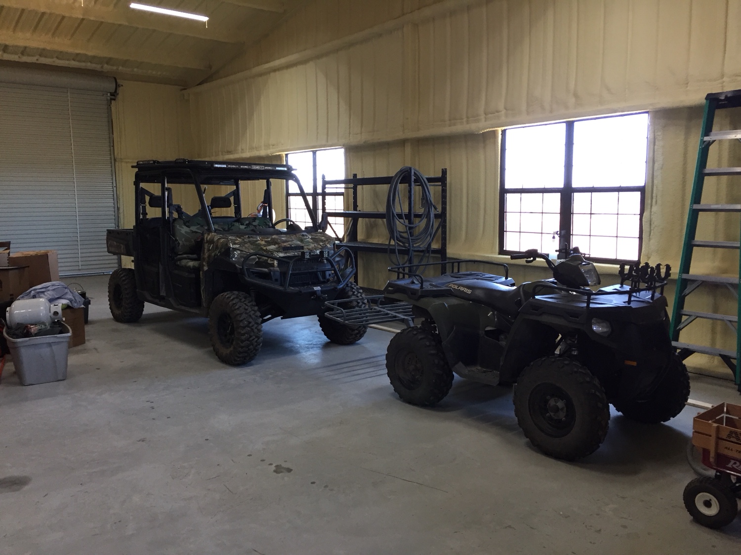

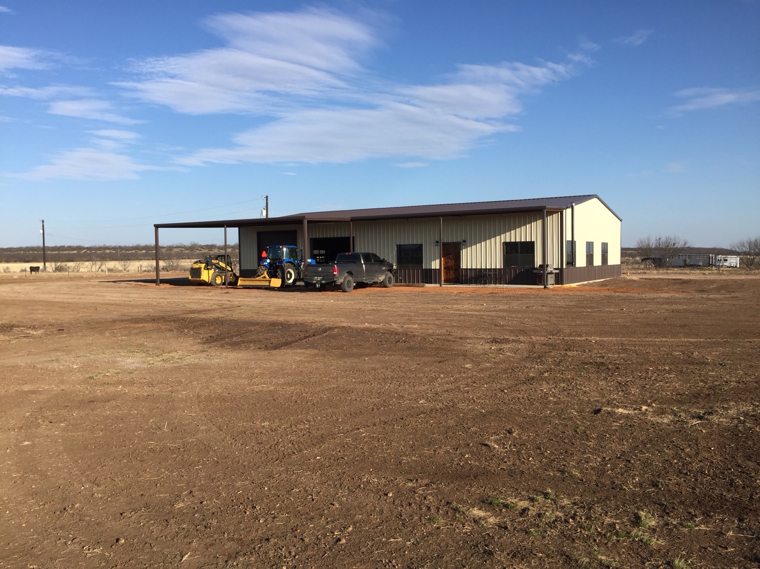

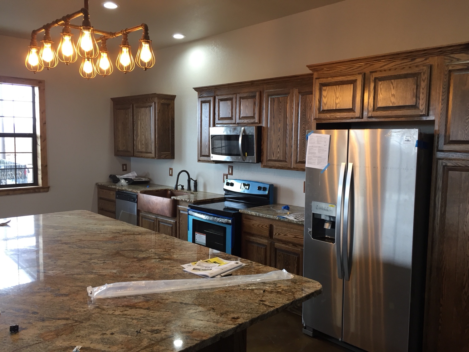

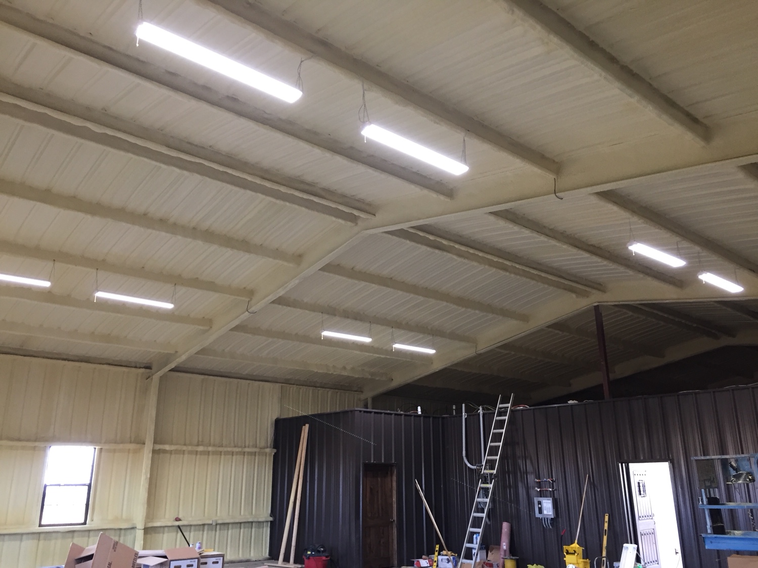

4000sqft Mueller Steel building...2000 living/2000 shop 3bd/3ba
