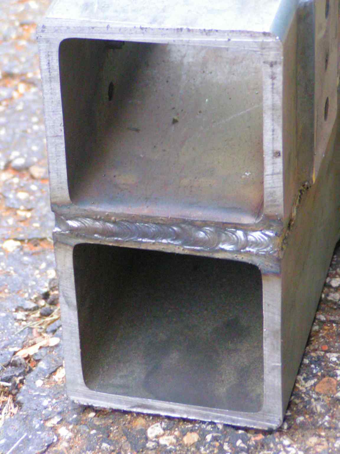

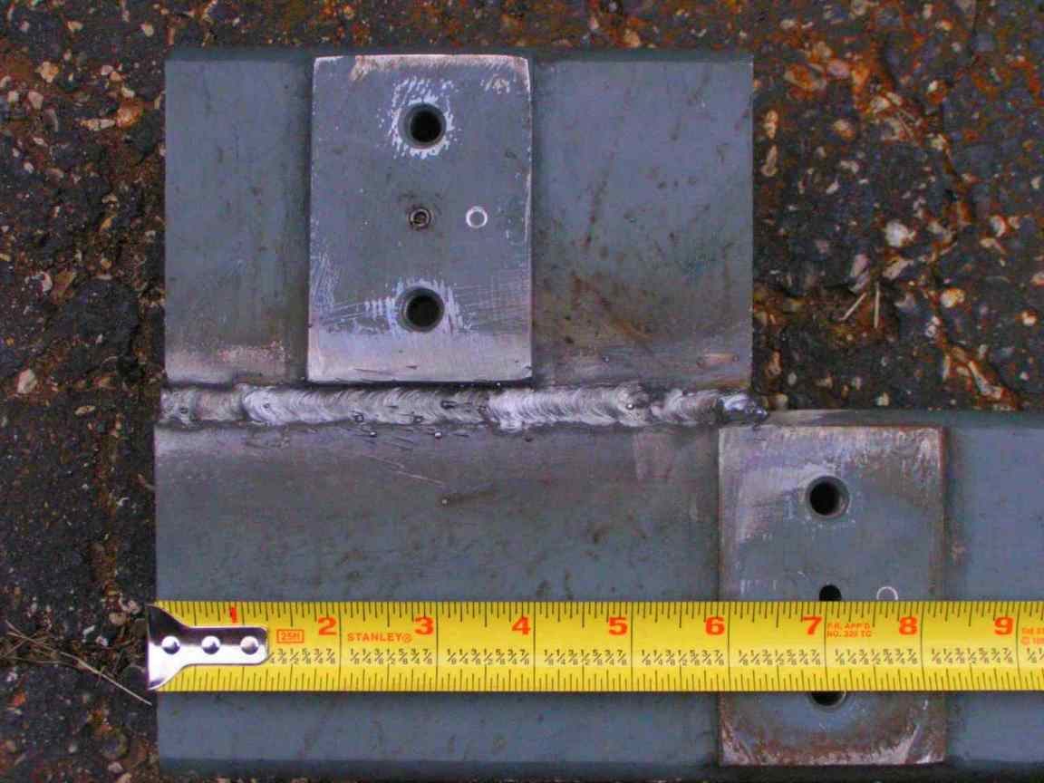

Here is just one picture of the spindle just welded together. The thickness is 3/8, or 1/2 in
Thanks JJ, that was just what I was looking for. I kind of like the way the plates setup the outrigger angle. I will have to look at that guys website again. I think his parts kit is around $999, but it shure would save a bunch of fab time. Are you still working on the plumbing or have you got to use it any yet? I would be interested to hear how it works for you.
Thanks
