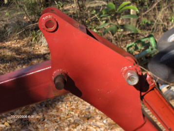

   / Build A Backhoe For PT425... It Could Happen #136
David, This is a picture of the dipper arm where the two cylinders are hooked up.

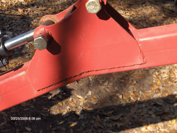

   / Build A Backhoe For PT425... It Could Happen #137
Picture of the center joint. I just cut a wedge out of the box tube, bent it to the correct angle and welded it together.

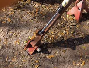

   / Build A Backhoe For PT425... It Could Happen #138
David, You didn't say if you were going to use hydraulics for the stabilerlizer legs. Here is a picture of the ones I am using. It might save you bucks in the long run by not using the legs, and use the PT for stabilization. It would also save on two more valves.

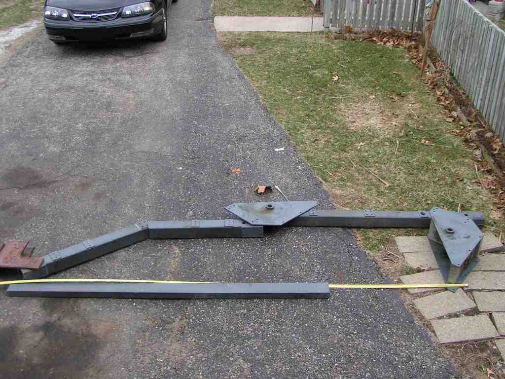

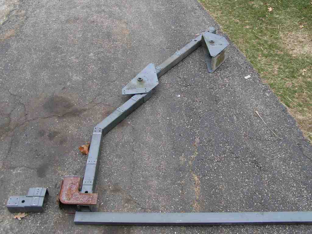

Attached is what I have so far. This picture shows it in the UP position. The "bucket" is about where it will go when the dipper arm is trimmed to length. And NO, I will not be using the patio blocks for the final construction of the bucket. They are just for mock up. /forums/images/graemlins/tongue.gif The bucket looks like it will clear 8' high from ground level when curled under a bit more than shown.

#140
Attached is picture of the reach position. Looks like a 10' reach. Can anyone imaging how easy it would be to tip the PT forward with that much steel hanging out that far? PT Pucker, here I come! /forums/images/graemlins/shocked.gif This is proabably a good reason to stick with the plans and make the frame long, instead of short. That way, I can counter weight it, AND some day, if I want to add an engine and hydraulic pump, I can use it as a stand alone unit and tow it behind a car if needed. I can always shorten it up if it looks like the PT can take it.
