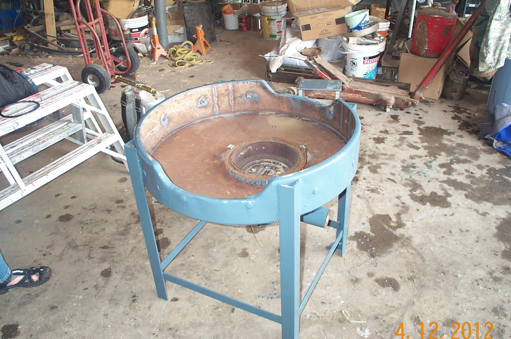

I have had some budding blacksmiths visiting this week at the farm, and they were in need of a forge, to learn there skill, so I built them one to use and to take back home, with them. two of them have had an interest for a number of years, and this is there first try at it and loving it,
Basically a brake drum forge, fire pot, and copied a lot of the Buffalo forge that I have, for the basic design,
We tried it out the next day, and worked beautifully.
It looks like it should give them years of service if taken care of at all,
there Dad said he would come up with a fan for the blower, most likely a electric that is variable speed or a slid over the intake

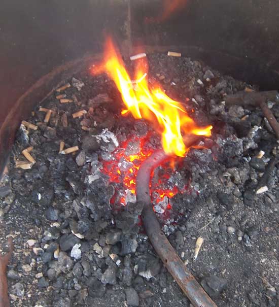

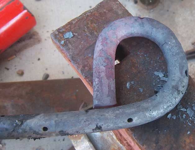

I do a little blacksmithing. As a kid (4/5) I got to turn the crank.
In 1962 the company I was working for needed a forge. We built one out of a 55 gallon drum. Used an old vacuum cleaner and a rheostat for the air supply.

Very nice. How about explaining to us dummies how that works. What fuel? How long does it take to heat that rebar until its hot enough to work it? I think you could make some great things with it. Do the kids have any plans to create something?
/ Budding Blacksmiths
#13
It is jsut a old fashon type coal forge,
Light the coal, the blower adds oxygen, and makes the fire hot,
put the iron in the center of the fire and in a few mins your iron is hot enough to work, I did not time it but in jsut a few mins it will be a bright red,

I've got one of those brake drum forges- used to use it as my portable forge for demos at crafthows. I've got an old cookie sheet surrounding the drum for my table surface and 1/2 rod welded to the drum for legs- Very stable when I sink it into the ground.

Made one myself a few years back out of a F-450 front brake rotor. Fits perfect in a 14.5 mobile home rim.
I first used a shop vac for a blower, but the whiny motor got on my nerves. Found a 140 cfm squirrel cage blower on epay, and it's a real pleasure to play now..!! Air control is just a simple swing waste gate on the bottom.

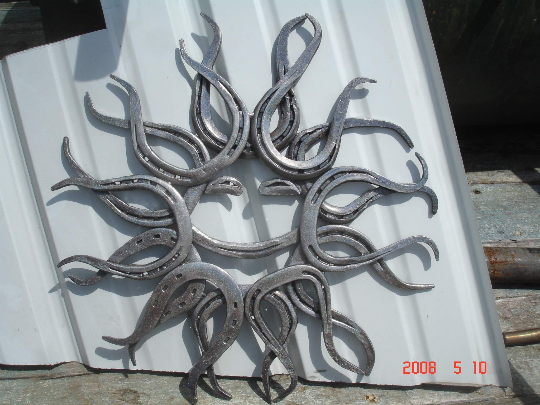

I like to make things out of used horseshoes... Here's one of my little projects.

I like that- nice collection of shoes, even the grooved ones for the trotter - wow!! Nice piece of work.:)
