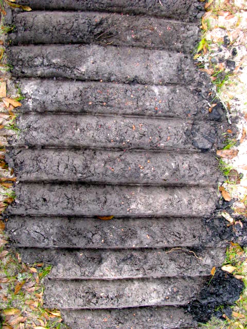

Clover is a very small seed.
Next year take one section and sow the Buckwheat and Clover without dragging afterwards. Buckwheat, in my experience in Maryland and Florida, will always germinate if kept moist. Very small seeds almost always need some light to germinate. If covered, they will not germinate.
A Cultipacker is a specialty implement for rolling in seed without covering. Ridges provide a moisture reservoir for at least half the seeds.
The germination of many medium and large size seed is improved by dragging as you did.
Photos: Everytfhingattachments.com Cultipacker.

Yes...don't have one. It did not occur to me that I perhaps covered them too much.

Thinking back about this, I think the by far biggest problem is lack of moisture at the right time.....AND....I covered up the seeds way to much.
From reading about a cultipacker....I'm going to be on the lookout for one, but bet they are going to be hard to find at a reasonable price.
