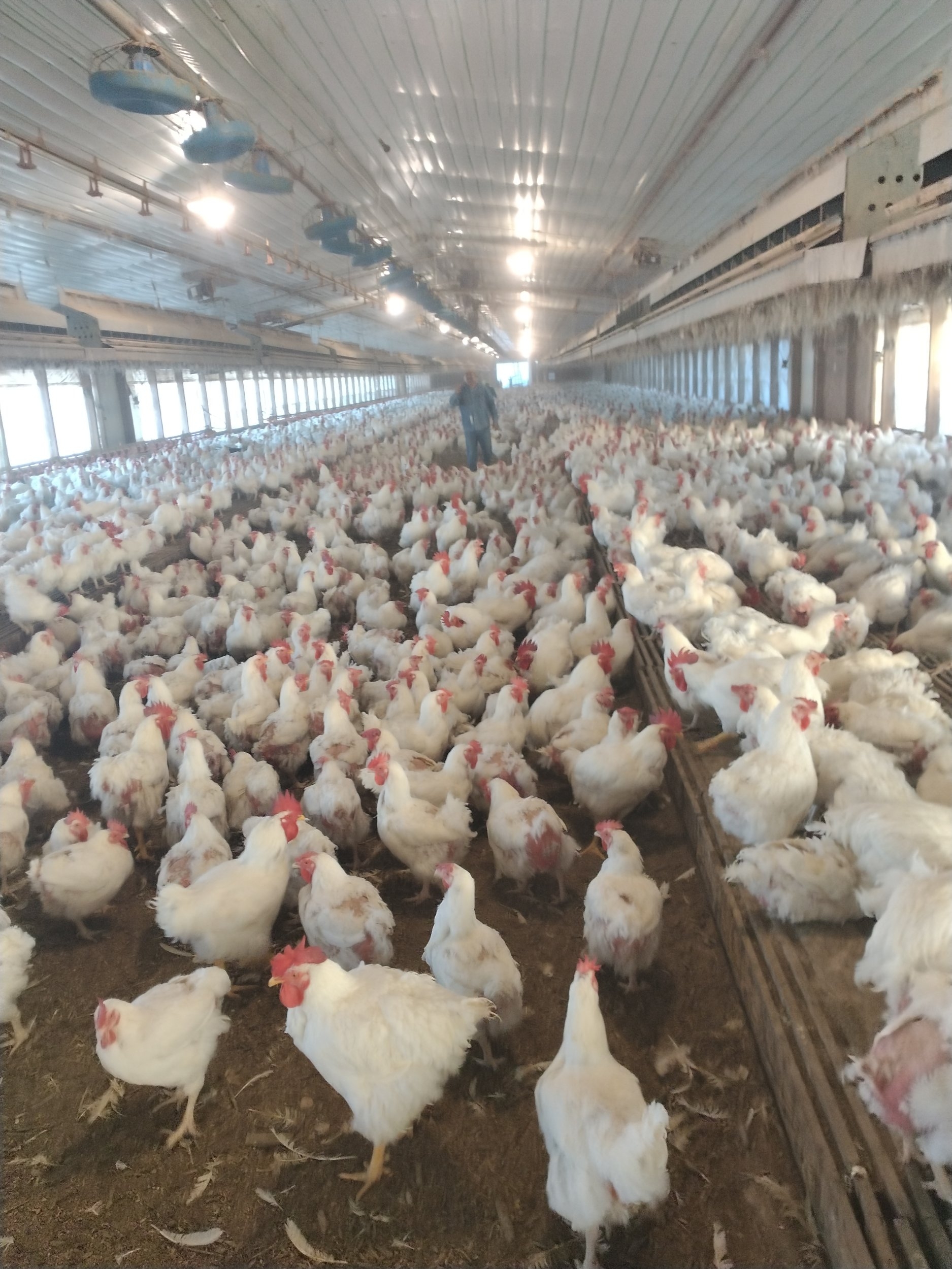

Move slats in a chicken house. 4 clutchings per slat minimum. Have to move these slats to other side , clean this side, put slats back, put other side on top of this side, clean other side out, then put those slats back. Over 100 per side, four houses. Some farms have six houses. Never had a hydro tractor. I did use a hydro lawnmower once.
