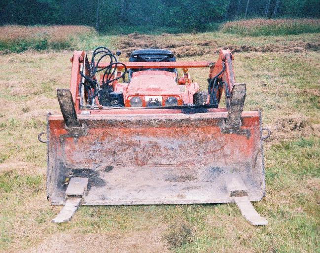

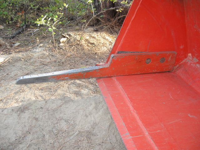

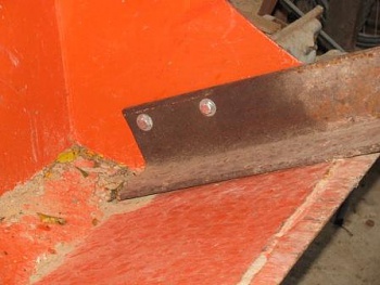

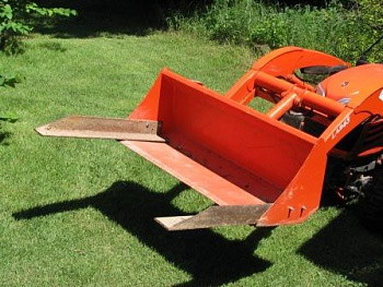

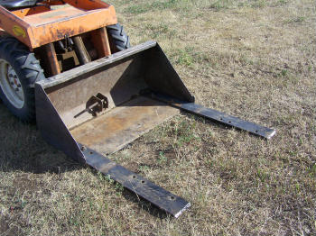

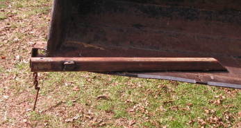

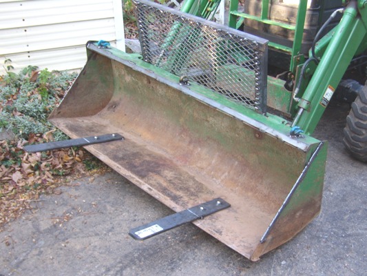

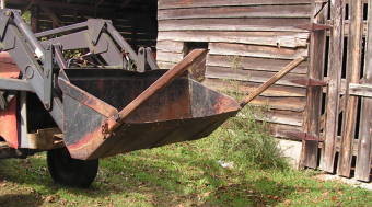

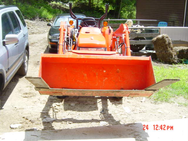

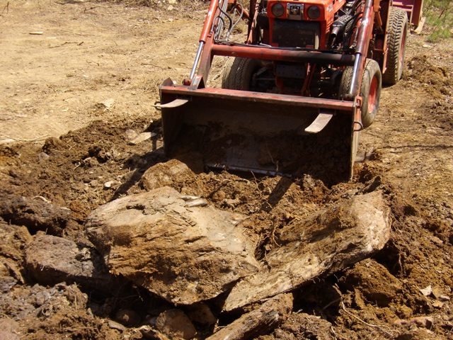

I've collected a bunch of photos of what I think of as tusks. Usually shorter and usually bottom corner mounted.
Probably most are from TBN, but I didn't record whose they were.
Bruce
aloader02.jpg aloader01.jpg AngleIronforkoutside.JPG AngleIronforkinside.JPG DSC00013.JPG AngleIronbucketforks.jpg DSC00012.JPG
/ Bucket Tusks?! #4

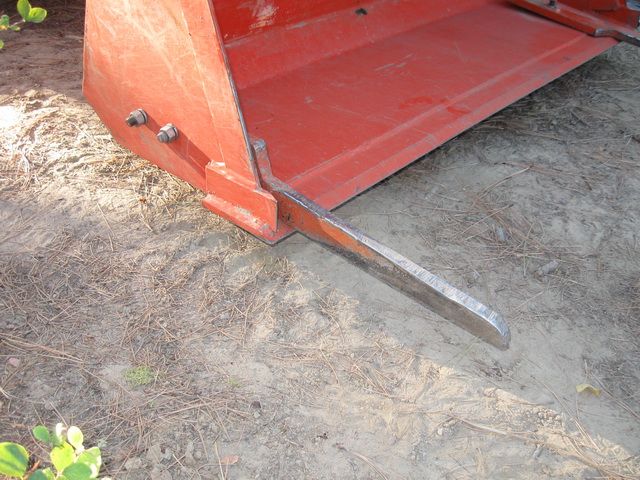

more
IMG_3747_resize.JPG IMG_3748_resize.JPG otherprojects3.jpg PB040001.JPG Spading garden 2.JPG Spading garden 3.JPG springfork.JPG

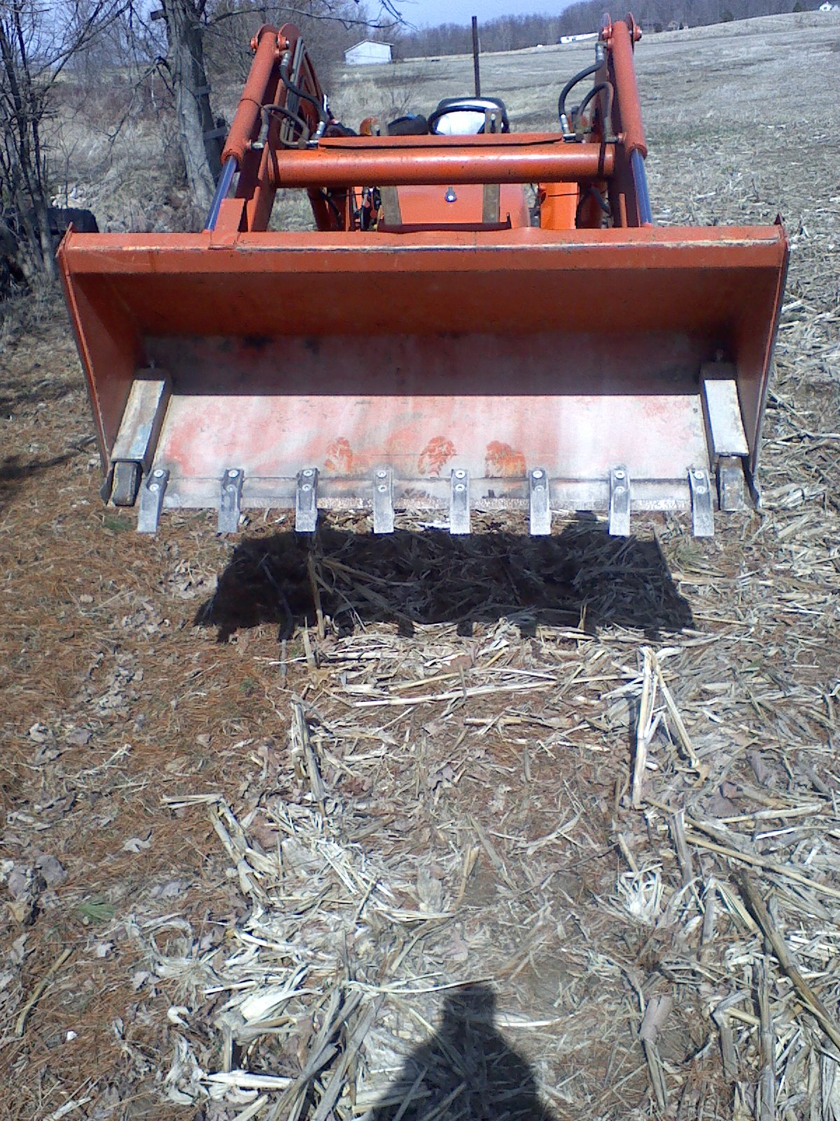

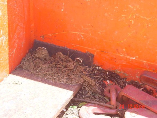

Get some ~12" long pieces of 2-1/2" x 2-1/2" angle. Weld to the bucket bottom, and bucket side. This forms a 2" square pocket to insert the fork in. Then a single bolt, threaded only into the tube, behind the pocket to keep the fork from falling out.
I suppose a piece of 2-1/2" square tube would also work in similar fashion. Let me see if I can find some pics of mine, If not, I'll take some.
/ Bucket Tusks?! #6
Best pic I can find. You can see the angle forming the square pocket, and the bolt in the back behind the pocket that holds the fork in. What is in there now are just "stubs" to keep the dirt out so when I do need to put the fork in I dont have to pound out a bunch of dirt. The actual forks look just the same, only stick out ~20" from the edge

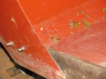

Something like this works ok-ish, two 1/2" caseharden bolts in both with a lip that rest on the bucket cutting edge, when I take them off, I put two 1/2" x 1/2" back in the bucket on both sides to protect the threads. I also have two longer forks for pellets, they are clamp on's, actually I have several at several lengths.
But the most important thing is the upper arms to keep logs from rolling back towards operator, mine are pined on.
