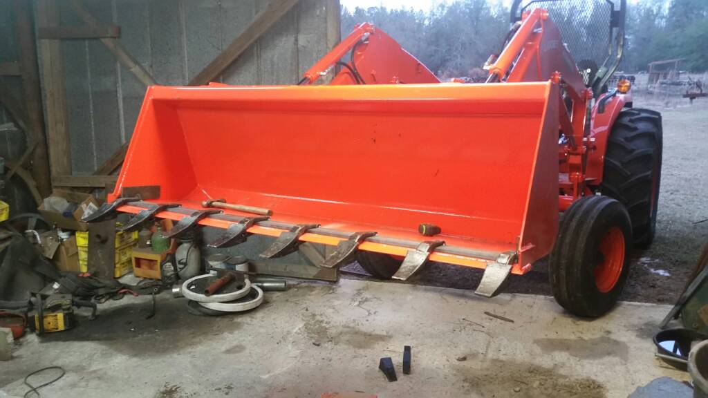

Looking at a used 72" fel bucket to weld some 23tf teeth on, I've found anywhere from 6 to 9 teeth on 72" buckets. Just wondering what others have on this size bucket? Also anyone tried the twin tiger tooth, I see most are using the standard digging style.

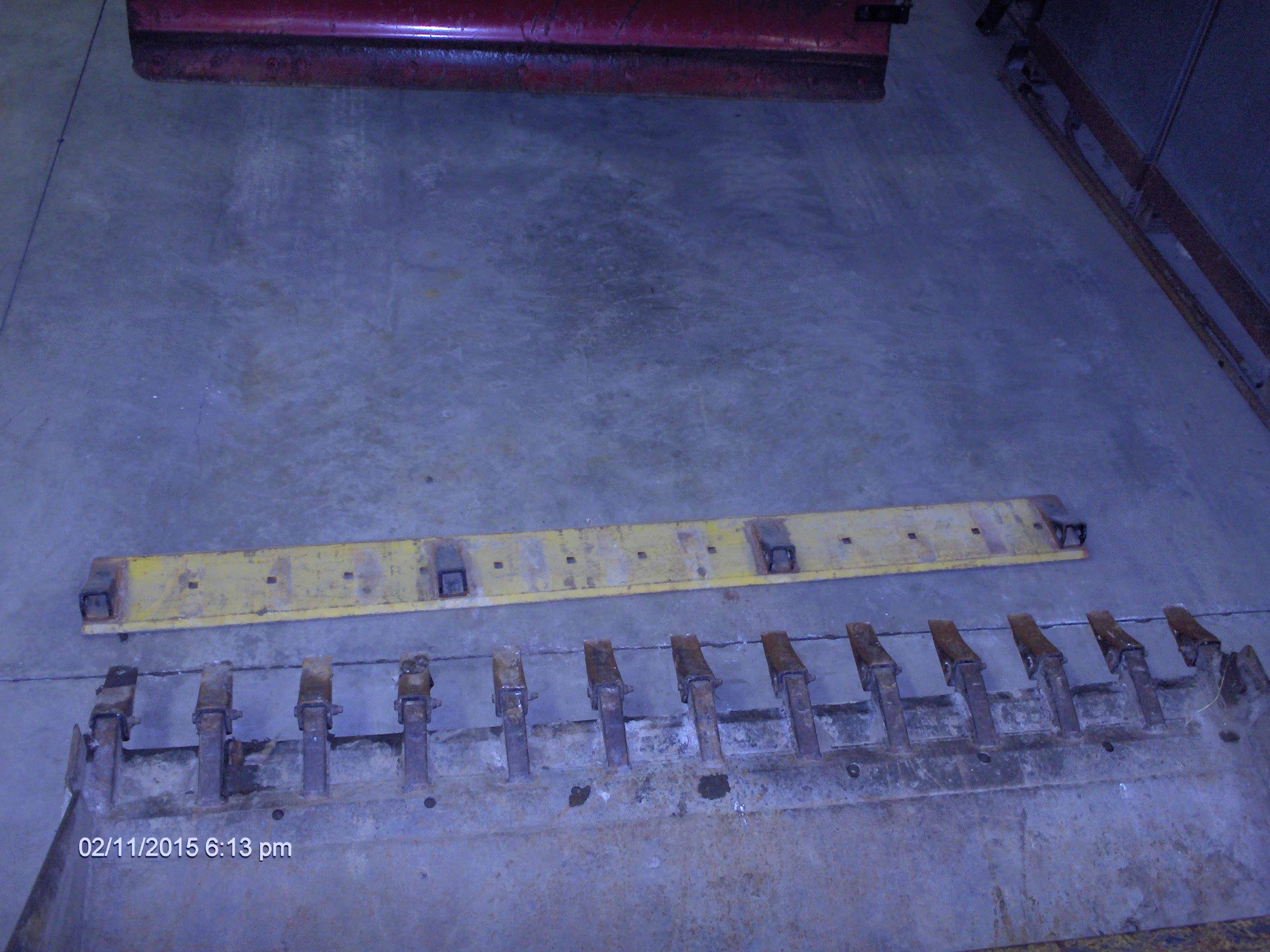

countrybumpkin, it's been my experience that more teeth are better, new teeth are best. here is a photo of an 84" ctl bucket I had 13 teeth added to along with an additional cutting edge for strength. The cutting edge in the photo (yellow) with 4 teeth welded to it is a bolt on smooth edge so I can use it for snow or street cleanup. I remove the corresponding teeth from their shank on the bucket, slide the smooth edge on, put in bolts. I don't have any experience with tiger teeth. I have seen them on hoe buckets where the digging was UGLY, not where I would want tires. lt190bbolt on smooth edge 006.jpg

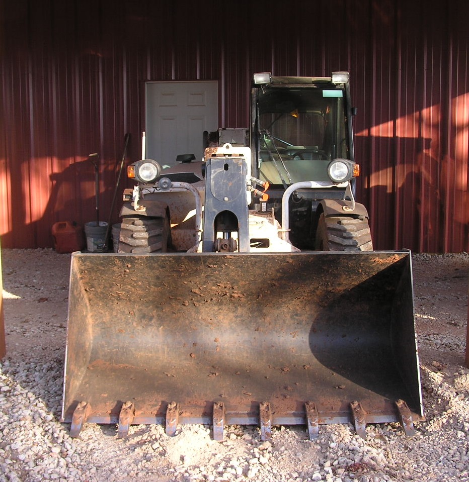

The 72", one cubic yard Bobcat bucket has 8 bolt on teeth.

Ok thanks everyone, 8-9 is what I'll probably go with, I haven't really decided on teeth type still, may just stay with a standard digging tooth.
