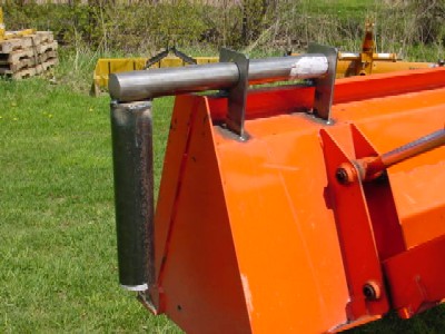

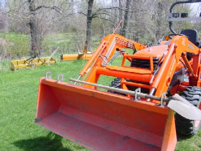

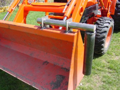

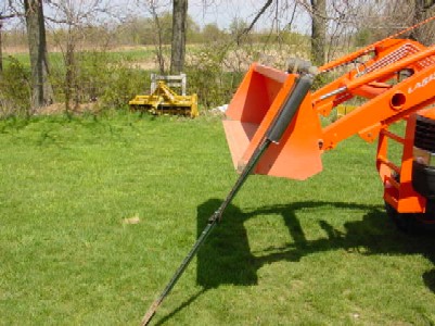

I added some tool holders to my bucket today. There's four altogether, made out of 1/4" plate. Here's two of them being used to hold a shovel.

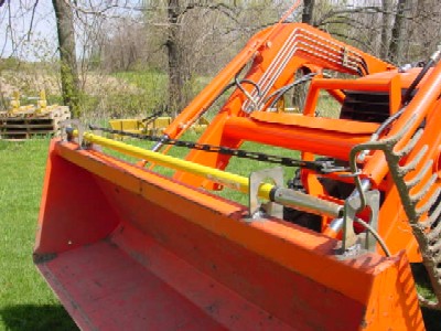

Here's a pic showing the versatility.... holding a rake.... shown with optional BS (bungee strap).

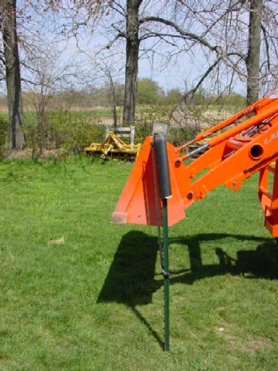

Actually this is the idea I had a month ago or so for pushing fence posts into the ground. Check it out.

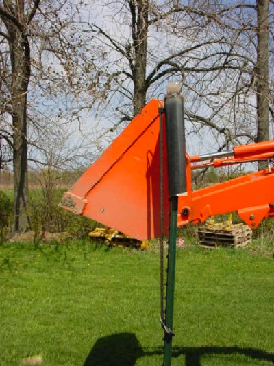

From the rear. You can see I welded to the upper lip of the bucket and the top of the bucket, so it should add quite a bit of strength if I want to hook a chain onto the lip or through the brackets.

Here's one with a T-post hooked on with the bungee.
/ Bucket mod
Lifted into the air.

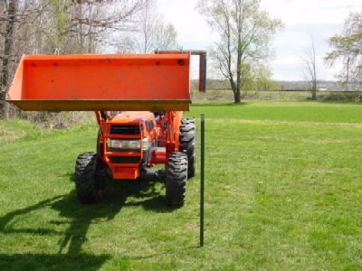

Hanging nice and plumb. I made the receiver big enough for chainlink posts.

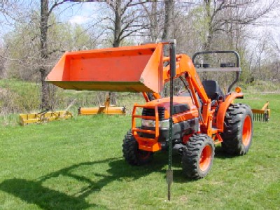

/ Bucket mod
Pushed into the ground. I went in a lot further than I usually hammer them in.
/ Bucket mod
#9
Whalla! It's as plumb as you can get the tractor side to side and stayed pretty plumb the other way, too. Putting the snow fence up this year should be a breeze /forums/images/graemlins/cool.gif

/ Bucket mod #15
I like it! A very simple solution to a problem we all have.
But how do you carry a shovel with a "D" handle? I can think of a couple modifications that would suit MY needs, but you've certainly given me something to ponder while I think about my next round of modifications.

/ Bucket mod
#17
For you, Bob. Use optional "BS" to secure in place /forums/images/graemlins/grin.gif /forums/images/graemlins/grin.gif /forums/images/graemlins/grin.gif
It's kind of funny how my only D handle shovel fit right in there, though... Sometimes things work out without trying...
Actually, I like tossing my shovel and two rakes into the round cross-member between the FEL arms, but then I never have anyplace "skinny" I need to get into and the ones I use the most don't have D handles.

/ Bucket mod #18
Freds, great innovations!
Where I am, I hit rocks when driving T posts, thus can't use an off bucket center driver. I do use a sleeve of pipe over a T post centered under the bucket... takes a buddy to hold it in position... and the length is set so that when the bottom of the sleeve hits the ground the post is at the right depth. The full length sleeve prevents bending/breaking when a rock is encountered (usually) and allows a little "pounding" on the T post with the bucket bottom. I put extra weight either in bucket or on front to assist in down pressure before front wheels come off the ground... and they WILL come off the ground when solid rock is hit.
