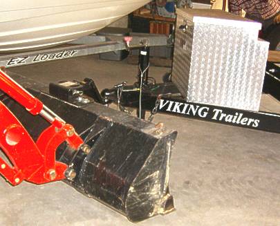

I purchased a bumper hitch reciever from Harbor Freight for $19.99, and bolted it to the center of my bucket with 4 5/8" X 2" bolts.
Then I purchased a 6" drop hitch to go into the reciever and topped it off with a 2" ball. I move my trailers around with it all the time, but it is a challange backing up and steering the trailer to the correct position that you want. Kinda like getting used to driving a forklift with the steering on the rear. LOL
C-YA RL
Here are a few more close up shots I took this last weekend.
C-YA RL
