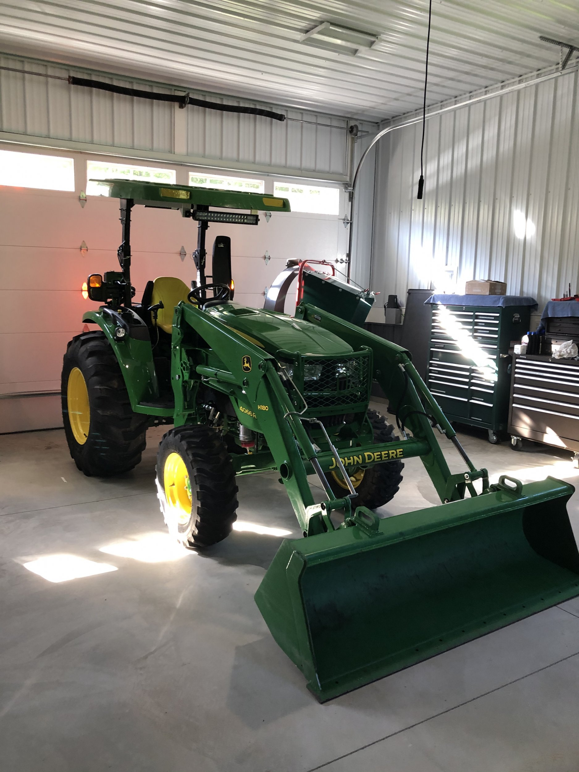

I was on my 3rd compact tractor before really ever using my bucket level indicator. I modified mine in my 4066R and put a bend in the rod so that when adjusted correctly falls into then guide rod bracket when the bucket is level. Easier to see than describe. (Pic attached). Kudos to those that can do a really good job of grading with a tractor, especially a newer one. It’s hard, especially when compared to doing the same with a compact track loader. You absolutely cannot see anything on my 4066R. You need some point of reference to know when the bucket is level.
