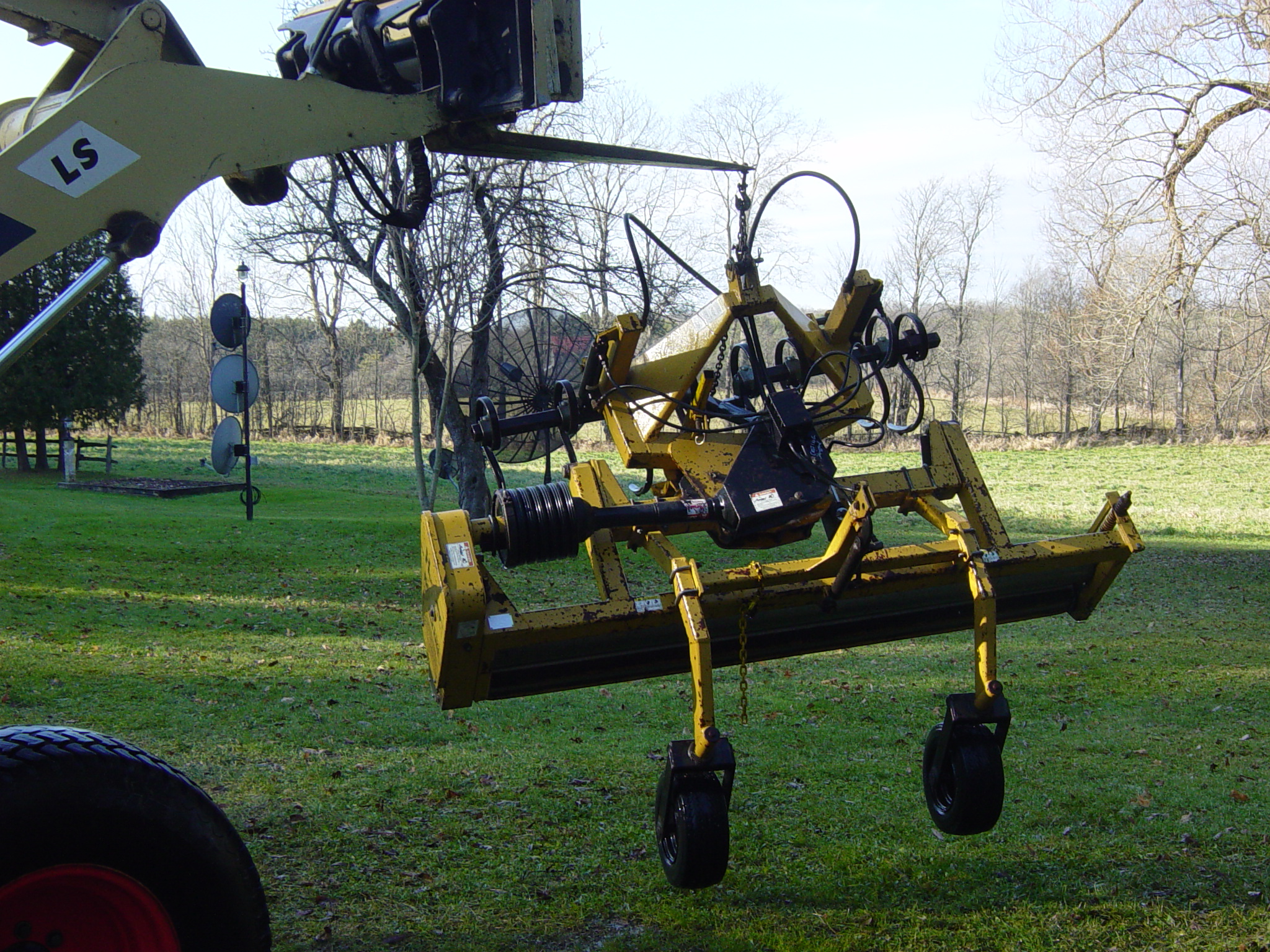

Works best if the gears are nice and greasy.
Trust me. No such thing as a good idea. Just some things tht actually turned out well, in the end.
I put hooks on my loader bucket a quarter of a century ago. And I guess, that idea was had long before I was born.
AND, I do stuff like this: DSC04625.JPG
Everything using common sense.
AND, I do stuff like this: View attachment 604718
Not sure how to get rid of the image below.
Is that 4 satellites in the background? Free service :laughing:

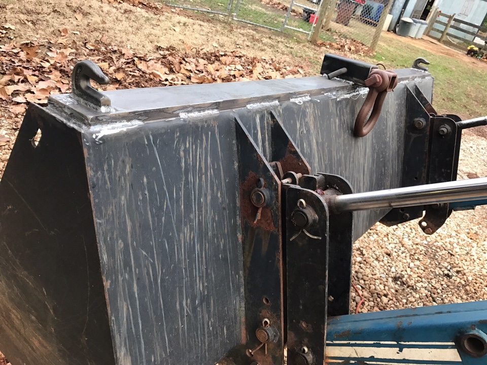

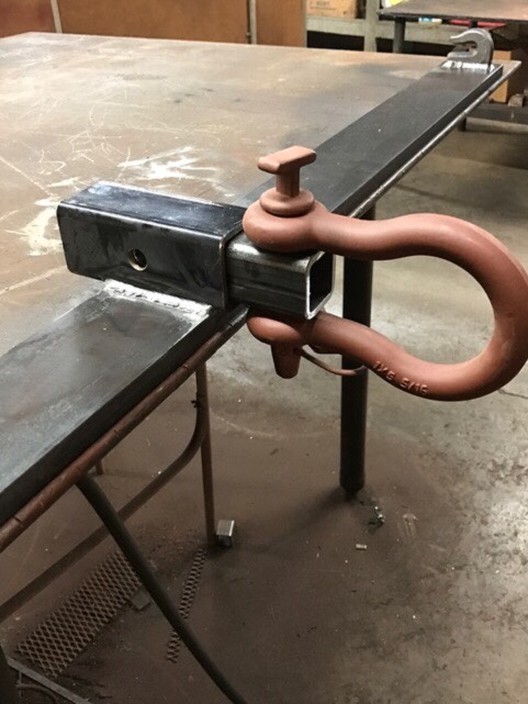

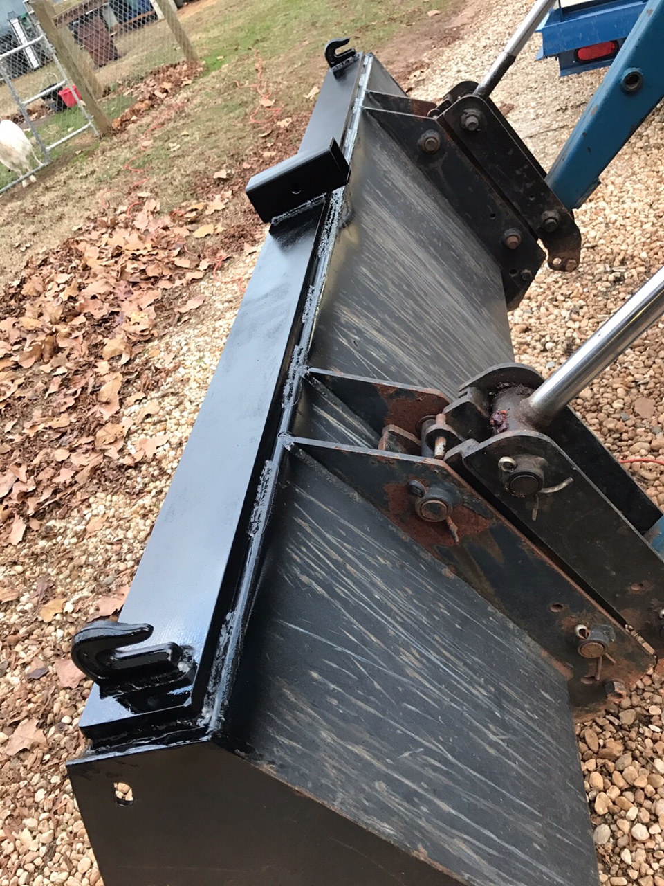

Here’s what I did to mine a couple years ago. Welded a 3/4” thick flat plate to the top for support. The clevis can be installed backwards and is out of the way. I use it for chaining tractor to trailer mostly.
