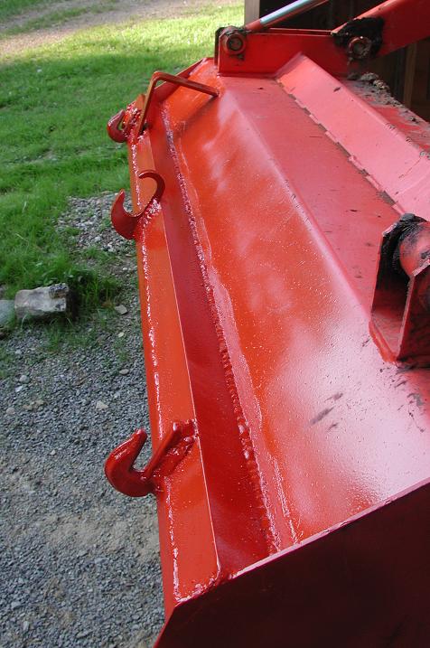

I put a slip hook in the center and grab hooks aligned with the arms on each side. THe slip hook was because I figured i could use a strap or rope with it if I had reason to. I usually use chains though. Chains all the time really, so I could have used three grab hooks I suppose.
I tend to pull/lift from the center most of the time. I run the chain through the slip hook and into one of the grab hooks.
Attached is a photo of the way I did it. If you do a search you will find a lot of photos I think.

One additional thought is that you might have them weld a little reinforcing to the upper lip of the bucket to support the load on the hooks. Standard buckets can get a little distorted if you start pulling hard on the hooks.
   / Bucket hooks #7
<font color="blue"> One additional thought is that you might have them weld a little reinforcing to the upper lip of the bucket to support the load on the hooks. </font>
Good point. Before I welded those hooks on my bucket pictured above, I welded a piece of 1/4 2x2 angle across the top lip.
That also gave a good place to weld the hooks to, and it makes for a very strong bucket when accompanied by a toothbar on the lower lip.

I was at the dealer this morning to sign some paperwork and I talked to them about the hooks. I'm getting one on each side of the bucket where they'll be reinforced by the bucket sides. They did say that a center hook would distort the bucket under a heavy load because there is no extra steel under it. I'll try with the two and alter down the road. I am getting a toothbar, so that should help strengthen the bottom lip.

My father-in-law has been a welder for many years. When I first got my tractor, I asked him to weld on a hook. He argued against putting hooks anywhere but the center. He did as Henro suggested, and welded a 4x8x1/4" plate to the top of the bucket and welded the hook to it. I know that others have not had any troubles with hooks welded near the loader arms, but I'll go by his 40 years of experience. Besides, the SO likes it when I follow her fathers advice. /forums/images/graemlins/grin.gif
