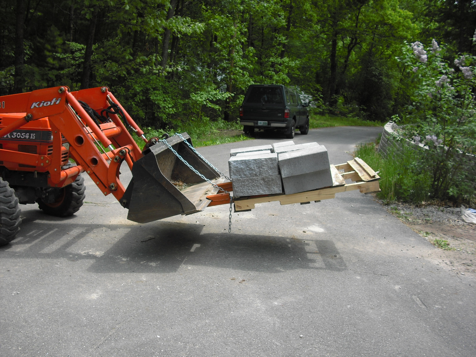

Did you mount a graple onto your bucket or replaced the bucket?
Joel
   / Bucket hooks, should have done it earlier. #22
Joel-D Just wondering how do you fasten your forks on to your bucket ??
Couldn't tell from photo ! !My daughters' friend gave me a set he made looks alot like yours but need to drill 4 holes in the bucket
I've put off drilling holes in my bucket till I seen how others had made there
The ones he gave me are appx 42-48" in length about 12"-15" under bucket the rest out in front .
Thanks
   / Bucket hooks, should have done it earlier. #23
Thanks

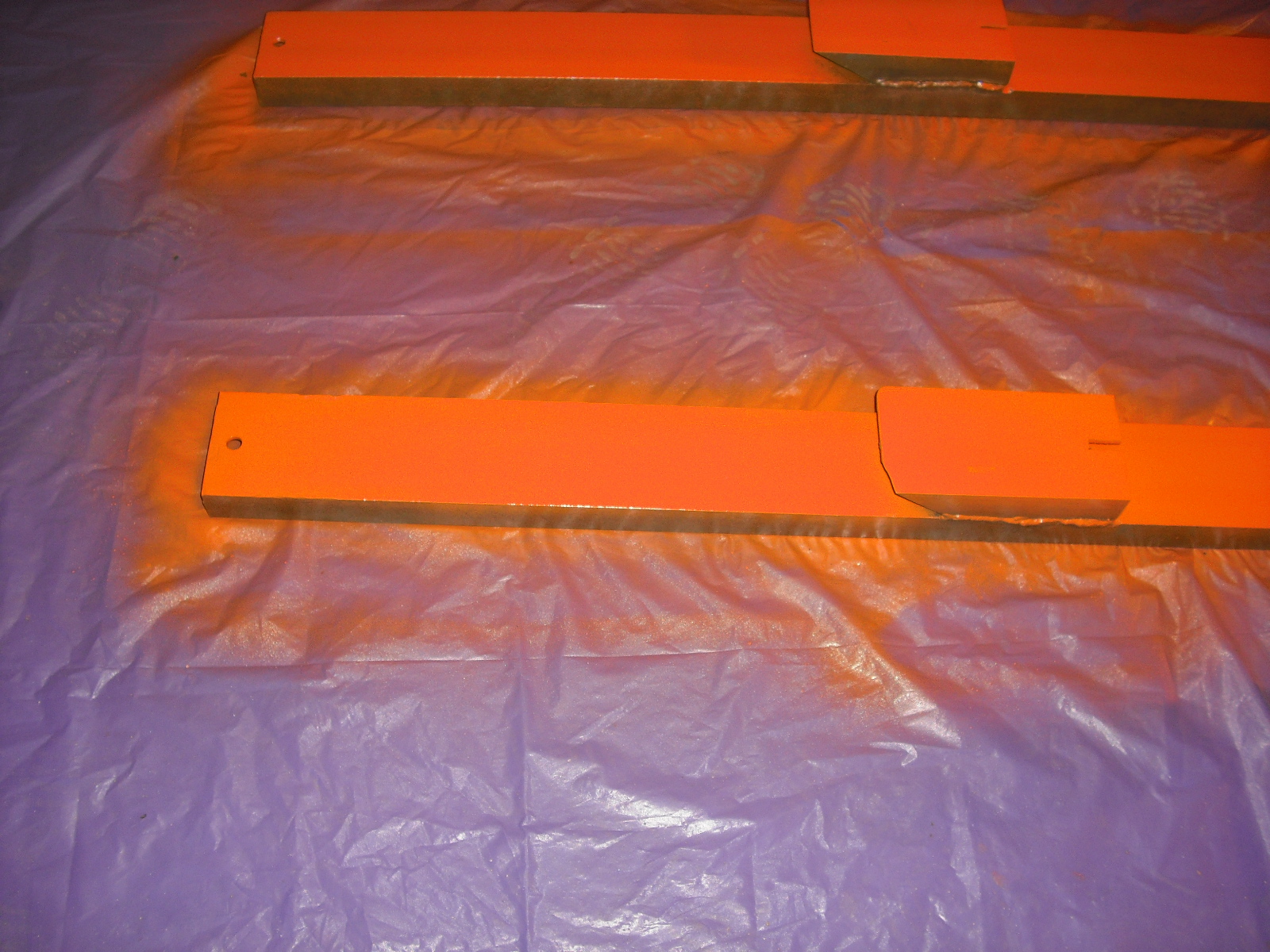

I borrowed the design from one I saw on the web.
Here is a good side view.
The forks go all the way under the bucket and just about but not quite extend past the back. I've got the chain attached at the back and then into a notch at the front.
I'll try to get better mounted pictures.
They really do work great, when I need them to stay put tight I use chain binders.
Joel
