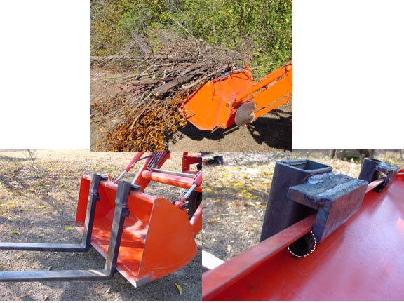

Alan,
Let me suggest you do a search for "forks" or look at my posts and check the one "...show me your forks now let me show you mine"
There are several threads already here re: forks.
I'll be happy to answer any questions you have about my forks.
They are working great. Haul a BIG pile of limbs, dig up small bushes, break limbs off trees/w3tcompact/icons/smile.gif, skin up side of shop/w3tcompact/icons/grin.gif, any number of things.

Thanks RMulkey, those are the ones. I hate to hear they swing out from the bucket though. That might make it hard to dump stuff out of them. I wonder if they could be secured at the bottome somehow to keep that from happening.

From the tractor seat, how do you see the tips of the forks to line them up with the notches in a pallet?
Mine hook on in place of the bucket, and even then they are sometimes hard to see from the tractor seat.
