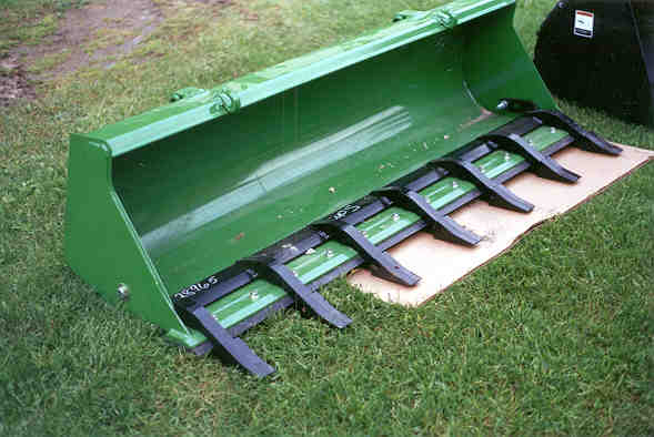

<font color="blue">"...Can this be a bolt on addition, allowing it to be removed and swapped for a toothbar?..."</font>
See both the bolt on cutting edge and bolt on toothbar that's on my JD bucket in the attachment. No need for swapping. Both can be installed at same time.
...Bob
