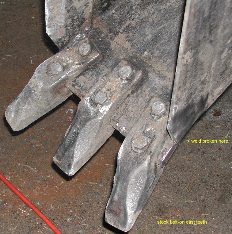

This project has been on my list for a long time. It made it to prime
time when I realized that my backhoe bkt was broken.
I use my b/h for digging up and lifting many rocks, which puts a lot
of stress on the bkt teeth. I have the cast ductile iron (or cast steel)
bolt-on teeth that are seen on most hoes of 7.5 dig depth or less. These
teeth are fairly soft and rather dull. That is OK if your soils are soft and
fairly rock-free, but for me they are less-than-ideal.
The bigger hoes use welded on shanks (aka tooth holders), and replaceable
teeth made of tough plow steel. Just look at the Kubota BH90 vs. the
Kubota BH75. The replaceable teeth are usually either crimped on or pinned
on.
In the past, I could go to my tractor dealer and buy shanks for $15 or so
each, and the teeth for $5-10 each. No longer. In this project I design my
own shanks to fit the teeth commonly sold for box blade rippers. These
shanks are welded to my hoe bkt, and the teeth are tack-welded to the
shanks. I have also designed shanks with the right profile for the Kioti
KL130 FEL bkt.

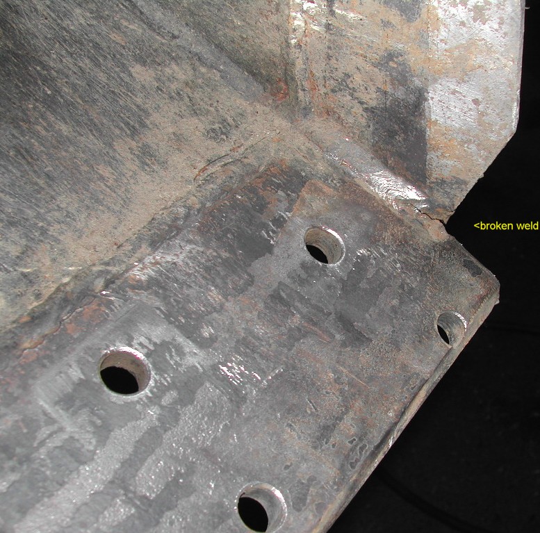

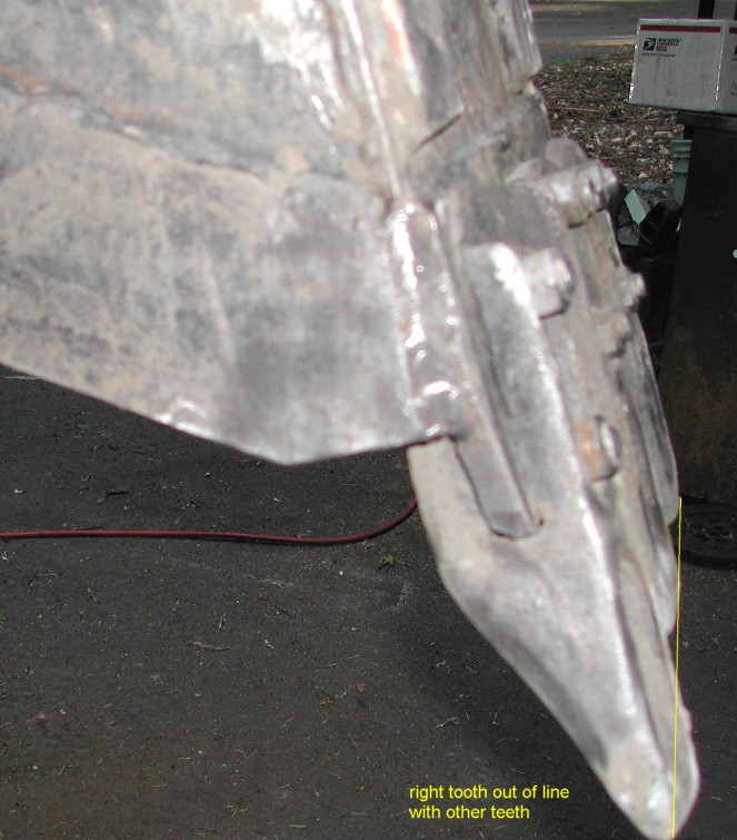

The first photos show my damaged hoe bkt. Welded on shanks will
substantially increase the strength of the corners of the bkt, where the
front cutting edge meets the side cutting edge.

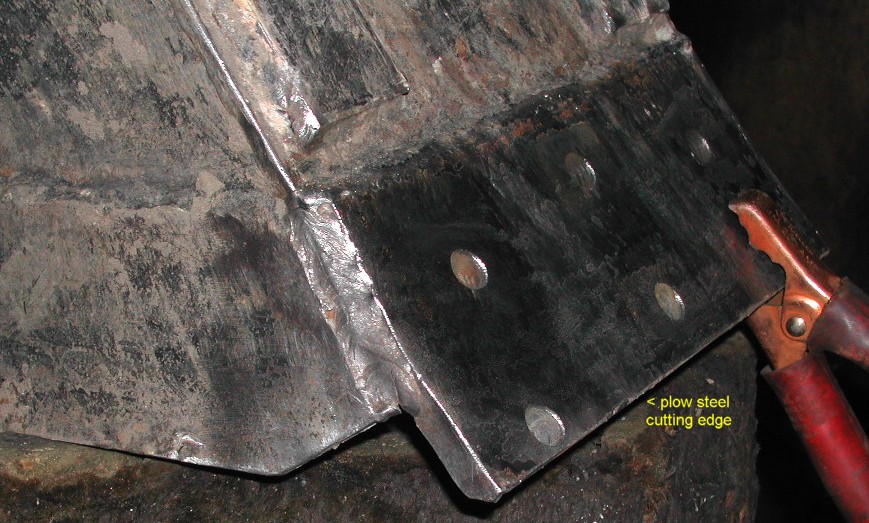

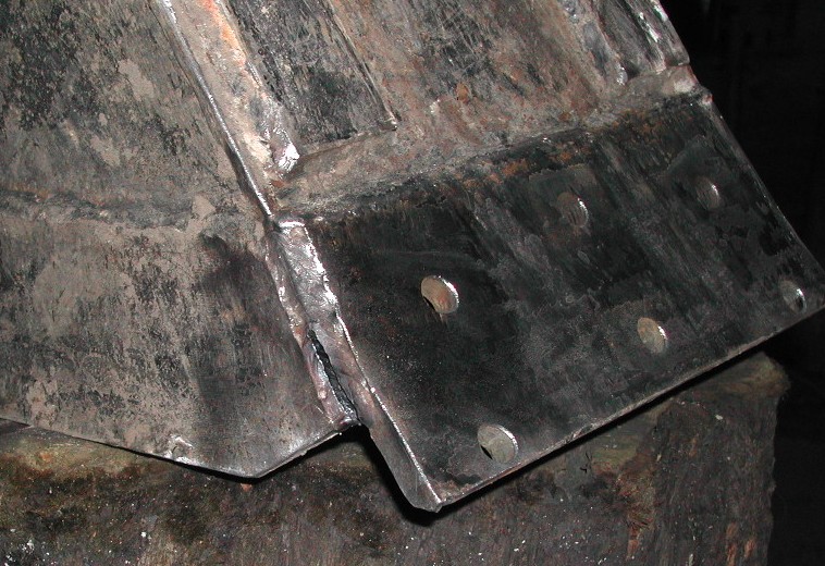

Next I perform the "root canal". I use my plasma cutter to cut out
material along the crack. This will allow me to weld a stronger bead,
and hopefully bend the cutting edge back a bit. The cutting edge that
the old teeth were bolted to is only slightly bent. When performing the
initial weld here, I put a cable come-along between the edge and the
opposite side of the bucket. I also swung my trusty 8-lb sledge hammer
a few times.

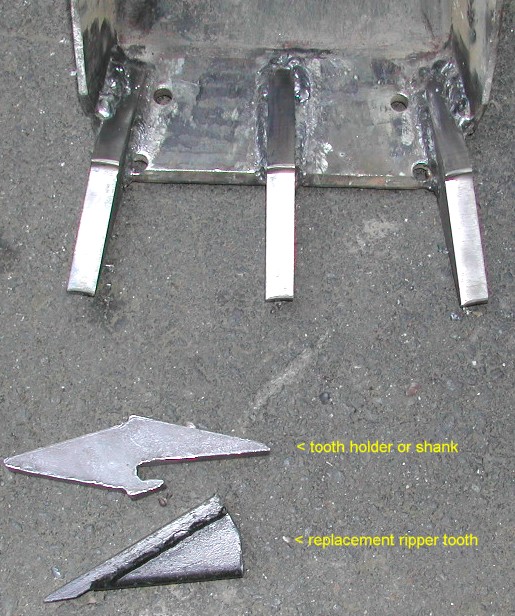

Now the tooth holders. I first made a template out of wood and fit the
teeth onto the holder mockup. The teeth have a 27-degree pocket. Next
I drew a full scale drawing with my CAD program. I printed the result and
compared to my template. When I was satisfied, I emailed the DXF file to
my favorite CNC steel shop in SoCal. And voila, they came by USPS. These
shanks are cut from 3/4" thick A36 steel plate and cost about $15 each for
the steel, the labor, and shipping.
Next: the installation.

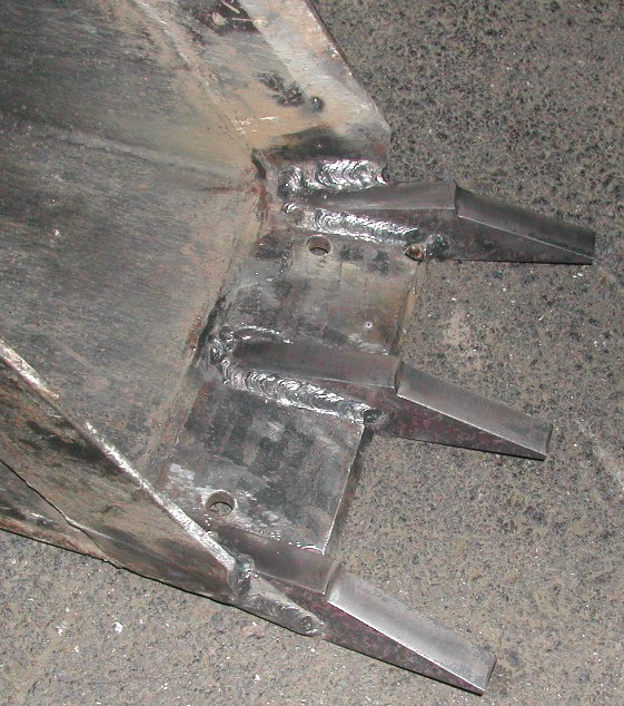

First the welding. I used my 220V Miller Thunderbolt buzz box set at about
110A DC, and I used 1/8" 7018 rods. The important part is the shanks now
provide very strong corners to the bucket. I recommend removing the
bkt for welding, unless you are very good at out-of-position welding. I did
all of my welds horizontally, as I am not.
Also pictured is one of the ripper teeth I used...I bought a bunch from
AgriSupply for a bit less than $5 ea, including shipping from back East.
This one has a 0.42" thick cutting edge, which is definitely better than
the 0.32" I have on my box blade.

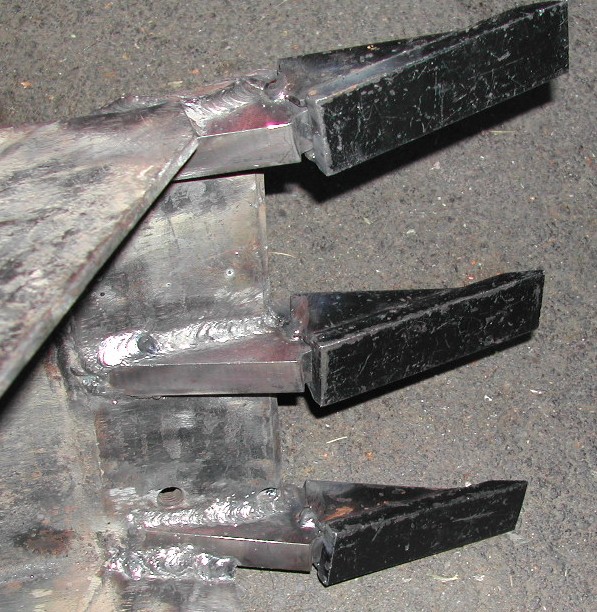

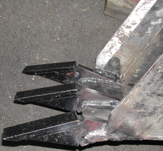

OK, now the installation of the teeth onto the shanks. For b/h bkts, I
like the cutting edge on top. I have seen the other way, too. The second
photo shows how I tack welded them on, close to where they are normally
crimped into a dimple in the shank. I decided to do it this way cuz the
crimped teeth are more likely to be a bit loose and I have had some fall off
ripper shanks. Getting crimped teeth off can be more of a struggle than
cutting my 2 welds with a grinder. I don't expect I will wear mine out,
however.

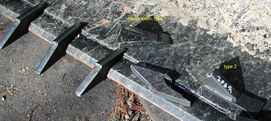

AgriSupply sells 2 kinds of 27-degree teeth....I labeled them type 1 and 2
in the photo. Type 1 I used on my hoe bkt. They are made in India and the
welds look fair-minus. The type 2s cost a bit more but have more steel in
the cutting edge. They are made in Italy. The latter seem to be made a
little sloppier: distortions, weld spatter, etc. The welds look a bit better.
One of the shanks in the photo has been radiused with a grinder to make it
fit in the Type 2 tooth better.
