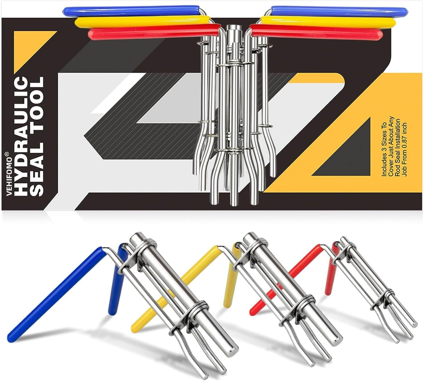

If you do decide to tackle it, do yourself a favor and get a set of these to install the gland nut seal, you'll be glad you did and worth every penny. I got mine from Amazon. Makes it a 30 second job to install the internal seal.

If you do decide to tackle it, do yourself a favor and get a set of these to install the gland nut seal, you'll be glad you did and worth every penny. I got mine from Amazon. Makes it a 30 second job to install the internal seal. View attachment 5017741
I didn’t know about those tools for installing the internal seal thanks!!

You'll love them..!!

Kewl beans... New tool.
