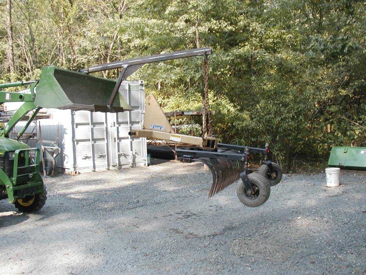

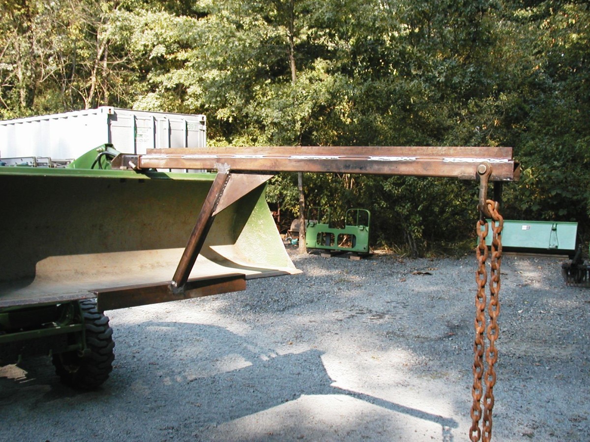

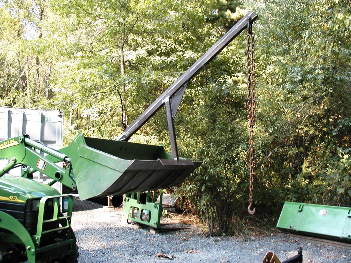

Bucket buddy revisited, made this extended lift pole today, I know I can't move the world with it but I figure 300-400 pounds should be OK, Just enough to be a ball buster saver. JB,

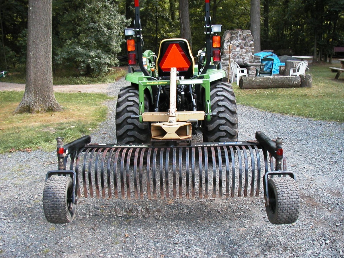

JB4310, in your last picture,were did you get those lift pin bushings for the imatch. I have the same rock rake and it is to narrow for my imatch to hook up to.

JB4310, Looking at your boom pole I see a good starting point for very stable detachable forks as well. Nice job. MikeD74T
Welcome, Mine is a 72" land pride and the stock bushing kit from Deere went right on no problem, You must have something different? JB.
