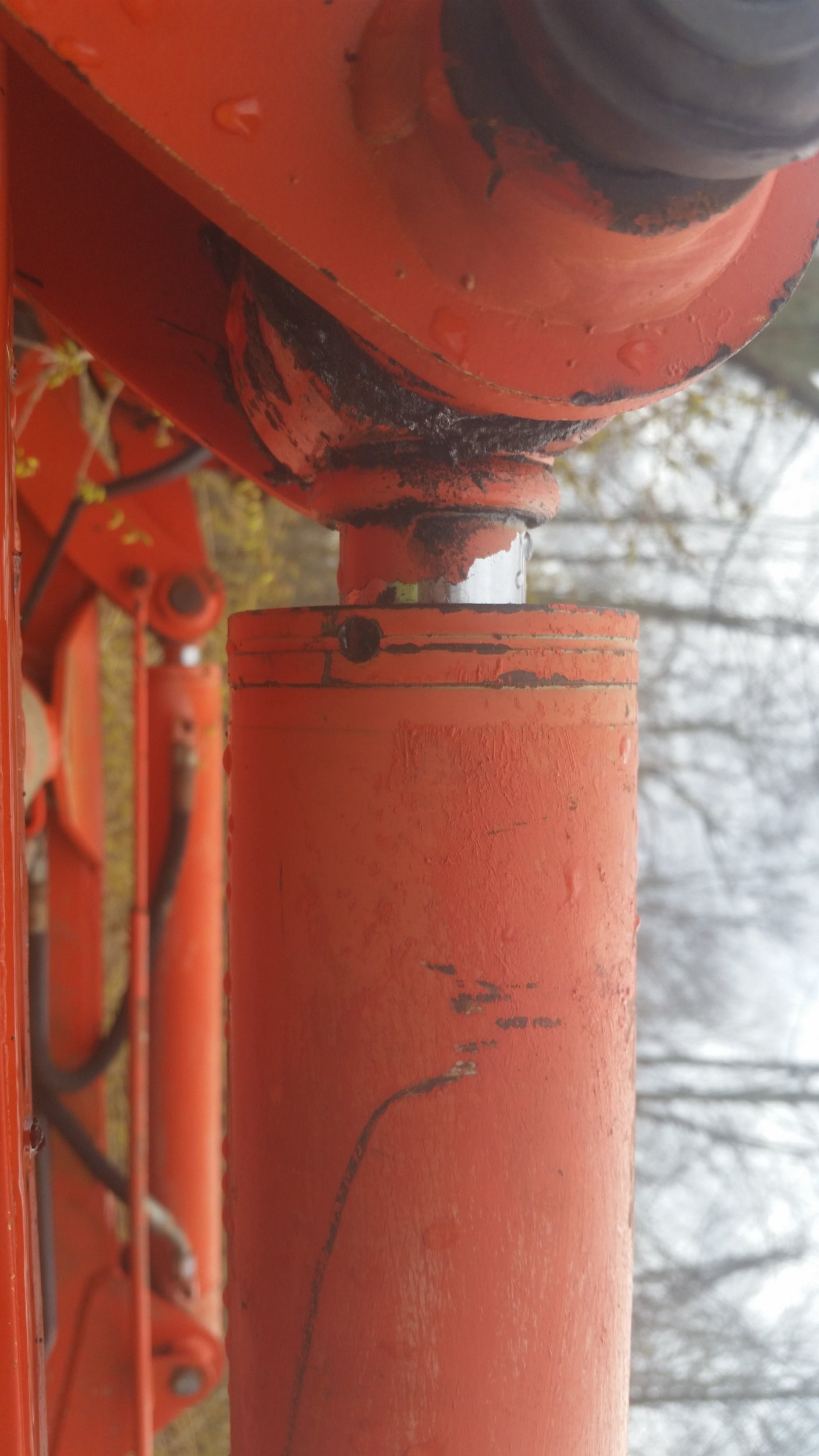

One of my bucket cylinders on the Kubota L48 started leaking and I'm having a tough time finding a wrench to take out the gland nut. All the ones I see are for face holes on the gland nut, my holes are 1/4" and.on the outside of the gland nut. Any ideas?

This is it.

@al b - Look up a Hook Spanner Wrench
/ Bucket/boom cylinder packing #5
Since its a hole....more technically it would be a "pin spanner"
A pipe wrench also works.
Easiest to break it loose while the cylinder is still installed on the machine. No better way to "hold" the cylinder than how its is mounted

I would like something like a gland nut wrench that would catch both holes for a better grip but I can't find it.

Got it loose. This is what I used.
