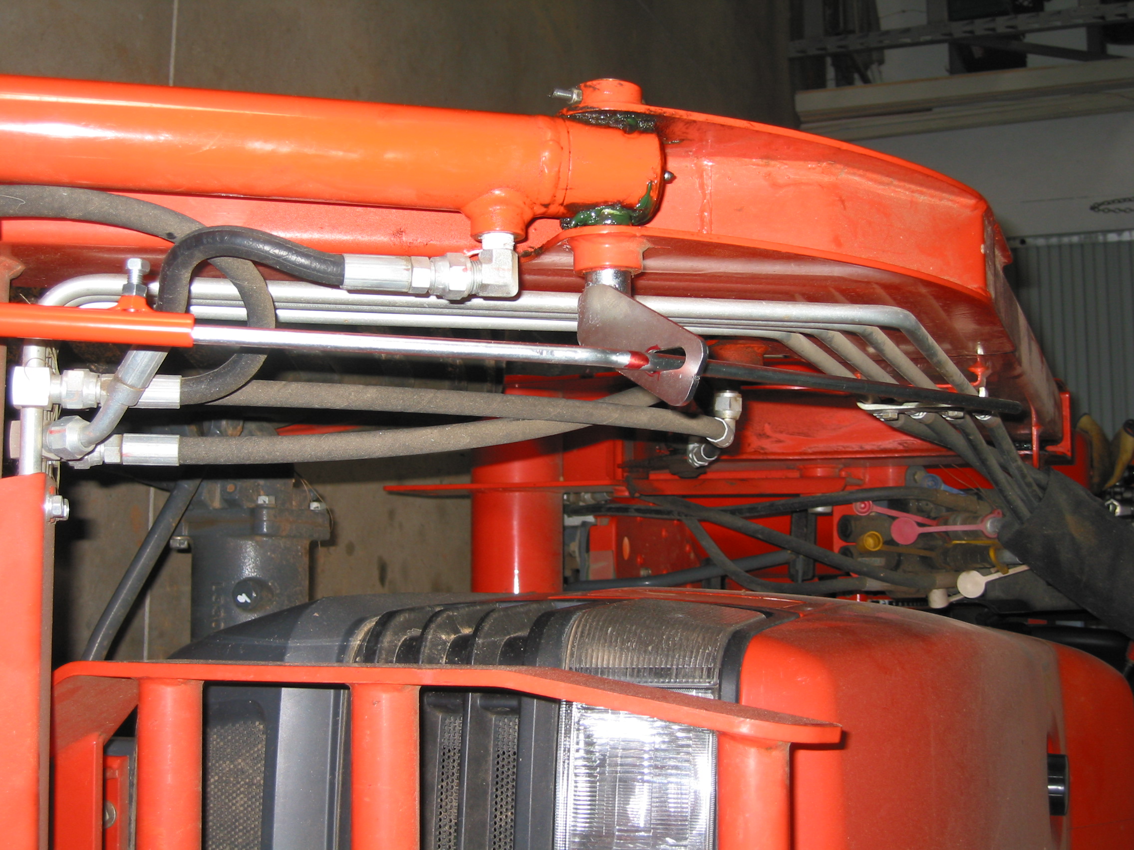

I bought a FEL bucket alignment bar kit based on comments from TBN members. Got the kit and installed it in about 10 minutes - BUT I'm wondering if I have it installed properly. It is almost impossible to see the bar to tell if the bucket is level or? The bar and the bracket are CAD plated. The bar comes straight back to the driver so it's impossible to tell if the bucket is level or not. Is there a trick to marking it, flagging the level mark, or something that makes it easily visible?
Any suggestions would be appreciated.

Silly me! I already knew that "No pictures and it doesn't exist" :) Hopefully the pictures are good enough to see what my problem is. The alignment bar is the diagonal 3/8" bar that runs along next to the hydraulic lines.
Bucket Alignment Bar (1).JPGBucket Alignment Bar (2).JPGBucket Alignment Bar (3).JPG

I always thought that the way those were supposed to work was that as the bucket was level on on the ground, the flat piece of metal that the bent rod rides in would be positioned at exactly where the bend in the rod was.

I believe you could loosen your locking bolt/nut and make adjustments there to get the bend in the rod to hit the slot at the same time the bucket is level and down on the ground. Yes I am sure you will enjoy using it.

Thanks James K0ua!!! That did the trick. Perfect alignment and easy to know that the bucket is level when the bend hit the bracket point.
By the way - the alignment bar is also a very big help when using the forks!
