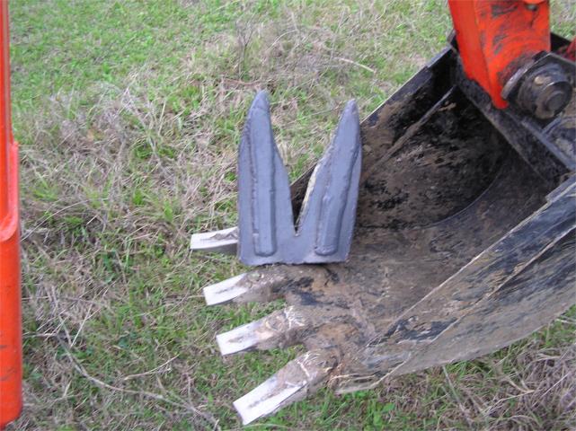

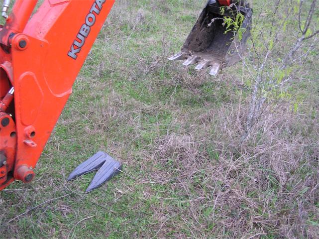

In welding class last year I made some buck teeth out of scrap. The Idea was to slip the teeth on the bucket's teeth, grab the mesquite and pull mesquite up by it's tap root without digging a very large hole.

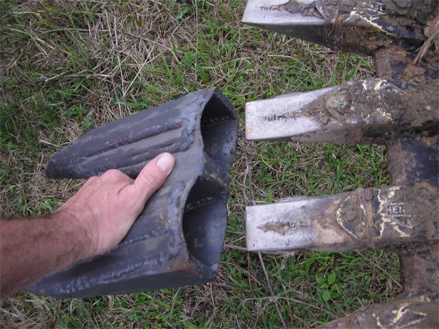

   / buck tooth bucket
#2
They install easy, just slip them on and a couple of taps with a hammer.....

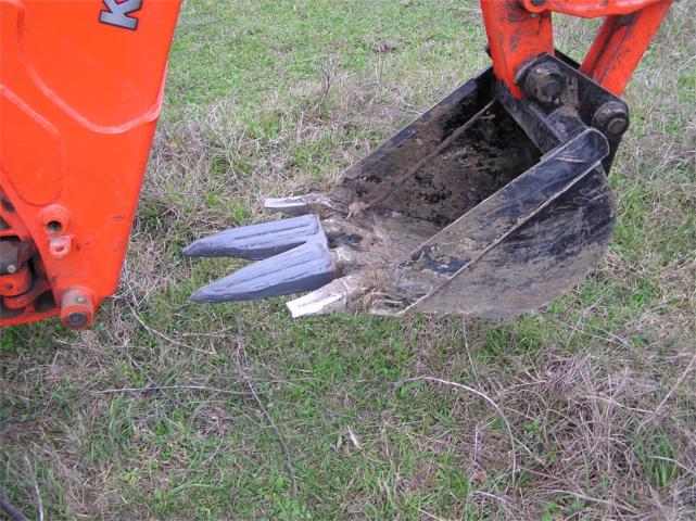

   / buck tooth bucket
They look impressive installed!

Before I continue with the "demonstration" let's back up a bit and take a look at the problem.
With the regular teeth, the limber, long tap root mesquite, would simply slide through the teeth and refused to be pulled out. A large hole had to be dug to get the re-sprouting root out.

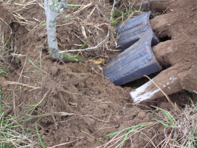

   / buck tooth bucket
Here is a picture of the very fist attempt as I revved up the motor whipped the bucket back and.......
.....the teeth did not move, the bucket did, but not the teeth. /forums/images/graemlins/shocked.gif
   / buck tooth bucket
OK, now that you have stopped laughing /forums/images/graemlins/blush.gif/forums/images/graemlins/grin.gif any ideas on connecting the teeth better or should the idea be scrapped. /forums/images/graemlins/smirk.gif
After getting on and off the tractor several times to put them back on I finally threw them aside and dug a deep hole.
"Buck Teeth II" will have shorter "V" teeth, that connect better.

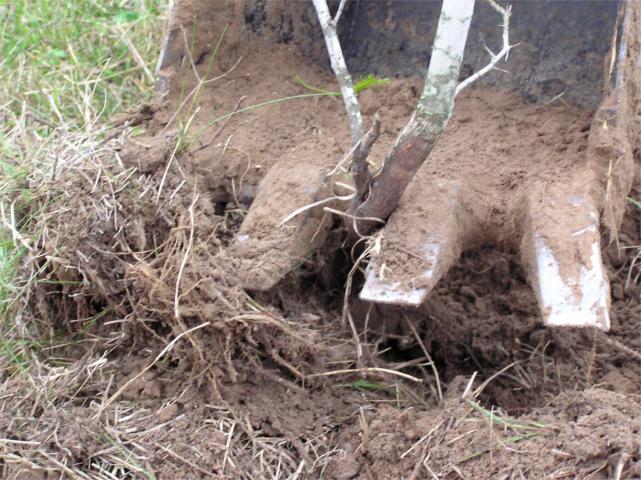

Here are a few more pics I shot while getting on and off the BH. I think it will work with the modifications.

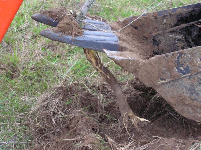

   / buck tooth bucket
Last pic. I needed to get lower the tap root broke off.
