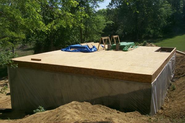

Roof over basement with stairwell opening or 1st flr deck boy those tji's are tough to nail thru, Actually used nailgun but those joist are hard

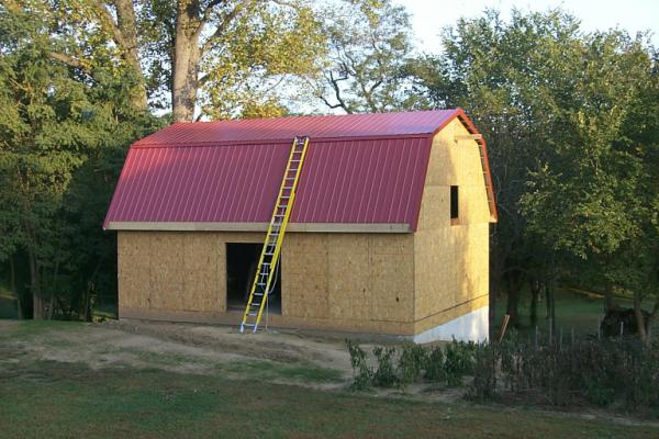

Metal roofing started all roofing ordered locally ,comes out of pa I believe and was cut to the inch! I had to cut nothing, only trim pieces around the returns near soffit

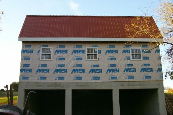

Only three more pics to bore u with, Rear wrapped and ready for siding windows in vinyl 36x36 I think $88 bucks ea.going to insulate so double pane is the way to go.

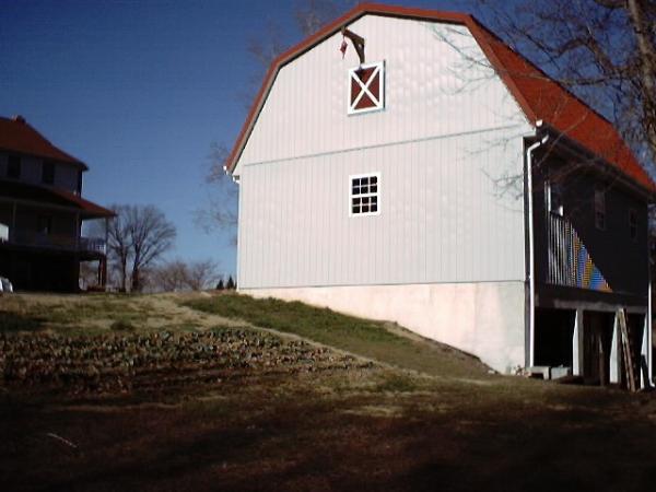

right side complete with nostalgia loft door & pulley beam for those special jobs (no hay for horses since we don't have any)

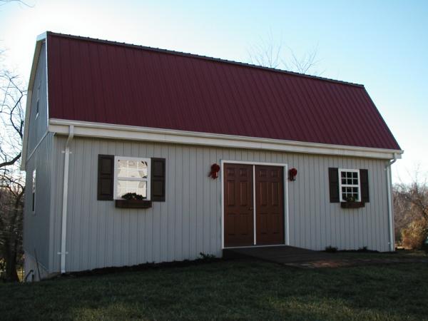

Front complete with window boxes, of course honey it will look cute!! heavy duty ramp for equipment in & out ,Brick sidewalk going around to rear steps at garage doors

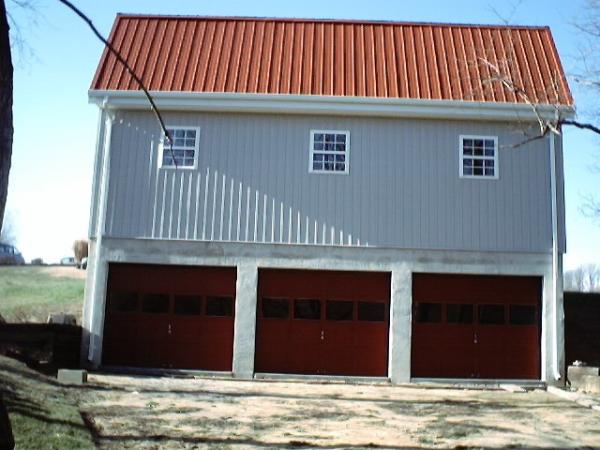

OH finished basement garage ,over and out!!
