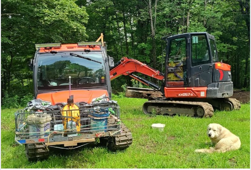

Looking for what people use to brushhog (brush mowers) trails -- I have about 9 miles of trails - all accessible by atvs, tractors, etc... but a lot of them are steep; I generally only use a tracked atv, tracked Kubota RTV, or excavator... There are places where wheeled vehicles are either going to get stuck or do damage to the trails. Thinking of a tow-behind brush mower - two popular brands are of course Swisher and DR.. I actually have (well my neighbor has it now) an old DR walk-behind brush mower and it is a beast and awesome but using it for all these trails is impractical and it won't make it all the way around (even with chains). It "appears" (based on reviews) that the DR tow-behind models have some problems with reliability and repair metrics. I also have a brush cutter on my mini but it is impractical for covering long distances as one can't cut while moving with it (flow metrics).. So looking for recommendations / experiences and sorry for the rambling.
Obligatory Kubota photo...
