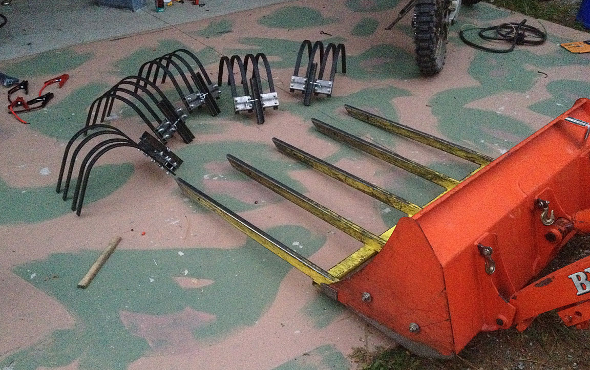

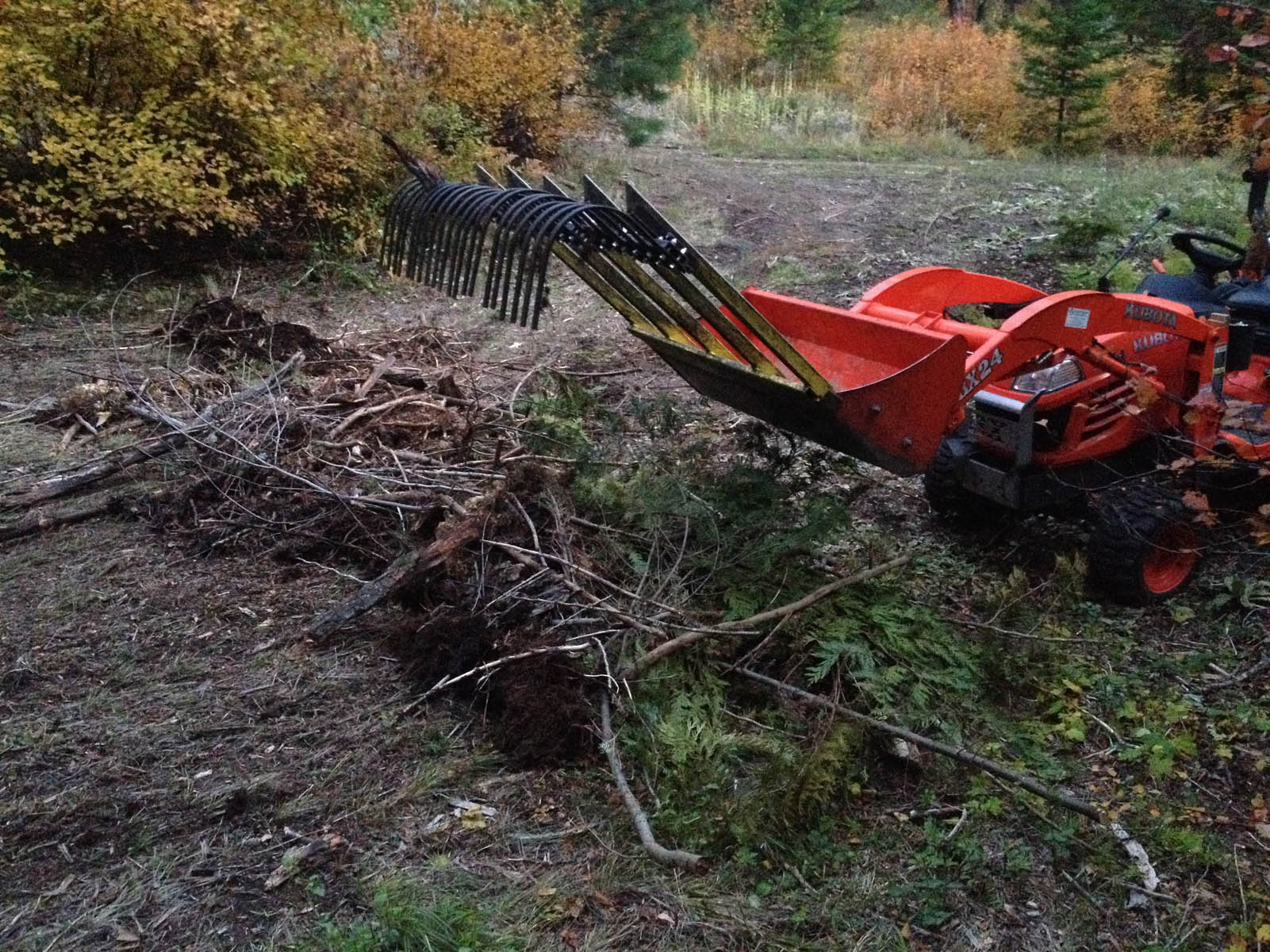

Brushfork w/5 mini Stick-Rakes (homebuilt attachment - BX24)
Combination landscape rake and brush forks; an attachment for an attachment.

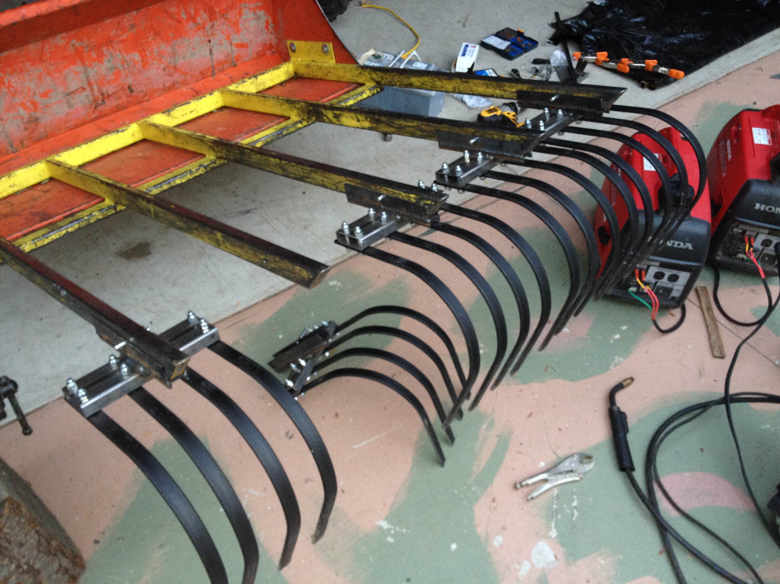

Homebuilt brush fork vastly increases the amount of brush that I can move to a burnpile with my BX. For now it bolts to the bucket sides with 4 bolts but someday I will make a quick-release for it. The brushfork tines are 4 feet long and are made of 2 x 1 x .120 rectangular steel.

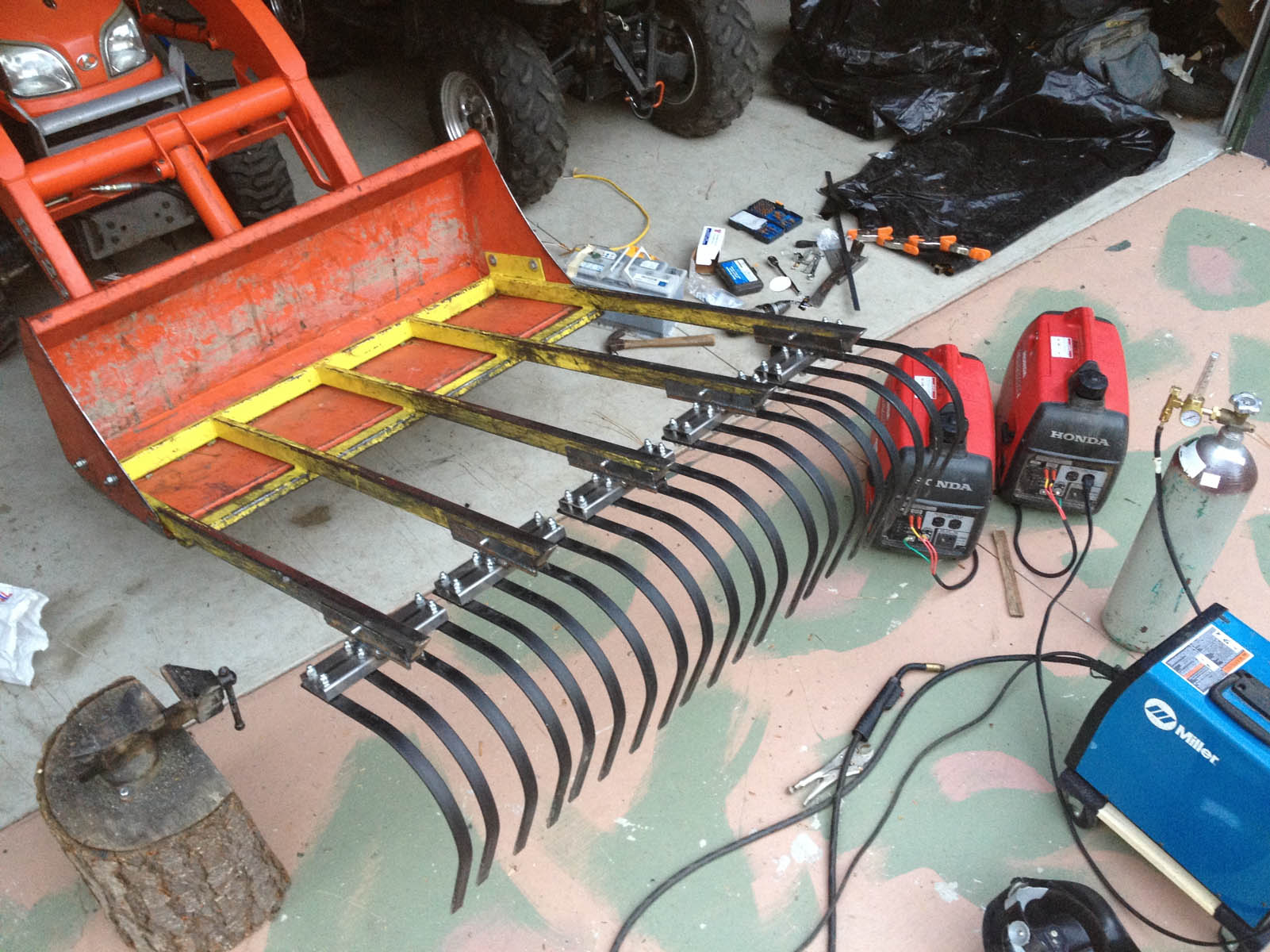

To clean up the ground better and gather more sticks I started looking into landscape rakes, but they all attach to the 3-point, so you do it with reverse. Facing forward and pull a pile backing out makes more sense in my woods. The tips of the brush fork extend far under a low canopy of a tree or bushes, so thats where I want to gather the sticks from. A 3-point rake can't reach very far under a tree (backing) due to the ROPS.
So I decided to build 5 little 4-tine rakes (quick-attach), one for each tine of the brush fork. It's very quick to remove them (one pin each). Or just remove 1 or 2 to narrow it up. After scraping up a pile you can remove the rakes and take the pile away. They are so far out on the fork that using the bucket float feature there's not a lot of pressure on the ground and they drag without tearing the grass up (not too much).
If I have to stick it between some narrow spaced trees or bushes a set or two can be removed.
Cost about $300 in materials for DIY. (20 tines: $230 delivered; Steel: $35; Bolts & pins: $24.) So about $60 per rake for DIY. Of course there was a LOT of 3/8" HOLES to drill on this project and lots of welding too. I did all the drilling and cutting at home. All the welding was done out in the woods with a pair of EU2000i generators.
I'm real happy with how it works, how far you can stick it under a bush, and out comes a BIG pile of sticks! Once the pile starts to get bigger (and not easy to back over it) I was surprised how well pushing the mini-piles into the main pile works (driving forward, pushing "backwards" on the tines).

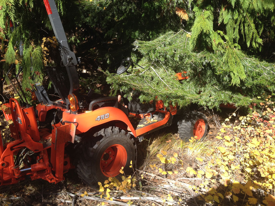

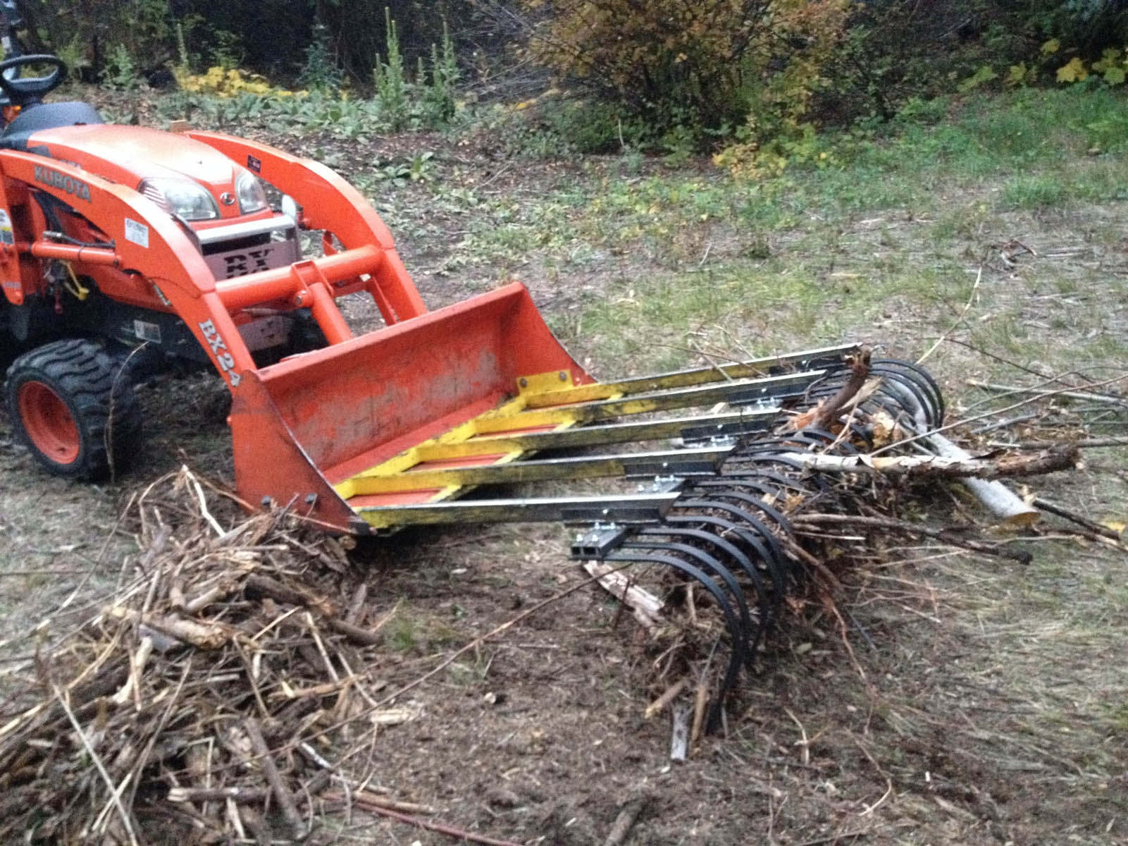

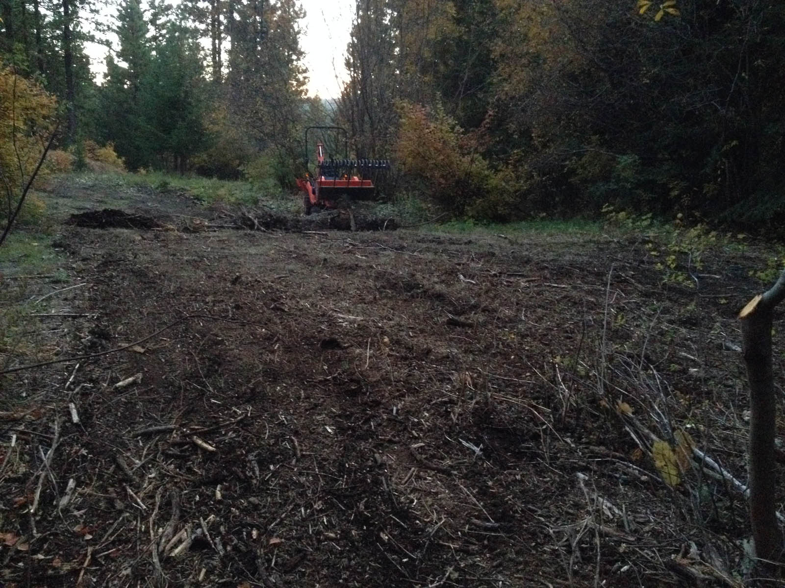

Been using the brushfork rake today, and I am very happy with how it works. It allows me to work around my trees and get so much more done in less time, and without disturbing the trees (much).
Can stuff it way back in the bushes and pull out a big pile of sticks!
5 small separate rakes are much easier carry around than a 3-point rake attachment. I can toss them in the bucket and head out into the woods.
So easy to feed a fire with a brushfork.

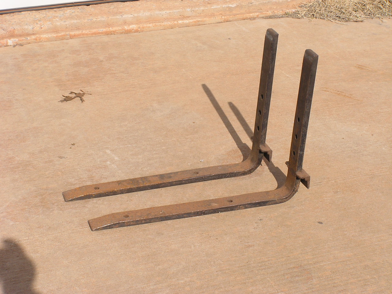

Bolted to the forks, pictures from 9-21-2005.
Does't work in float when pushing forward.
Works good in float turned around and using reverse, like yours.

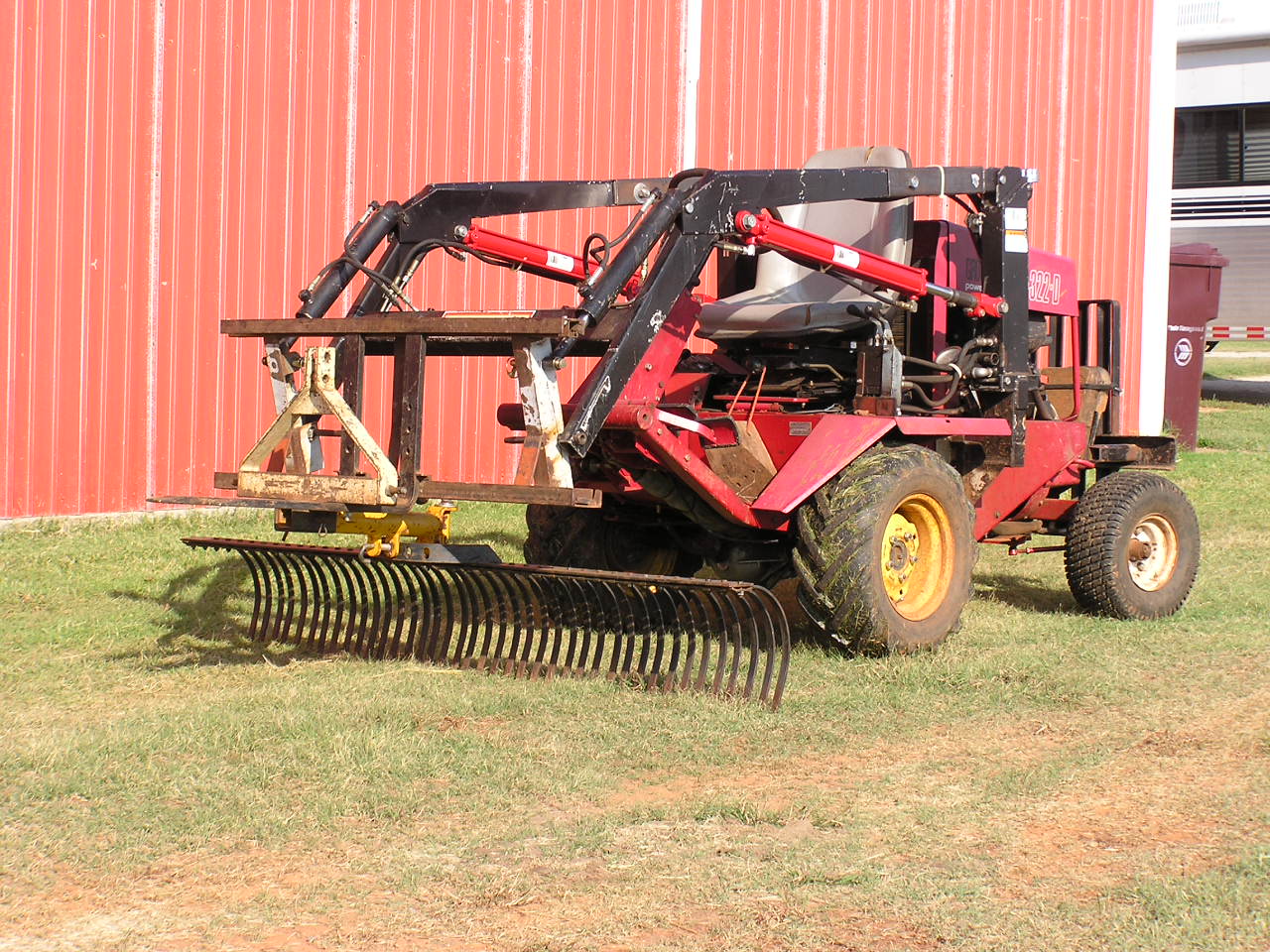

I saw a TBN thread called ratchet rake, it works similar in that it's FEL bucket-mounted and you can see what you are doing up front. I don't think the ratchetrake will gather sticks like this thing does, it has teeth on the bottom for breaking up the dirt. In my case I don't want to dig up the grass, just pull the sticks off and pile them up. And I need a farther reach under the trees.
I can see a lot of other uses for a ratchetrake (ratchetrake.com). A good low-cost and quick-attach item and maybe even more useful for a compact tractor that doesn't have much weight to break up the soil surface.

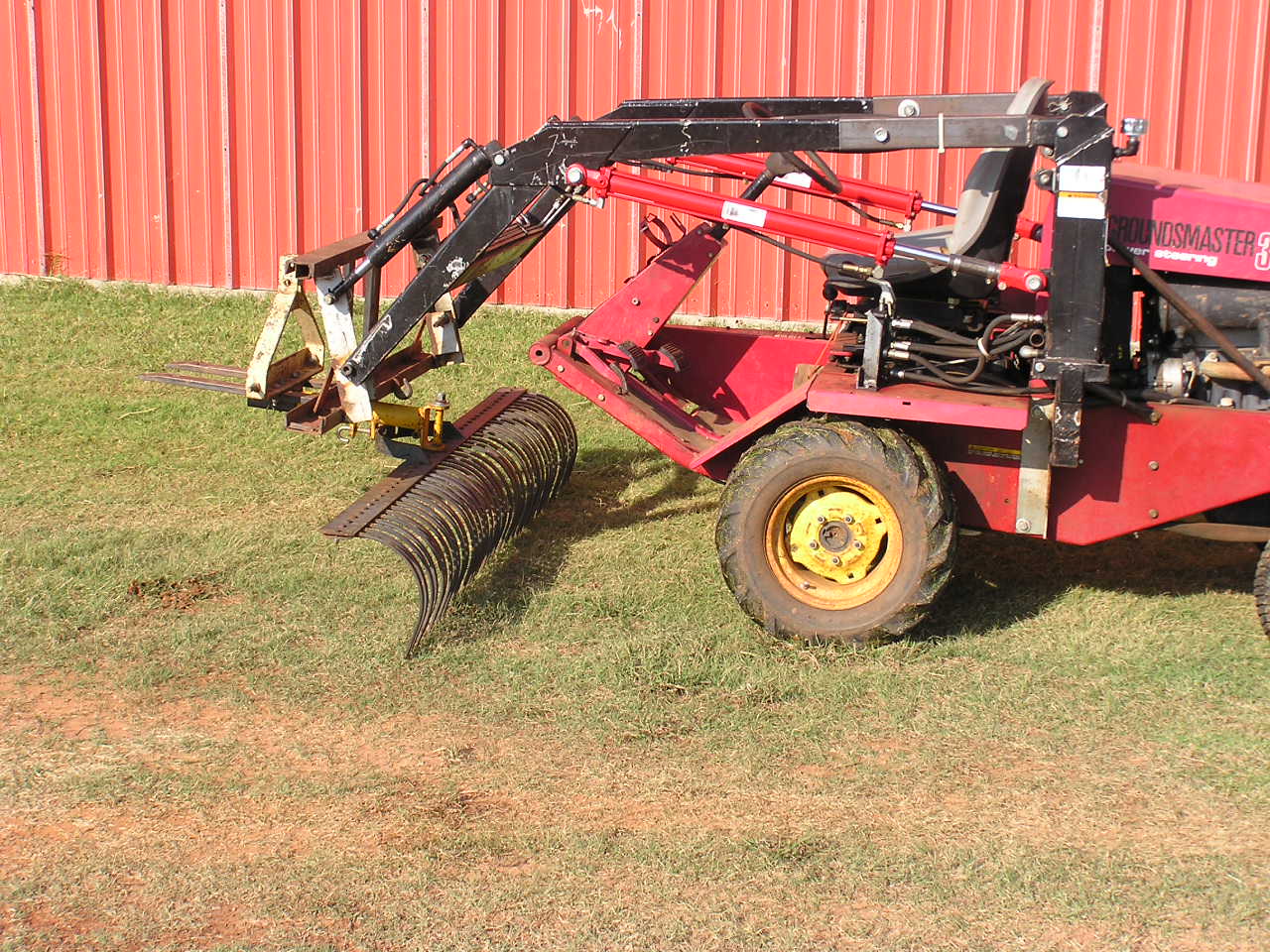

Here's DrDaves pic (yellow "ratchet rake" attachment) repeated. (and not a compact tractor!)
