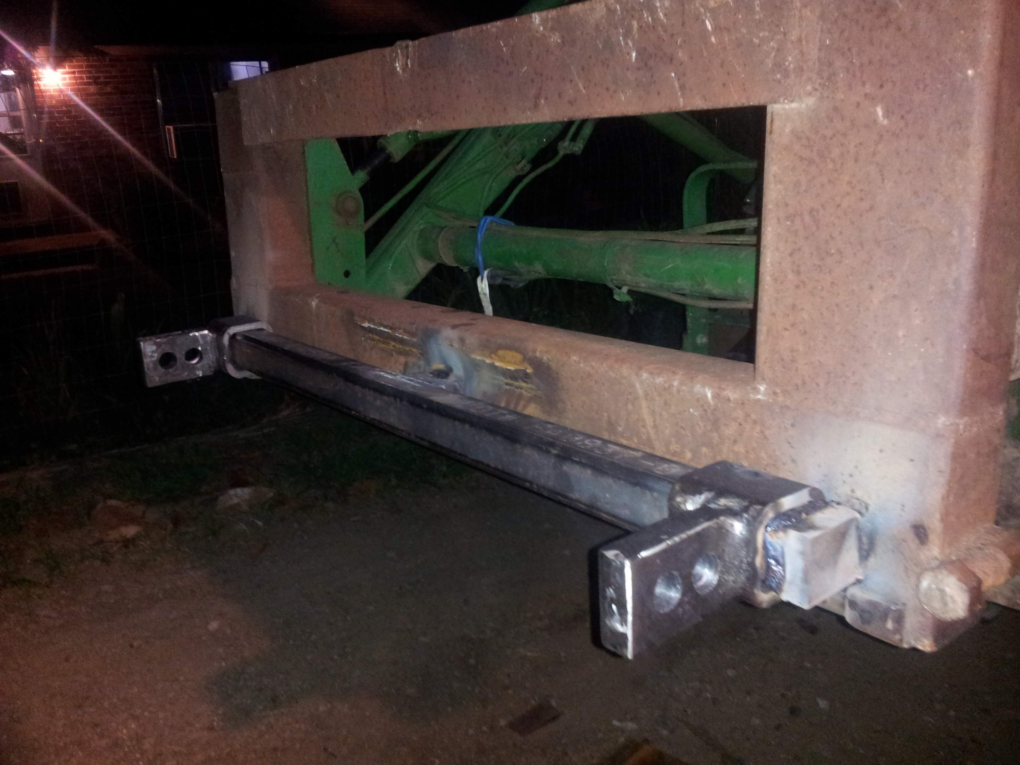

We're out here!! I've been working on a new mod for FEL the past few nights in the cool air. I only need a new king pin, bore 4 holes to match it, then weld 2 4" beads and it's done. I will be posting pics tomorrow. We have a rule here. We only build from scrap, nothing new ( raiding the junk yard again for a king pin I spotted last time and forgot to get) heck even the welding rod I use are half burnt down. PICS tomorrow!! I think everyone will approve. The design was motivated by a pic I saw on here!

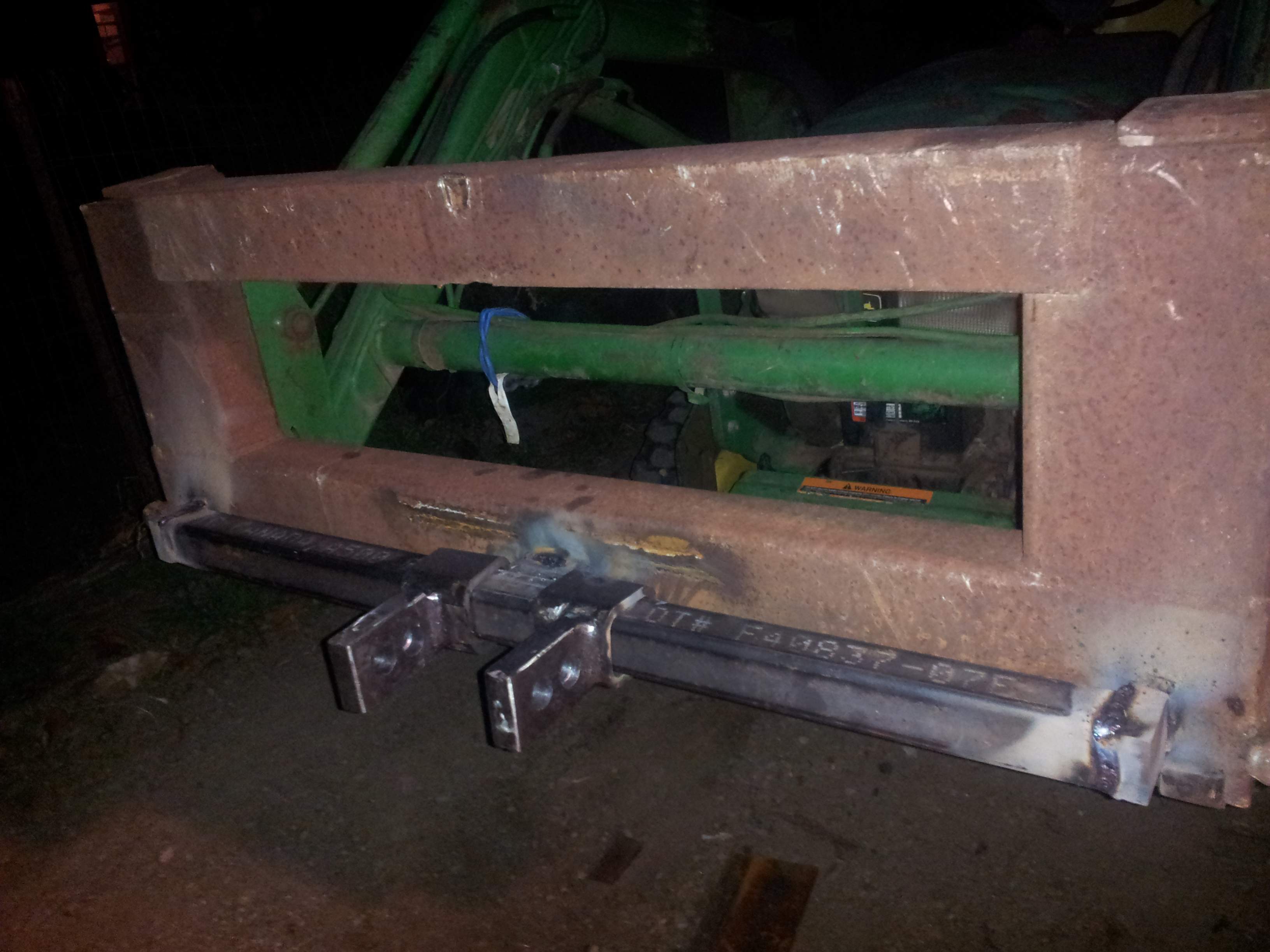

Oh what the heck..thought I would share two images : Goal was to have a tool platform that could handle anything that we had that went with the rear 3 pt each. Finishing it up tomorrow. 20140729_210234.jpg20140729_210245.jpgbut here is two images showing the lower half right after mounting it

Sodo, that is an excellent idea! I hadn't seen this thread before, I would have commented earlier. I think being able to back drag the rakes from way out front like that would really be convenient. Wish I had fabrication skills...

Oh what the heck..thought I would share two images : Goal was to have a tool platform that could handle anything that we had that went with the rear 3 pt hitch. Finishing it up tomorrow.
View attachment 384671 View attachment 384672

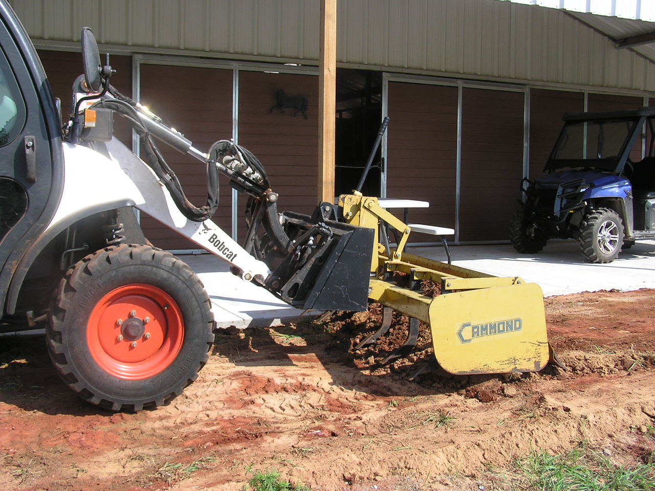

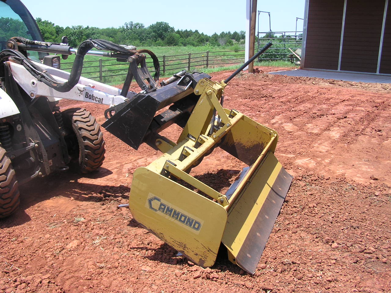

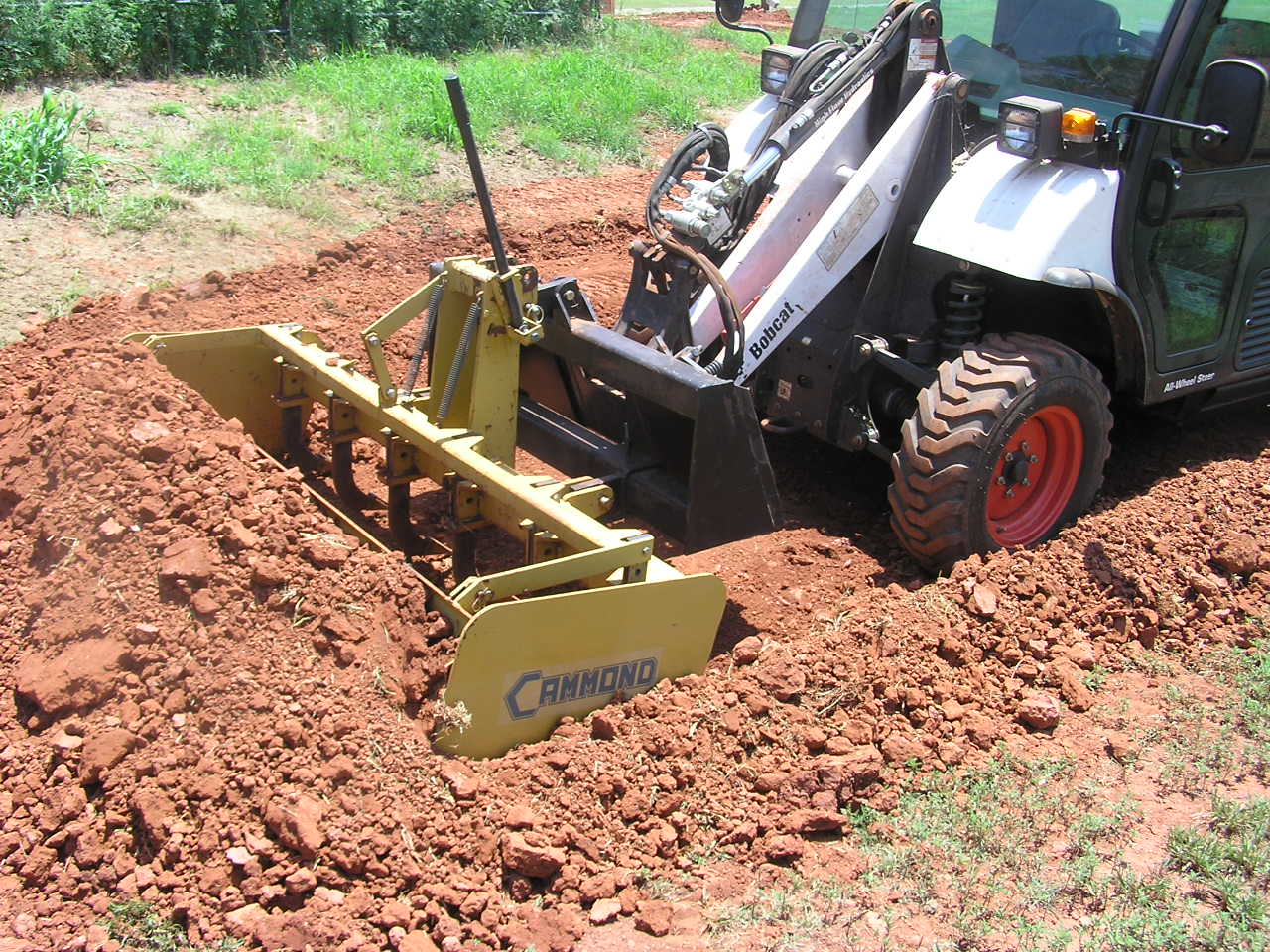

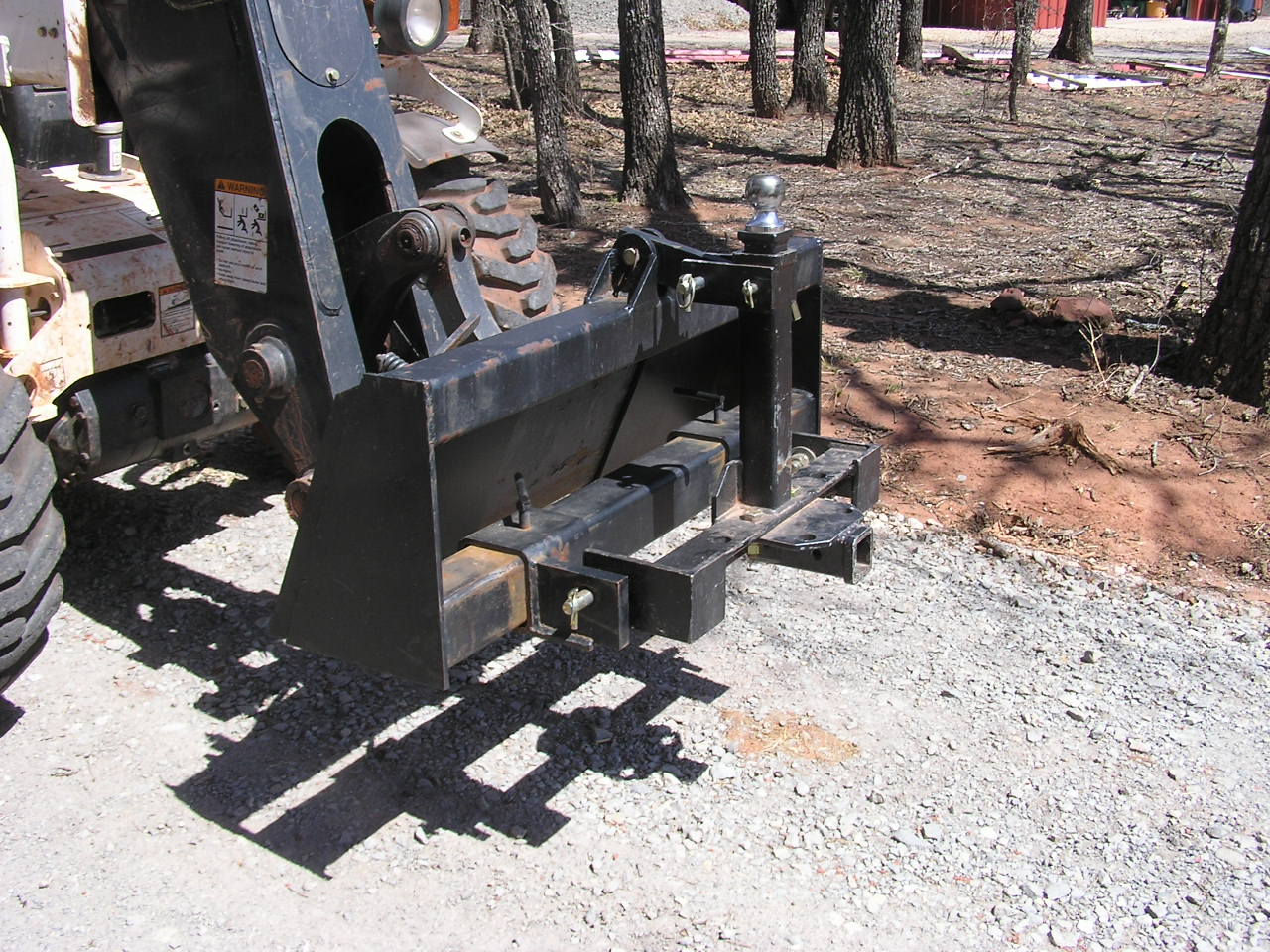

Yep, it is called a three point adapter. I had to buy mine, but I use it a lot.
It has some extra rollback built in.
With the box blade. :thumbsup:
